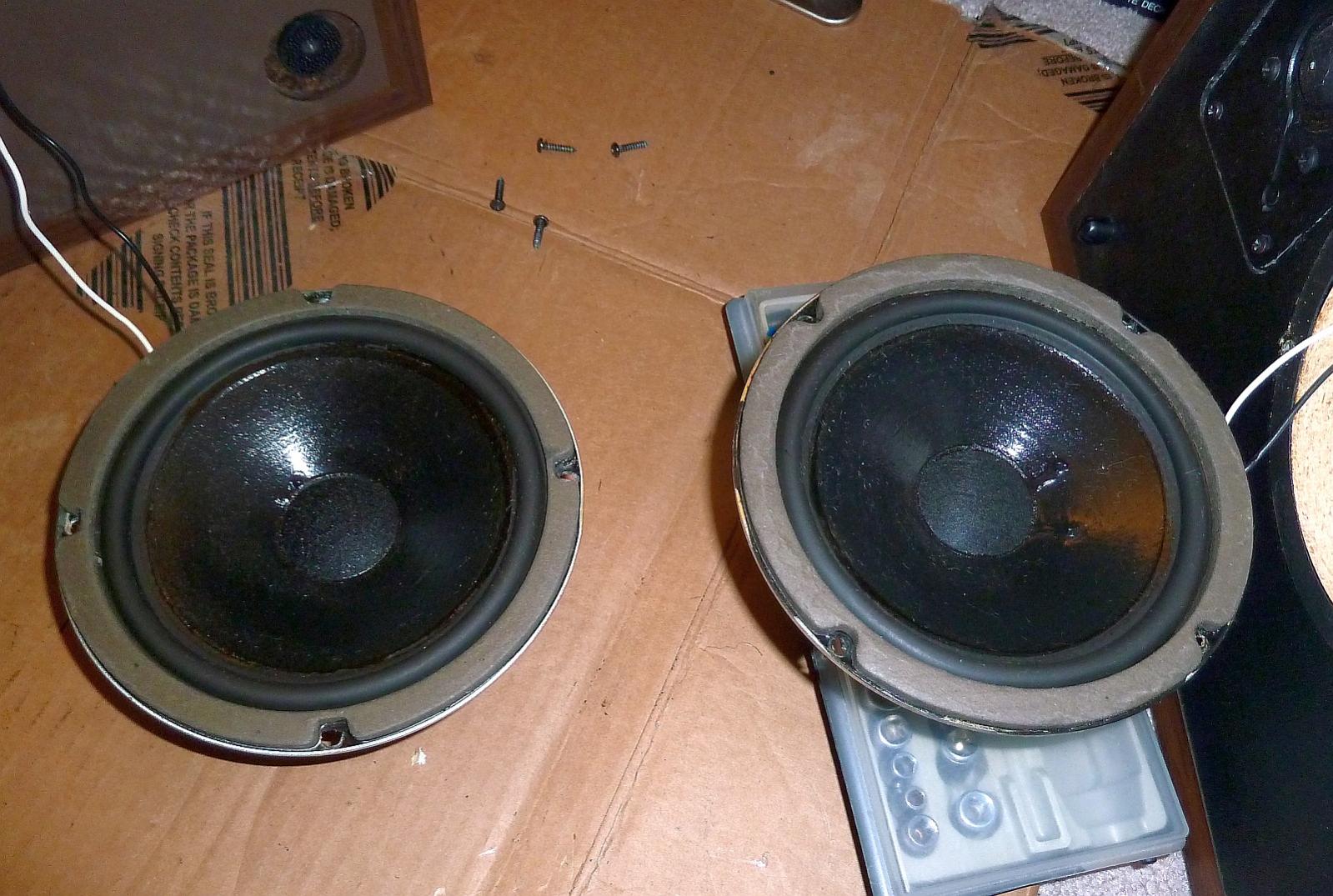

Is this original Polk Monitor 7A driver?
Mystery
Posts: 2,546
All other drivers I checked in other models have/had black metal basket but these have silver/brushed aluminum basket.
Terminals are soldered so either they came like that from factory or someone replaced woofers.
From their looks, they look like never been opened though.
Thanks

most early models had silver baskets and soldered terminals. Weather THAT is original driver who knows but it shares that look.
I see.
So MW6502 came in silver as well as black basket.

mhardy6647 wrote: »Looks like it - Here's what the front should look like :-)
Yes with those thick gray paper gasket around the drivers that don't exist on later models.
Here is the pair I'm working on right now...
That woofer is from the right speaker.
I'll open the other one and check if it's same woofer even though they have different cabinets.
Opened the other one and applied epoxy on both drivers.
However, I see that there was already epoxy bead all around the magnet both upside and downside so someone must have gone through it before.

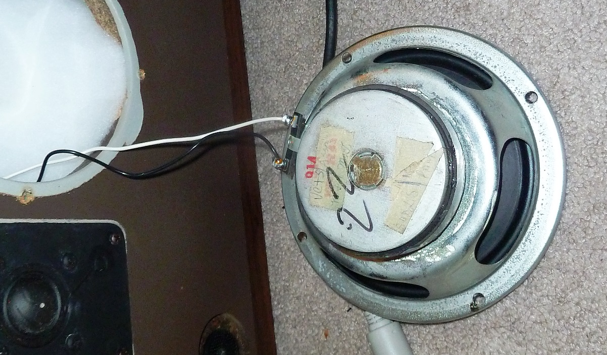

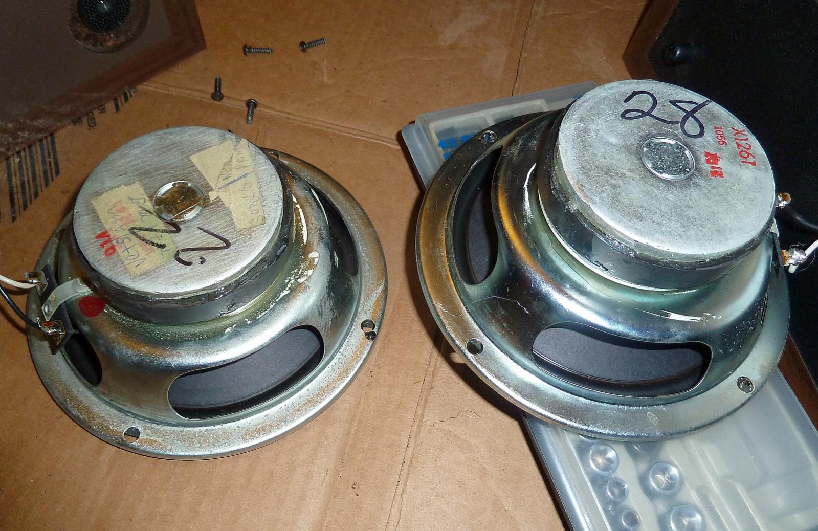

Drivers facing up:
Drivers facing down:
Both drivers are similar. One has number 22 and another 28.
The later one is newer or looks newer as it's more shiny.

Interesting... EIA code 1056.
The classical assignee of EIA code 1056 was Fisher (or, more accurately, I guess, a subsidiary called "United Speaker Systems", http://www.worthpoint.com/worthopedia/vintage-pair-rola-12-alnico-magnet-220174533 ), but there's anecdotal evidence that the 1056 manufacturer's code was re-assigned to... someone... Gepco? I cannot find a definitive link. -
westmassguy wrote: »The crossovers look all original
One of them was really muddy before and now both are open and specially strings/flute type instruments sound really good.mhardy6647 wrote: »Interesting... EIA code 1056.
Are you suggesting that these may not be original Polk drivers?
Those appear to be originals, from what I can see. The Early Polks had unpainted basket frames, and most didn't have labels like the later models.Home Theater/2 Channel:

Nope, not at all - The 1056 is the code of the OEM whose drivers Polk used. Most speaker system manufacturers do not make their own drivers; they use OEM drivers (but often made to their own specifications). -
