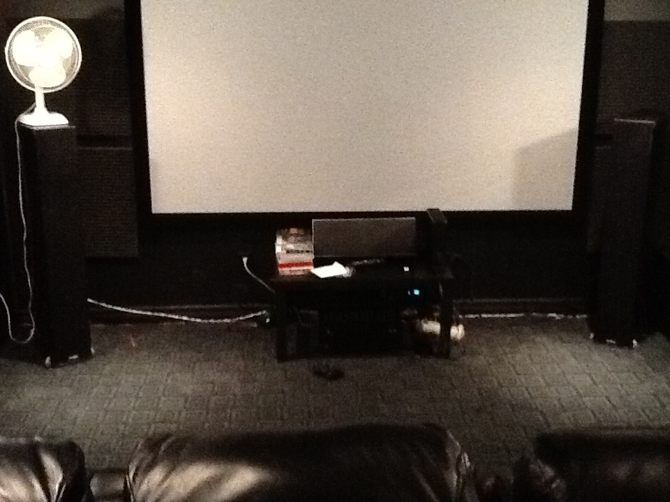

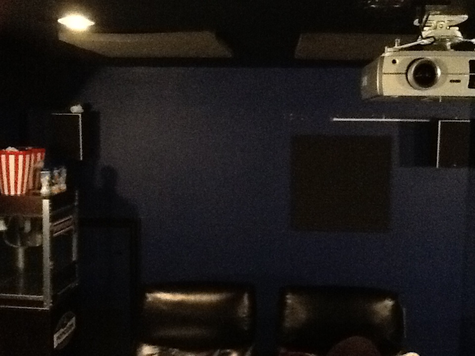

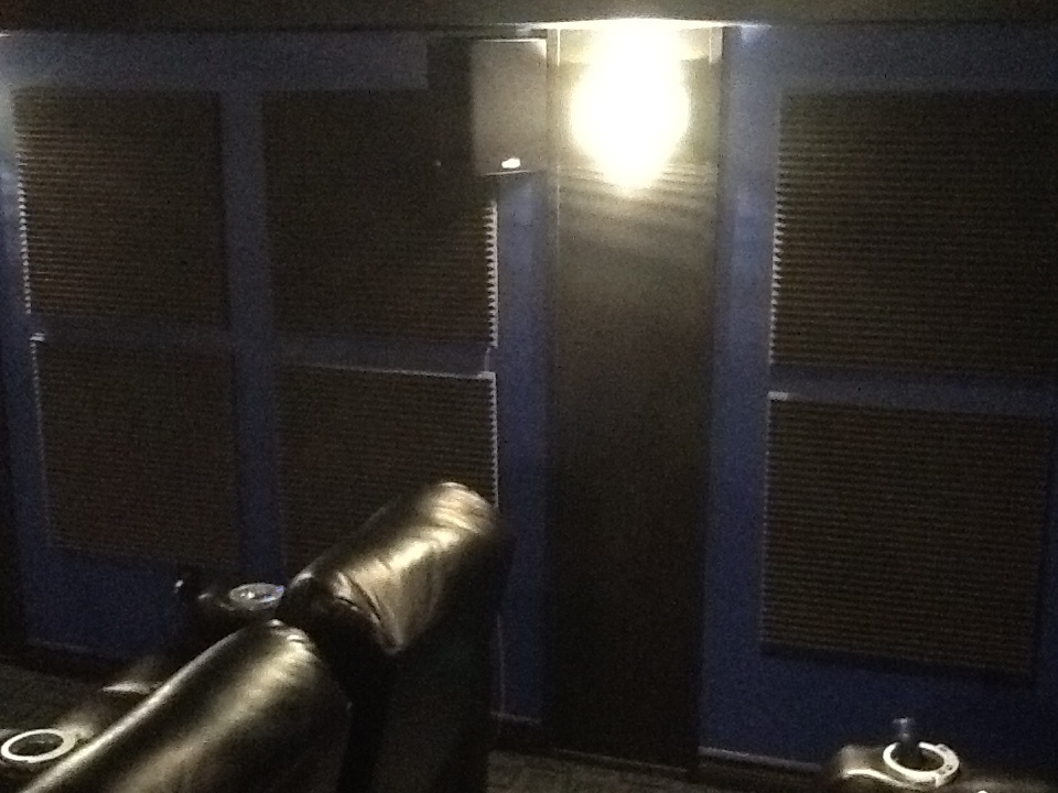

I'm currently using a Polk 7.1 setup in my theatre which is configured as follows.....
Fronts - Rti A9
Center - Csi A4
Surround - Fxi A4 (dipole mode)
Rear Surround - Monitor 30
I have not been impressed at all with the surround in the room, and I'm thinking it might be due to not having the right speakers in ideal locations. Should the rears be the Fxi and the surrounds be the Monitors? Should I have the Fxi speakers set to bipole rather than dipole?
Any feedback I can get would be greatly appreciated, thanks!

    With your room i'd swap the rear speakers. Put the FXi speakers in the rear like 2-3 feet from the sides about 2 feet above ear level set on Bipole and the others where the others were as that looks like the ideal spot 2 feet above head level and to the side of the sweet spot just shooting there sound above you with those switched to bipole Or just get another set of Fxis for the rear.. of course try out the swap first.
