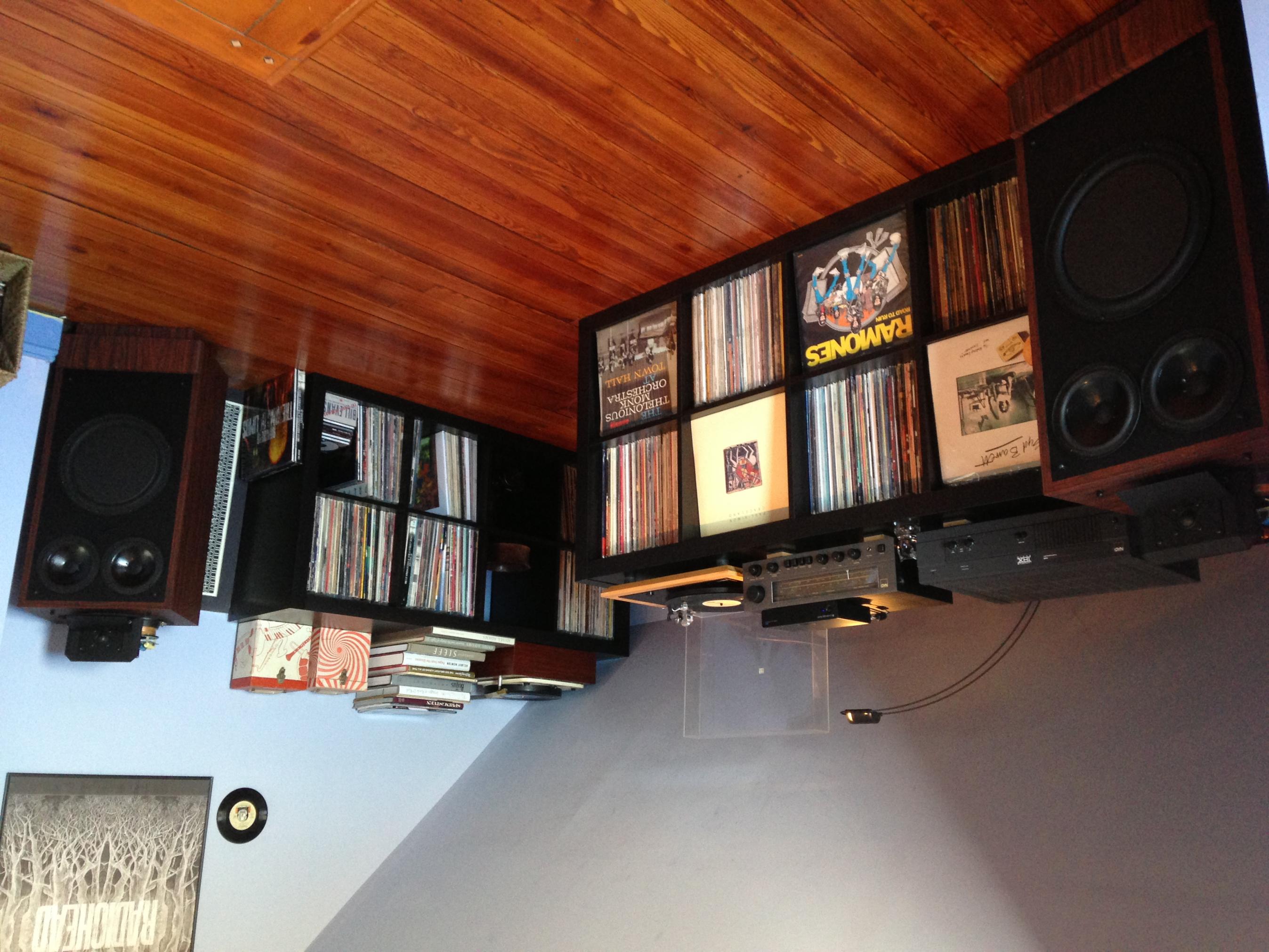

    So I bought the NAD 7020 integrated amp and am currently using it as a preamp in conjunction with the NAD 2400THX power amp. There is more than enough power to drive my Polk Audio RTA 12C speakers! Very rarely do have the volume knob up past 1/4. Any higher and the neighbors might have the cops at my front door. I'm very happy with the quality of the sound. Thanks again to everyone in this forum!
  • 1ShotBill
    1ShotBill Posts: 30
    edited April 2013
    Not sure why my photo was inverted while uploading from my iPhone. Lets try that again...
