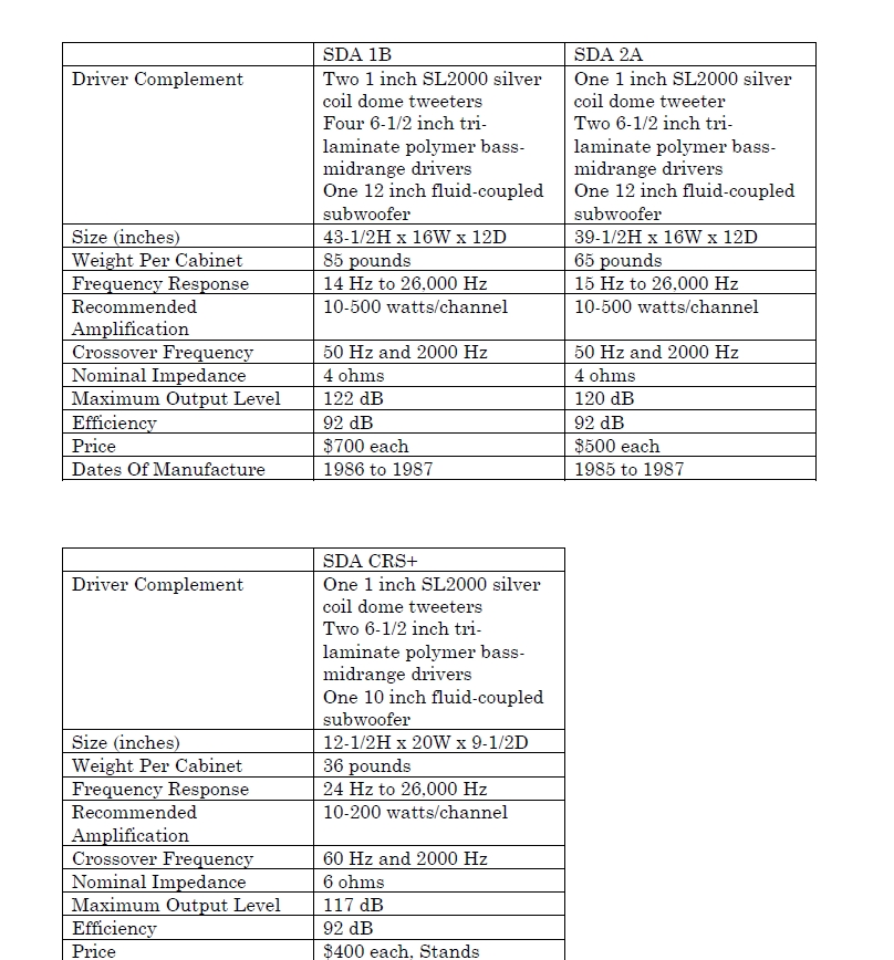

    heiney9 wrote: »
    There are 2A's that have side by side tweeters.
    I can find no evidence of this. My downloaded copy of The Handbook specifically states that 2As have a single tweeter, confirmed by the list of drivers which shows only one tweeter.
    Can you list your source for 2As with side-by-side tweeters? If not, I think we can put this to bed.
    heiney9 Posts: 25,406
    edited March 2013
    My list of drivers clearly states 2 - sl2000 tweets for the 2A. The sentence on page 7 is a bit confusing. After reading the paragraph over a couple times it does seem to indicate a single tweeter. My copy must have a typo when it lists the drivers for the 2A's, which was subsequently corrected in the dl version.
    So yes, lets' put this to bed because who cares, if he has a single tweeter, then he has a single tweeter. I do know of 2A's which were early runs having 2 tweeters, perhaps they were mis-identified. We ALL know Polk and transitional models can be hard to classify. That's the best evidence you're going to get, unless it comes from Communist China.
    edited March 2013
    Here is a photo of the 3rd generation driver list from the Final SDA Compendium.

    heiney9 wrote: »
    The third paragraph of you post is incorrect as to how the SDA works in multiple driver SDA's. You can search for the proper explanation as I and others have posted about it before.
    Can you please point me to where I can find this information you mention here? I have never been too good with the search function here. If you can just direct me to links of some of the information. I have always been under the understanding that the sda works the same in all vintage sda models regardless of # of dimensional drivers, and my studies of the schematics have verified this idea. If this is incorrect I would like to understand how and why and learn more about the subject that I may not already understand.
    So far my understanding is that the dimensional drivers play a signal that is equal to the Left minus Right (or r-l) signal. Essentially only those portions of the signal that is different between the left and right channels. I have understood this principal to be the same in all models with the only differences being the # of drivers (of which all play the same signal in the dimensional circuit) and the wiring of this circuit in TL-able models vs earlier versions. As mentioned earlier, I do understand the progressive point source design in the multi tweeter models, but this is not associated with the dimensional circuits. I would like to learn more about this if I have been incorrect in my understanding.
    Thanks again.

    heiney9 wrote: »
    And here's a photo of the 3rd generation from my downloaded handbook. It appears we're both right Heiney9

    heiney9 wrote: »
    I have never seen that information until now. All 2A's i have seen or heard of were the single tweeter variety. i would love to see one of the compendiums some time. The different 2A models are not listed in the transitional list in the stickey. But I have also seen other oddballs pop up that had no other background info to describe them either. There were a lot of prototypes and transnationals back then. Though I have never heard any of the models with dimensional tweets I don't believe I would enjoy them. Similar to previously mentioned reasons along with the terrible lobing that must accompany those as well. My ears don't even tend to like the Monitor 10's and such with the side by side mids running the same signal.
