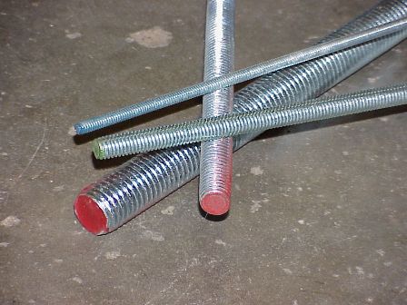

You could just grind points on four lengths of "all thread" threaded rod. The steel rod might fare better than brass against the hard concrete surface while still offering the desired coupling effect. Whole lot less $$$$ too.
