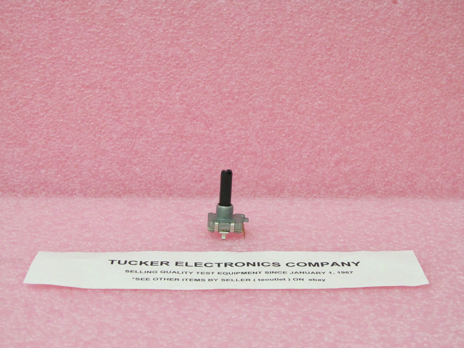

Turns out
it isn't one of these...
It was one of these...
Too much **** to list.... -
No pot at all in fact. It is called a rotary encoder for those, like myself, that did not know before. I am assuming not many do or there would be more than 9 hits on "rotary encoder" in the search. Either way...good info. I guess i never tried to turn it all the way up, or down, and thus was unaware that it has no stopping point. Now where did it put those static slippers and ankle strap?
One a lighter note...the wife did say, "Well, You did buy it used. Probably time to start looking for a replacement"!
She did this with the washer and dryer about 2 months ago...a 5 dollar bushing took a **** and bought a new set before I could fix it (read- brought a new set home that night). I fixed the washer for $7.89 and about 15 minutes of my time then sold them to a college student in need of a used set. They were only 3 years old for crying out loud! Ah well, she wants nice things too so I don't say much when she does go shopping. I bet she will have something to say about the next pre and it's dent in ye ol' pile 'o gold than her washer and dryer did muahah!Too much **** to list.... -
Thats what I have in my pre. One very identical to what you posted.
Did you just buy a replacement? Any idea as to what the goop is used inside these? Mine was not smoothly going up or down. However I cleaned mine and left NO residue of whatever gunk was in there.
Rotary Encoder... interesting. -
I am not sure the lube is for anything beyond the shaft lol. the contacts were dry and I assume they need to stay that way based on the closeness of the fingers on the pickup. Any dielectric grease at all could bridge those contacts. If that's bad? I don't know. To be forthcoming here...I am about to sell the oppo and 425 and buy the sc68 and the elite Bdp. But haven't talked the wife into the hiatus of the main rig till they sold.Too much **** to list....
