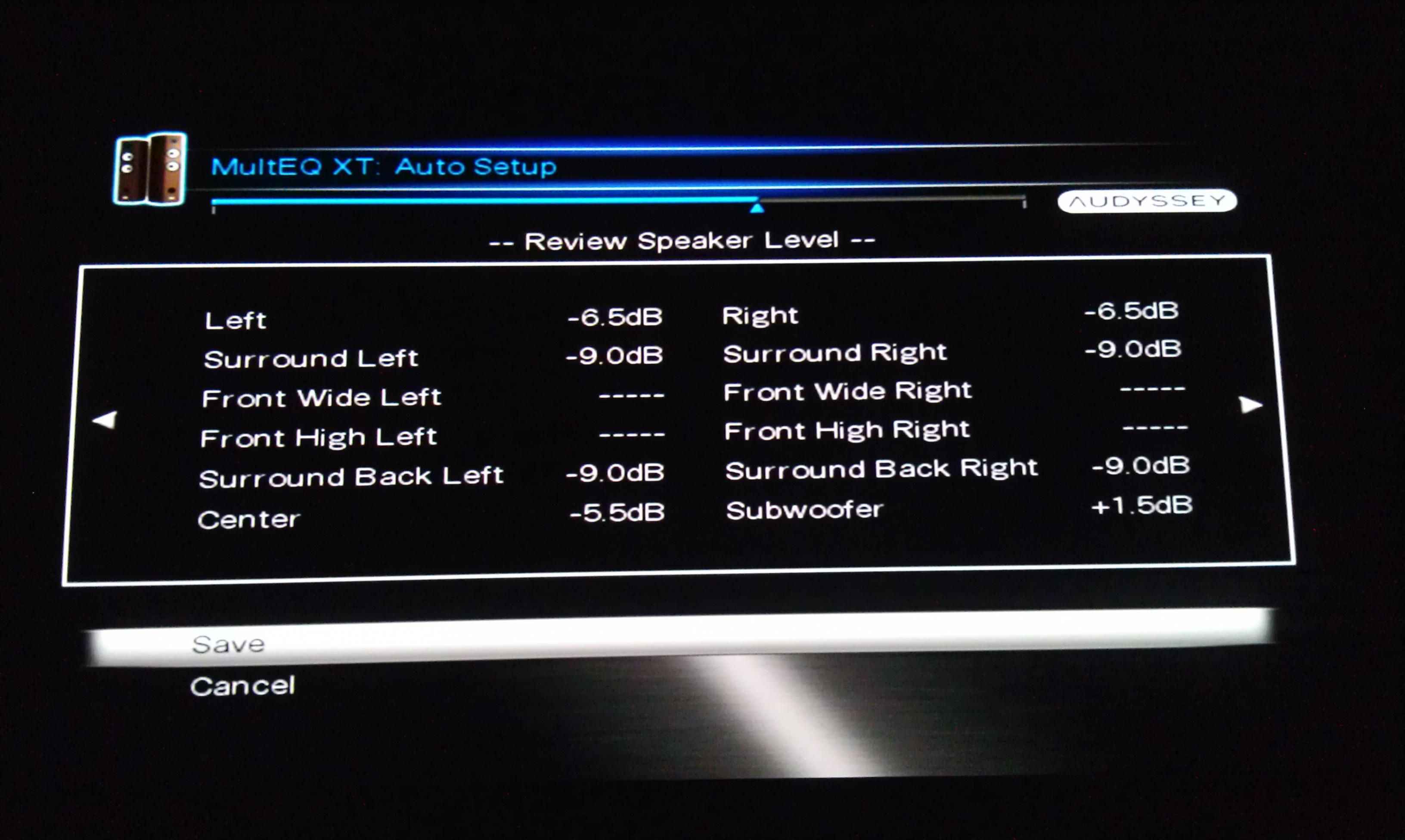

    If you just ran audyssey and left it alone it probably set the towers to 40hz. Wich would cause little out put from the sub. Bump the setting up to 70-80hz and see what you think.

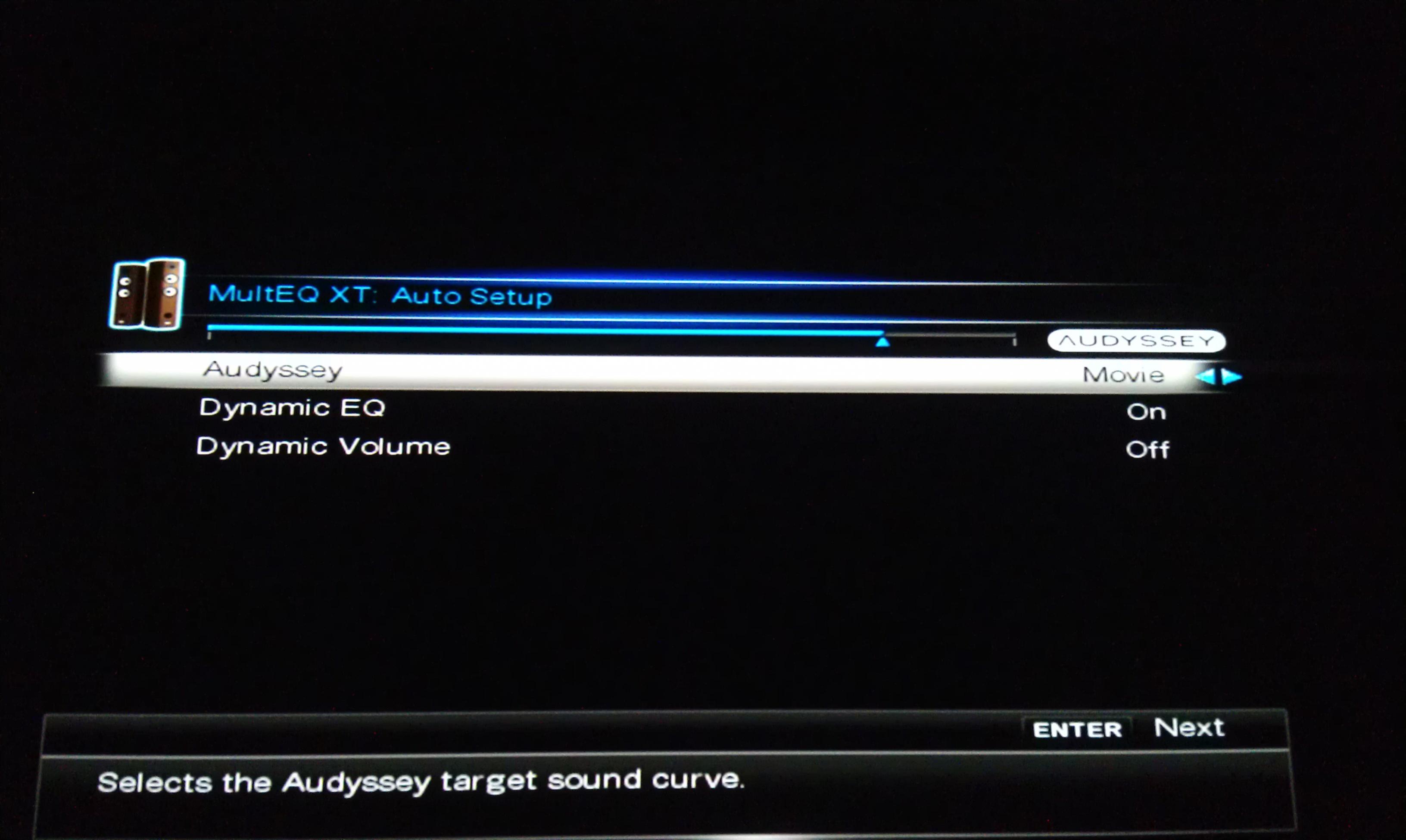

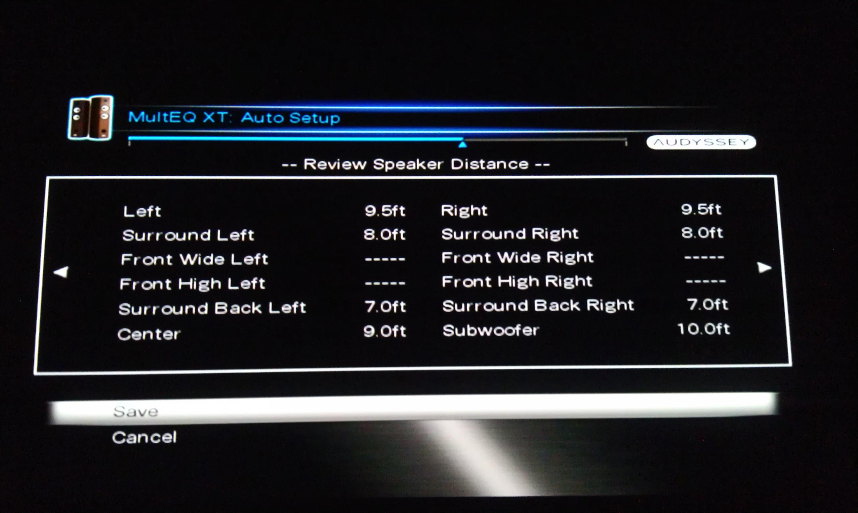

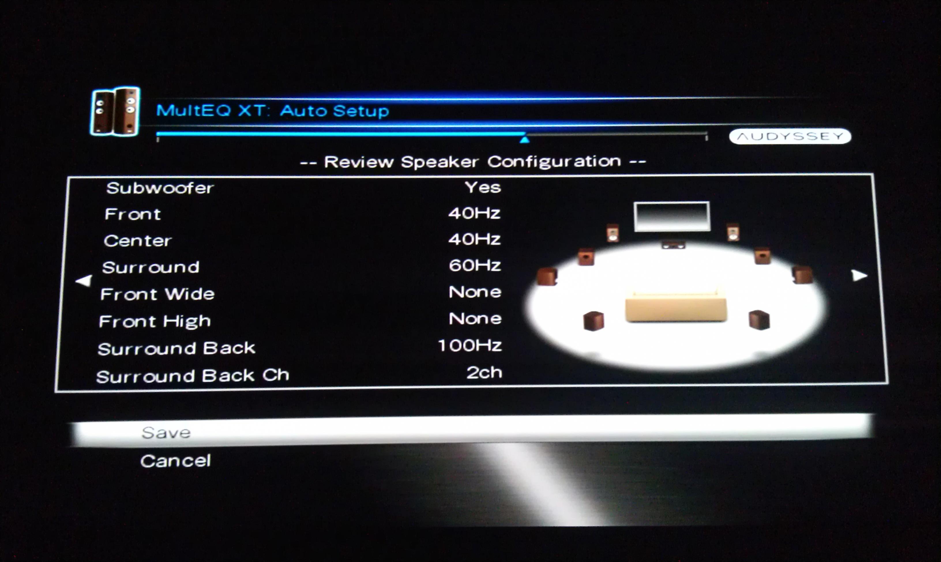

  • Posts: 22
    edited January 2013
    Thanks again to everyone for their help. I re-ran Audyssey tonight and here are the results of my Audyssey setup.

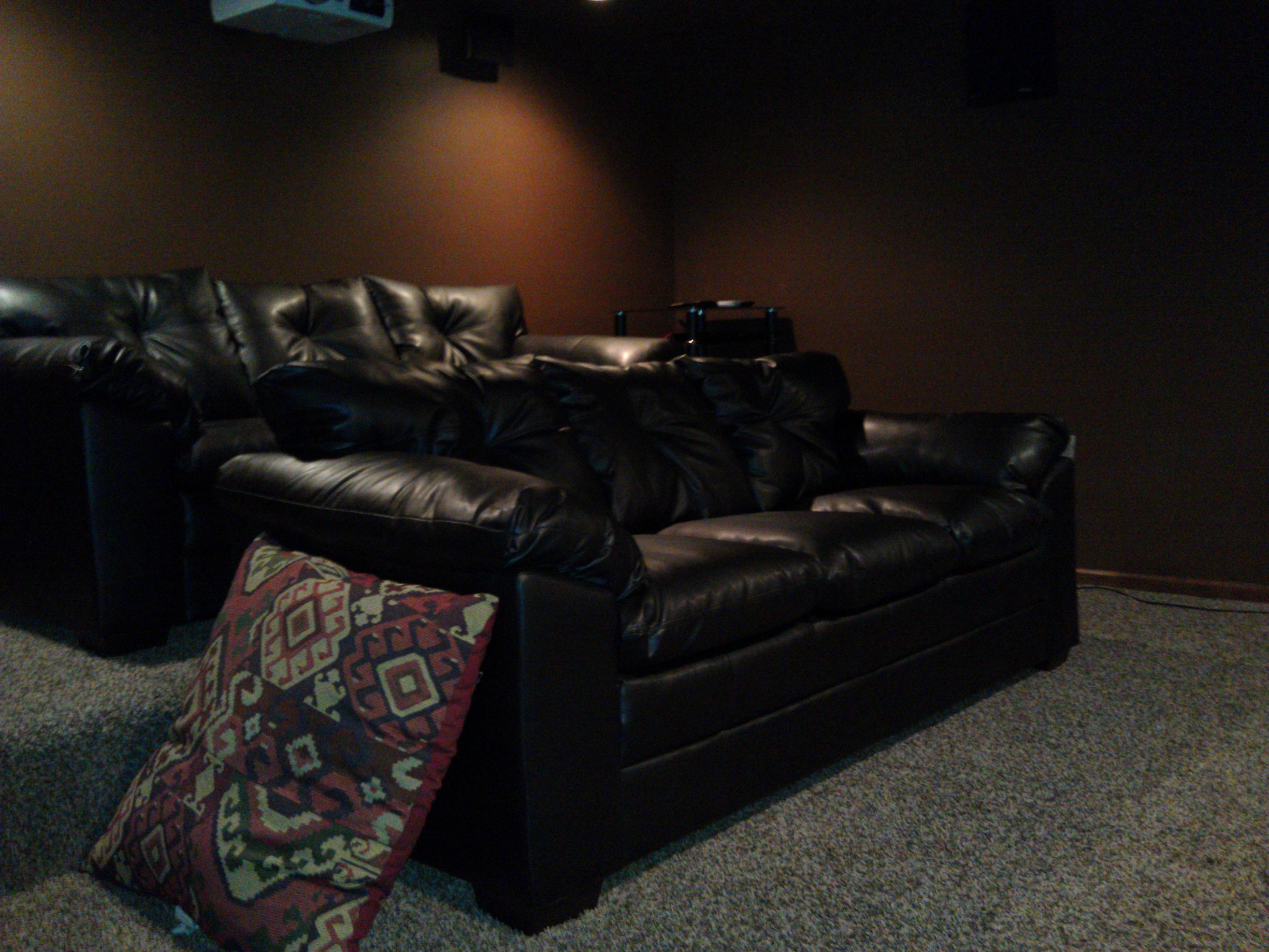

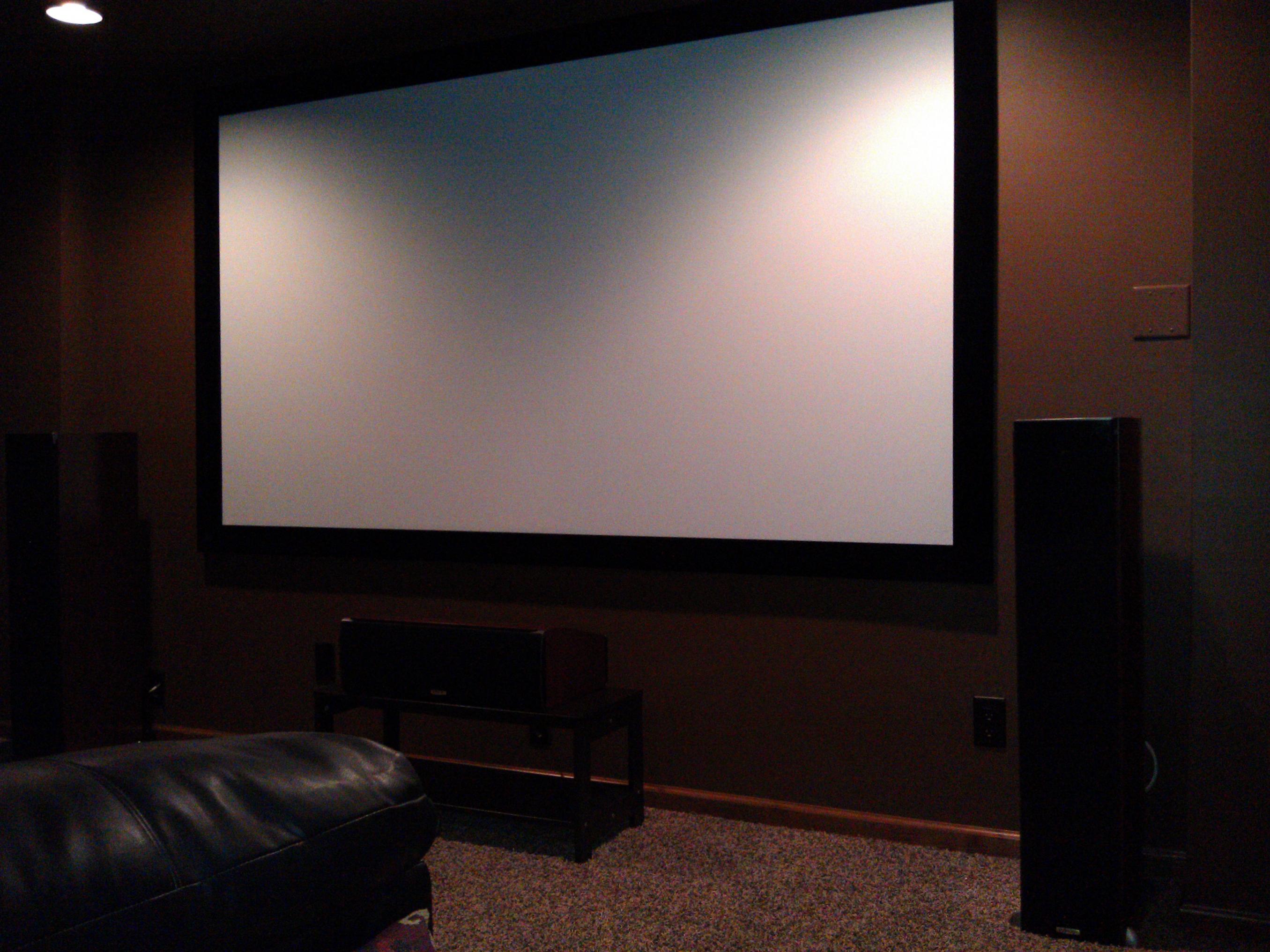

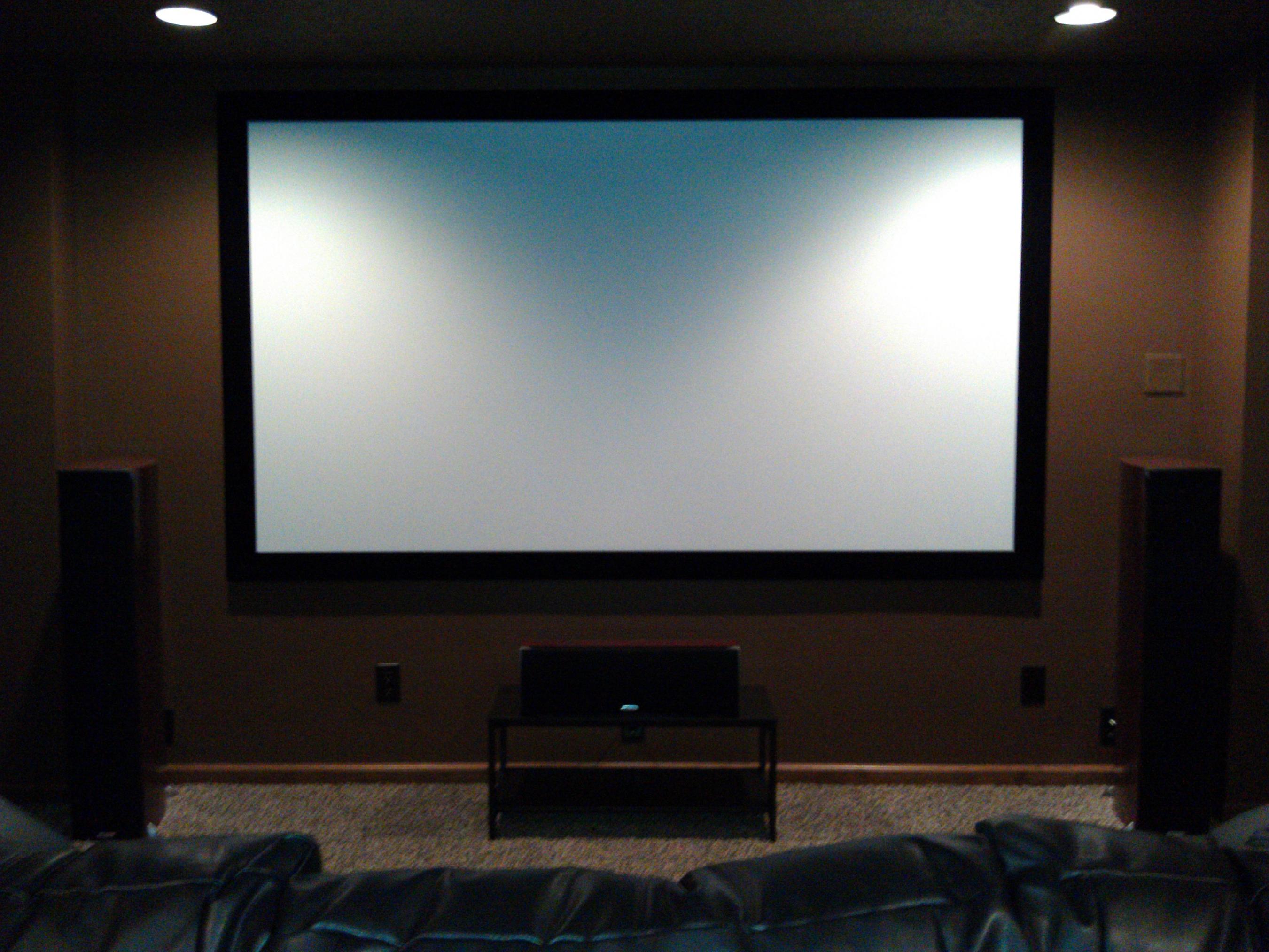

  • Posts: 22
    edited January 2013
    tommyt21 wrote: »
    I agree could be bad settings and bad room acoustics. what are the surfaces of your room like. I have found room treatments to help sound tremendously i have more panels coming today as i type...

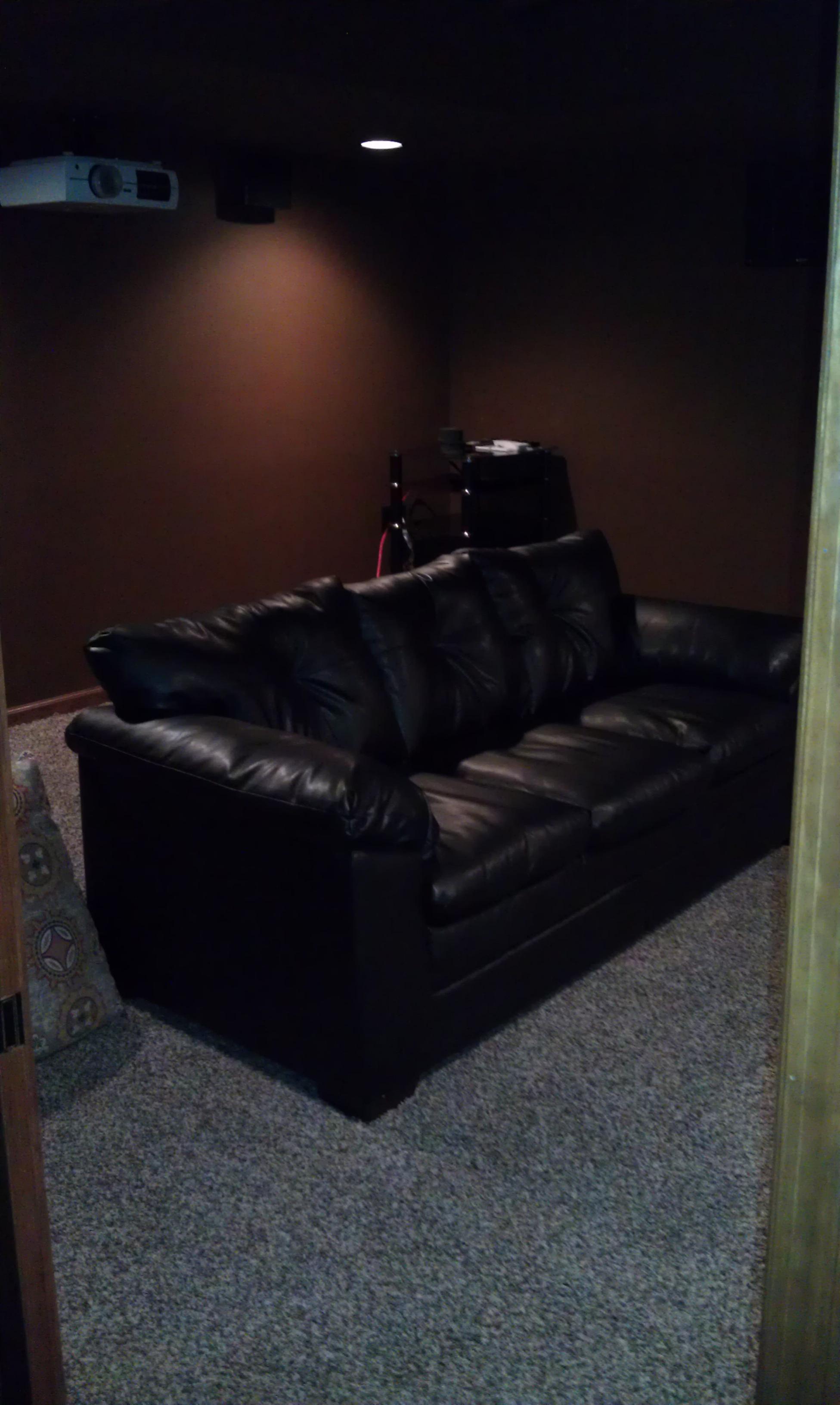

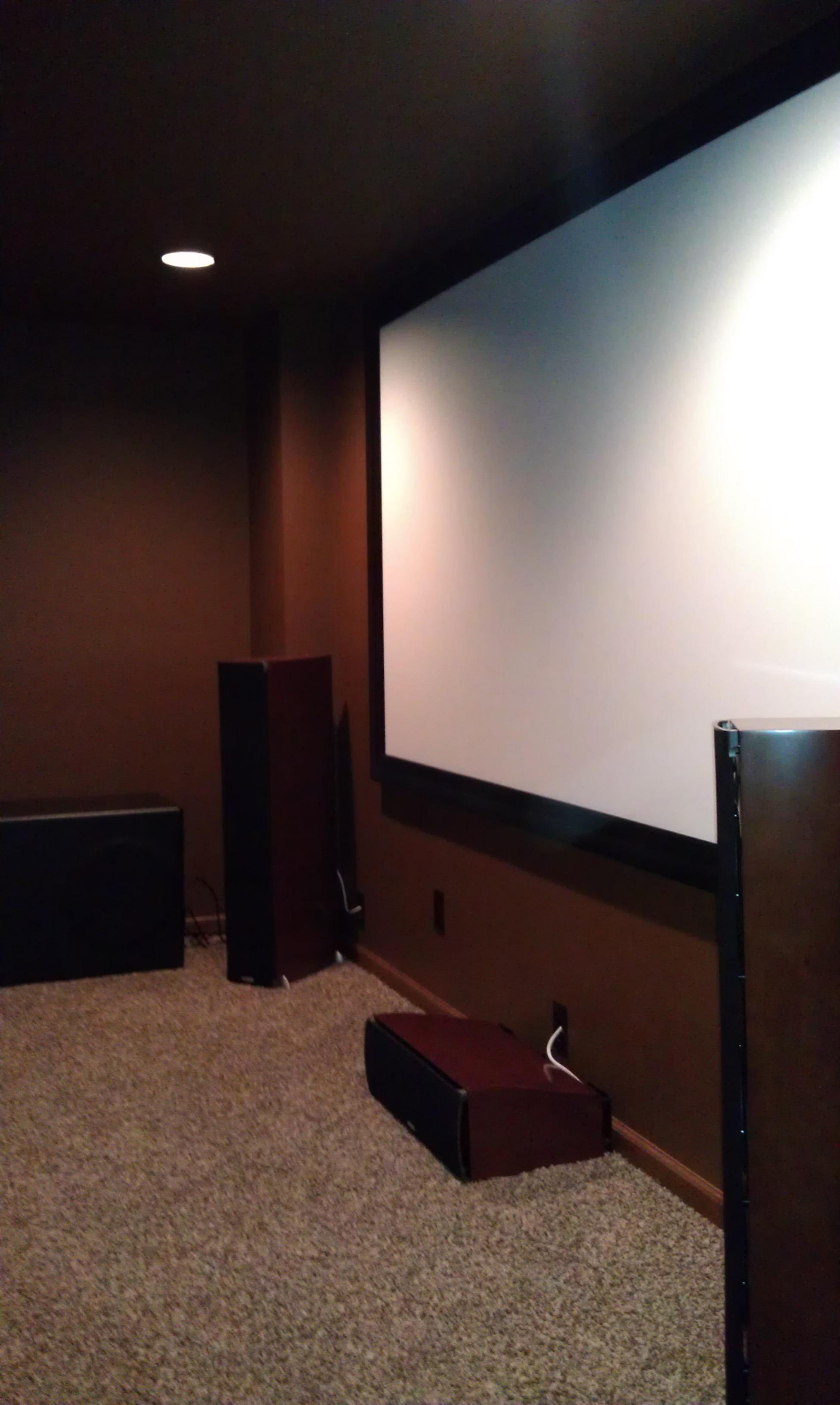

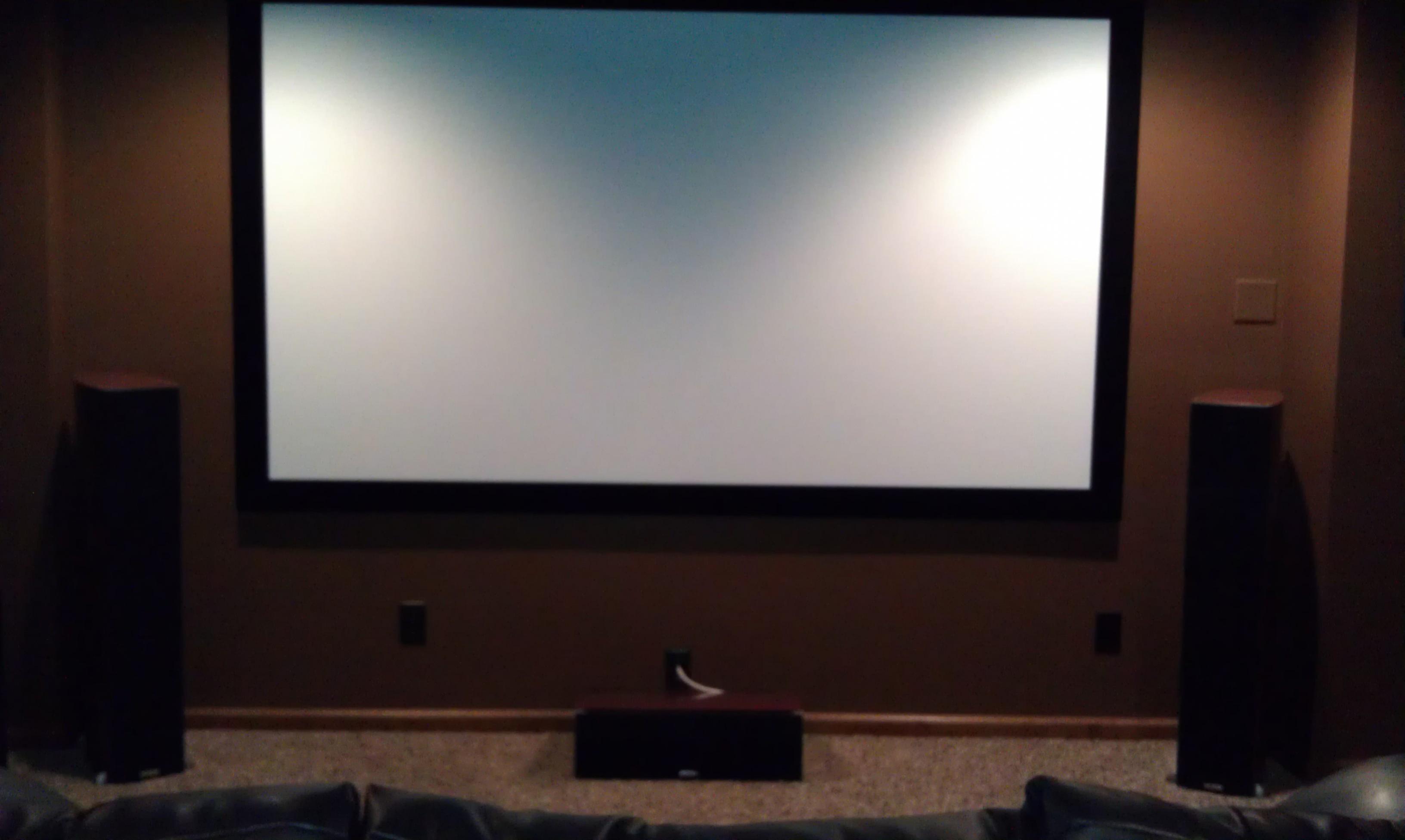

    I just finished the room and it is just drywall for now with carpeting and one sofa in the room. Adding another sofa for the riser this weekend. As I said, it is a small theater with a 106 inch screen and roughly 15x15.
  • Posts: 22
    edited January 2013
    I notice that many have recommended setting the speakers to small but I see no such option in the menus for the 709. Can anyone tell me where that setting might be? Thanks!

  • Posts: 685
    edited January 2013
    Dont toe the A7s they need to be flat. also look up first reflections get some panels up in that awsome room. Also get that center channel on a riser and off the floor.
