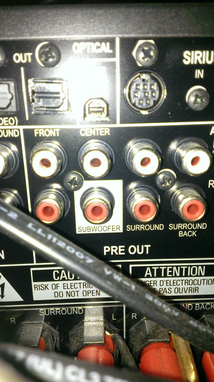

    I didn't check if your AVR has pre-outs, but if it does, adding a power amp would serve you very well.
    Take a look on Audiogon or eBay for an amp that fits your budget, should be plenty to choose from.
