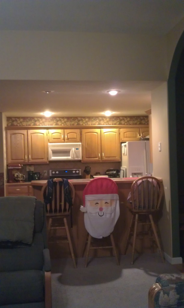

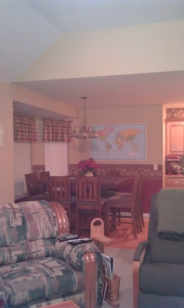

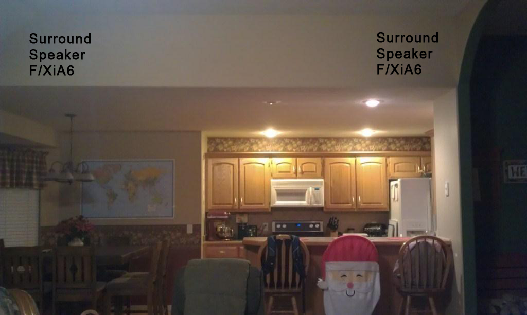

Here are a couple pictures of the back of my living room and the drop down wall where I am thinking of putting these speakers. Please let me know your thoughts if these will work here or if I should use a different speaker for my surrounds. There is no room on the side wall, so this is really my only option of space to use to install the surrounds. Thanks for any and all feedback.
Yeah, that's pretty much what I pictured in my mind. Your plan will work fine, you can experiment between the Di/Bipole settings to see what sounds best for you.Source: BRP Panasonic UB9000, CDP Emotiva ERC3 - Display: LG OLED EVO 83 C3 - Pre/Pro: Marantz 8802A - Amplification: Emotiva XPA-DR3, XPA-2 x 2, XPA-6, Speakers, Mains/2ch-Focal Kanta No2's, C-LSiM706, S-702F/X, RS-RTiA9's, WS-RTiA9's, FH-RTiA3's, Subs - Epik Empire x 2
Cables: AudioQuest McKenzie XLR's/CDP/Amp, Carbon 48/BRP, Forest 48/Display, 2 channel speaker cable: Furutech FS Alpha 36 12AWG PCOCC Single Crystal (Douglas Connection)
When I was young, I was Superman but now that old age has gotten the best of me I'm only Batman -
Thanks for getting back with me on this. I have been trying to find pictures of how people have installed these, but not having much luck. How far from the sidewall should I put them and what kind of angle should I have them pointing down from that height? The drop down wall is 8' from the floor and then the drop down is 2'. Thanks again for any and all help.
You can easily do a foot to two feet from the side wall. No matter how high you have them mounted, these babies are so powerful, you can mount them flush, or straight ahead.
You're going to get plenty of sound out of these speakers. I've run a pair of satellites, two different bookshelves and one set of towers (M70) as surrounds, and so far, these bipoles are by far the best and most sound emitting speaker I've heard in surround. In fact, make sure you EQ them good against your A5's so they don't overpower the fronts :cheesygrin:Source: BRP Panasonic UB9000, CDP Emotiva ERC3 - Display: LG OLED EVO 83 C3 - Pre/Pro: Marantz 8802A - Amplification: Emotiva XPA-DR3, XPA-2 x 2, XPA-6, Speakers, Mains/2ch-Focal Kanta No2's, C-LSiM706, S-702F/X, RS-RTiA9's, WS-RTiA9's, FH-RTiA3's, Subs - Epik Empire x 2
