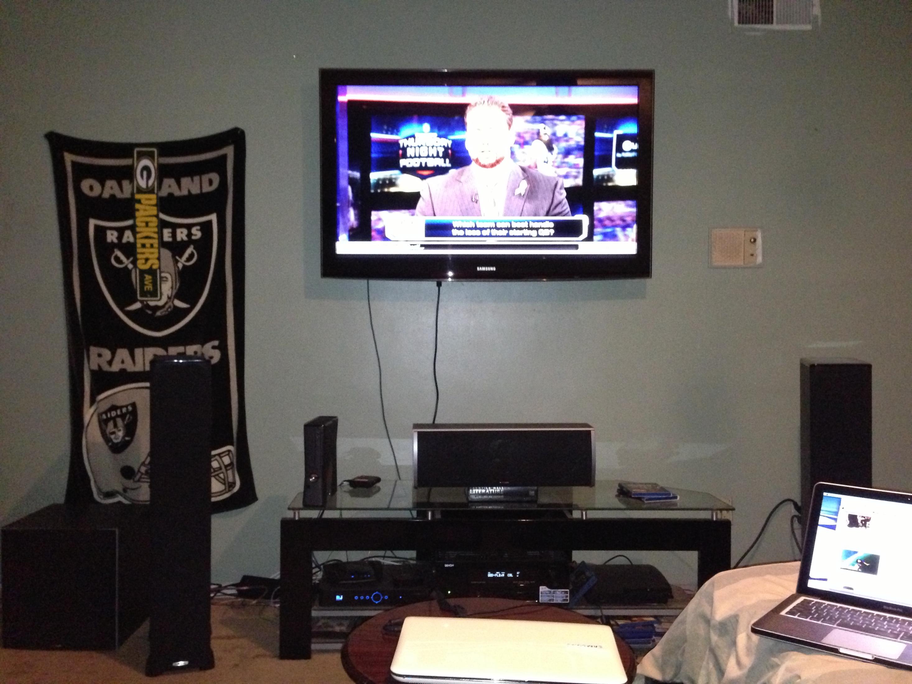

  • oleon621
    oleon621 Posts: 178
    edited November 2012
    A quick picture.

    I can't say for sure, but I would think that the glass table top has some kind of an impact on the sound from the center channel. Maybe put a section of cloth there or something? I dunno.
