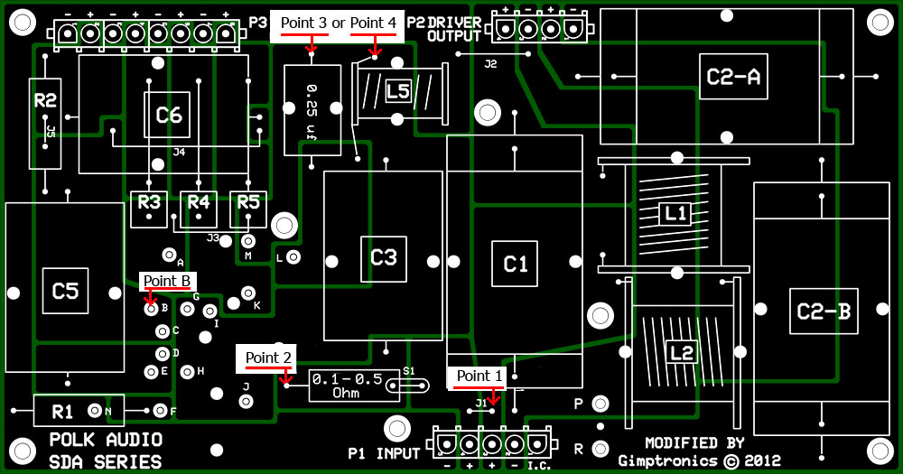

  • gimpod
    gimpod Posts: 1,793
    edited July 2012
    Just saw this thread (been gone researching a little project for you guys, Later on this).
    Those 5 watt Dueland shorts will work just fine as the original resistors were rated 5 watts. Toolfan66 used them in his 1.2TL's with very good results.
    A suggestion on placement, Look at attached pic.
    Remove J1 and the Mills 0.5 Ohm resistor then solder the Dueland 0.5 Ohm resistor in at points #1 and #2.
    Remove the Mills 2.7 Ohm resistor then solder the Dueland 2.7 Ohm resistor in at points B and #3.
    Attachment not found.
    Hope this helps.

  • gimpod
    gimpod Posts: 1,793
    edited September 2012
    Here ya go.
    The Dueland 0.5 Ohm resistor go's in at points #1 and #2.
    The Dueland 2.7 Ohm resistor go's in at points B and #3 or #4 which ever one gives the best fit.
    Note: Black is the copper traces and green is the space in between.
