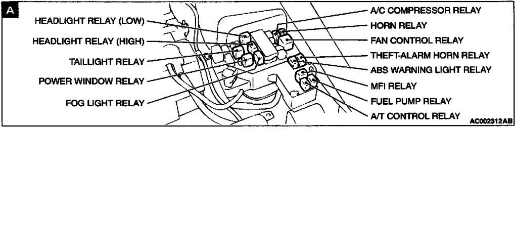

    OK, this is the location of that relay. OEM Part number MR409996.
    It's the horn/anti-theft relay. It interrupts the starter motor circuit if the proper key isn't in the ignition and such. They apparently go bad and can cause a bunch of problems. You're in luck though 'cause it's only like 10 bucks.
    Here's the location:
    That is in the relay box under the hood. On the driver's side, right above the front driver's wheel or mounted to the fire wall between the brake master cylinder and the fender.
    Unfortunately, without a relay tester they can be difficult to test. Getting continuity across an open relay is easy but applying the right amount of power to close the relay is more difficult. But it's so cheap that if it's even suspect might as well just swap it out.
    And, again, check the power cables. If they even look slightly ratty, replace them.
    But you didn't tell me what kind of clicking you are getting. That's important to know.

    Oops, my bad on the clicking noise. When the problem is exhibiting itself, there is a noise like the 'bzzzzt' of a gas grill's piezoelectric lighter (haven't heard one of these in a while, so perhaps it's a poor analogy; if said lighter actually 'clicks', then forget this comparison) between the firewall and engine block, and then a single click that sounds as if it's more towards the engine block area, or maybe past it towards the front of the car. It might would be nice to have a friend turn the key so I could listen under the hood for these noises more.
    I just went out and yanked the relay, came back and looked at the diagram you posted, and I think I pulled the wrong one. However, I'll have to go back out tomorrow (or likely Sunday as I work 12 hours tomorrow) when it's light out to confirm. But, it appears as though I have that lower grouping of three (A/T, Fuel pump, and MFI relays), and then a blank space of no relays until you get to the Fan control, horn, and A/C compressor relays. If what I'm thinking is correct, then I just pulled the Horn relay from the top corner.
    Anyways, thanks for the diagram, and I'll at least manage to get a look to confirm the relays tomorrow when it's light out again.

    So I took a second look at the fuse box under the hood and snapped a picture.
    As you can see, I have those three bottom relays that according to your diagram are the A/T, fuel pump, and MFI relays. And then on top I also have the fan control, A/C compressor, and horn relays (horn relay is currently removed). But in that middle section for the ABS warning light and theft-alarm horn relay, it's just blank.
    What the heck?

    No, it couldn't fix the other problems. You had the battery and starter tested and they were both bad. New cables aren't going to fix that.
    Bad cables, however, are the most likely culprit for causing the problem.
    You don't have to match up anything. Go to the parts store, tell the counter monkey that you need new battery cables for your car and they will be able to give you ones that will work well enough.
    Get to work, quit bitching. If it was easy, everybody would be doing it. But it's not, it's a big pile of suck and that's why mechanics charge so much. Their expertise and willingness to deal with it 'cause you don't want to either.
    If it's plastic loom, it's held together with electrical tape at strategic spots along the way. There are no splices in the line, just break-off points where the various wires need to route away from the main, protected trunk. Disconnect the battery so you don't shock yourself into oblivion accidentally and slit the tape over the wire loom gap with a razor blade. GENTLY so you don't cut into wires inside the loom. Pull it off gently so you don't accidentally rip another wire out of somewhere and cause more problems for yourself.
    SAVE ALL LOOM PIECES. You're going to put them back when you get the new wire run.
    And if you don't have the relays for the various functions then it's likely your car does not have those functions so don't worry about it. Just make sure you put the cover back on and replace that horn relay.so that no gunk gets in there and risks shorting out any connections. Plus that horn relay may cause the car to not start. But honestly, don't waste time and money on it. Put it back, I highly doubt it's your problem.
