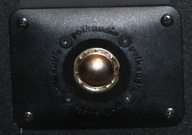

    Wish the photo was larger, looks like someone painted them gold the way it seems to be flaking off. The sl3000 and sl2500 turned a goldish hue, not a bright solid gold color.
    I'll take a close look to see if they are painted and snap few pics once I get home.

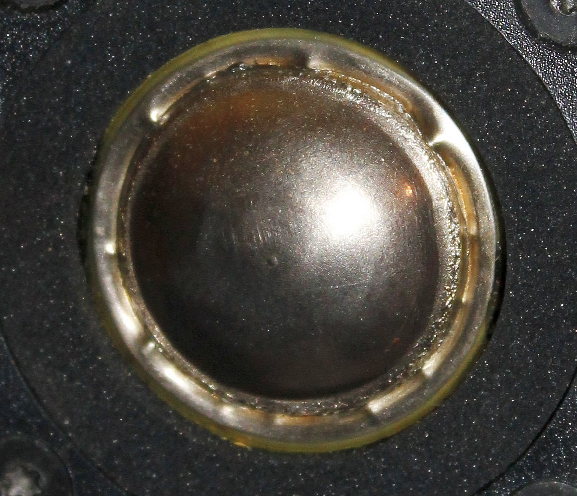

    Hopefully these pics of L and R tweeters (note to self--there is nothing to identify L/R) are little better/bigger.
    R:
    L:

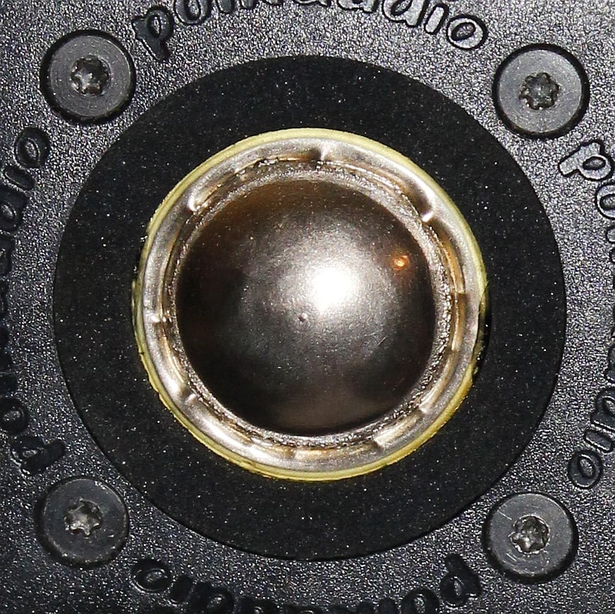

    I checked the tweeters and we may have something unique here.
    The gold is not flaking off. It looks that way due to uneven tweeter surrounds (or whatever plastic/rubber material that goes around the dome).
    The tweeter is SL3000. Looks like Polk tech pasted a sticker with "30" over "25" of 2500.
    Here is a picture of the back:
    cnh wrote: »
    If you look closely you will see, as H9 suggests, that the tweeters on your units are not as "lustrous","reflective" as the Polks and show evidence of extra "spray" at the edges whereas the Polk originals are clean there--they have a clean inner ring with no gobs of gold surrounding the tweeter. I suspect that if you rub your finger "gently" across that tweeter you'll probably pick up some gold on it?
    cnh
    It could be how golden SL3000 looks in real. The brochure may have lights reflecting from all over to get a better image of their new tweeter for sales reason.
    I tried to rub off on few corners and nope, they are there for good.
    The dome is soft and the gold layer is so thin and perfect that I don't believe it's done by anyone but the Polk.
    There is no gold color scattered anywhere else but the tweeter dome piece. Even the light yellow ring around the dome doesn't have any gold color paint and even the inner sides of the surrounds that's surrounding the dome has gold when I pry little bit, so it's not sprayed on from outside.
    Previous owners had these in basement for years and they never even took the grills off so I know they didn't paint it and even if they did, it won't be this perfect. They were trying to sell the RS1000 for $25 and never knew foams are gone until I took the grills off.
    So looks like RTA 8TL did come with SL3000 tweeters.
    Few more close ups of the tweeters; 1st and 2nd are of same tweeter:

    Did you check the other tweeter to see if it's an sl3000? These didn't come stock with sl3000's so they were either replaced by the owner or Polk ran out of sl2500's that day and sub'd sl3000's.
    Haven't pulled the other tweeter out but I think Polk ran out of SL2500's and used SL3000's instead.
    Are those both same ohms?
    How does that affect the crossover point and tweeter performance?
    Hopefully, Polk just didn't drop SL3000 with everything else made for SL2500. :rolleyes:
    Digging out old thread and found SL3000 came in many colors including metallic gold dome.

    That could be.
    What should I check for to find if it was only the tweeter or any other components replaced?
    Doesn't SL3000 take different Caps and resistors?
  • kcoc321
    kcoc321 Posts: 1,788
    edited June 2012
    I would check the PN and date on the Crossover.
    If you haven't already checked them, here is the link to the schmatics
    http://www.polkaudio.com/forums/attachment.php?attachmentid=18705&d=1155781881
  • deronb1
    deronb1 Posts: 5,021
    edited June 2012
    Great buy. I wouldn't part with my 8Ts for anything less than 200 bucks. Change the caps, drop in new tweets and you will be suprised how great they will sound. BTW, they CAN handle some juice. I am running mine with a 220wpc amp. They don't strain at all.
