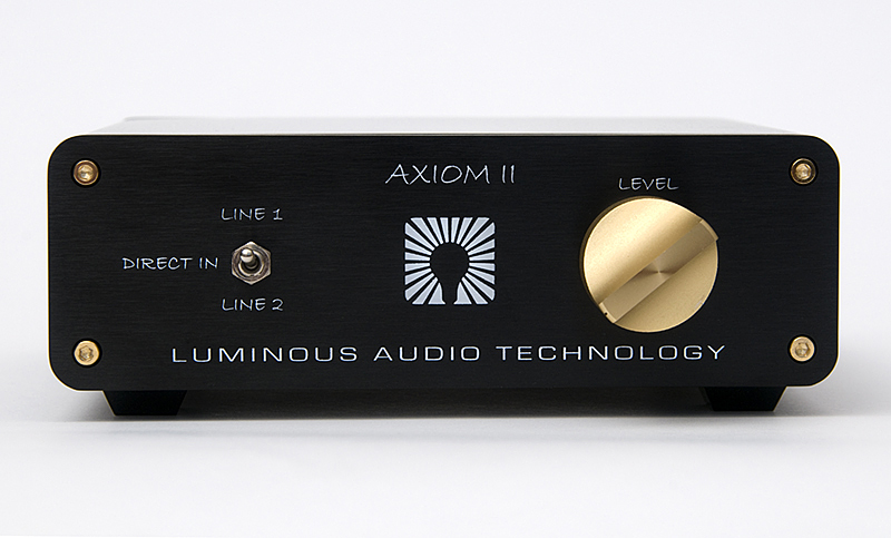

    I current have a Luminous Audio Axiom II passive pre and it's the best bang for the buck in my mind. Sound quality is great and the design is very simple, but it still has a nice look and great components and finish. If you're looking DIY, check out the Axiom II first and compare the cost of parts to build your project.
  • steveinaz
    steveinaz Posts: 19,545
    edited April 2012
    That's a cool looking piece!
