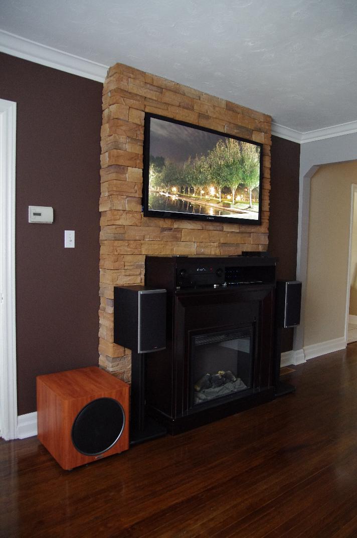

    To answer you question about gear:
    Receiver: Pioneer VSX-921-K 7.1 Receiver (110wpc)
    Front Speakers: Polk RTi6
    Sub: Polk PSW125
    iPod: 160gb Sixth Gen Classic
    I'm running RocketFish 16g wire to the fronts and a Dynex subwoofer cable to the sub.
    As for speaker placement:
    Comments and criticism about my gear and setup/placement is welcome! Like I said, I'm very new and am just trying to make a budget rig sound as good as it can.
    TV.JPG 139.8K

    The speakers could probably stand to be wider apart and toed in a bit. The TV is too high, but good luck changing that. The best sub location is highly unpredictable, but you're probably somewhat stuck with what you've got. For that, just have a buddy move it around within your constraints and see what sounds best. Plan b is to put it in your listening spot, then crawl around on the floor and where ever it sounds best, move it to there, but that's a pain and doesn't really test how it interfaces with your speakers (it does test where your standing wave nodes are).

    I would recommend you pull your speakers forward a bit, make sure the front of each speaker extends beyond the fireplace, then play with your subs crossover a bit to find the most seemless sound. I would start around 20-25 hz above your speakers -3db dropoff and adjust from their till it sounds best to you.
