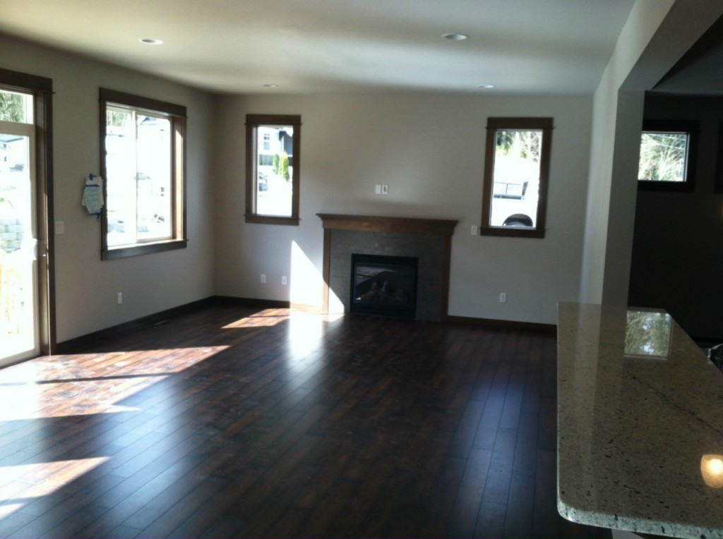

We may be putting on offer on a house this weekend which is very exciting, but since it's new construction, having huge, 2 channel stereo was not taken into account when the house was built; nor is it for most new construction it seems. I know I always have the option to put my system in the office or living room, but since I spend 90% of my time in the great room (family room/kitchen), I've always had my system in there, and would prefer to keep it in there so I can always listen to music. Below is a picture of what the TV side of the family room would look like.
The last think I want to do is get rid of my Fortes, but I really don't like the look of speakers sitting out in the room, in front of those cubbies in the walls. I could mount bookshelf speakers in the top cubbies, but I would still need to put all my electronics up there, as well as do a lot of custom in-wall wiring to keep everything looking clean. I've also considered a sound bar as they have a very clean install, and I'm sure the SurroundBar6000 is very nice, but I'm not sure how disappointed I'd be listening to music on it, coming from a real 2 channel.
I'd be very appreciative of any suggestions!

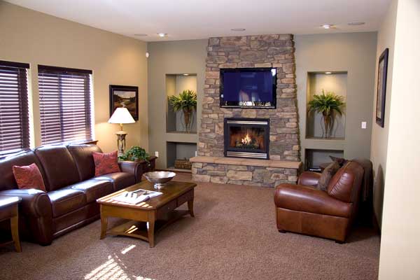

    That's a beautiful room but it does suck for anything "major" upfront. Since the architecture (built-ins and fireplace) is the showcase!
    Wouldn't know what to do in there. Maybe a set of higher end bookshelves like Steve's Harbeths?
    Congrats on the new home, though. It's really something special!

    I seem to be noticing what look like ceiling speaker grilles. How about installing the best ceiling speakers you can find?

    How about setting the speakers up on the wall opposite the sofa? Move the armchair to face the fireplace. You could put your electronics in the closest cubby (would need long speaker cables), or get a rack and place between the speaks.
    Looks like you would have around 8-9 feet from the speakers to the listening position on the couch.
    The window behind the sofa would be an issue, but with a little creativity you could minimize that.

    That's a picture of the model and I never noticed the ceiling speakers before. Never though of of that, but I'd probably rather do in-walls in the cubbies if I went that direction.
    The wall on the right side is not an options (bad picture) because it opens up to another part of the house after about 8 feet which would then put the stereo against the cubbie on that side. What ever happened to older houses with huge walls?

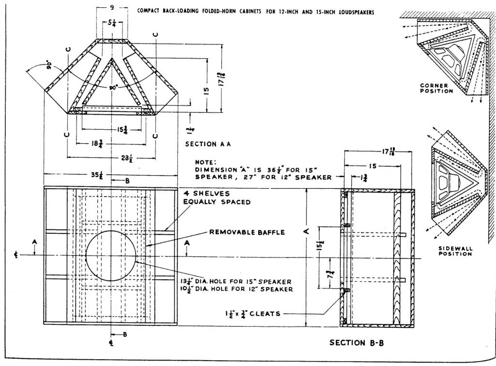

    What about mounting a full range driver (like the Tang Band W8-1808) in a triangle shaped enclosure and sticking them in the corners? I'm sure there is a fancier/better way to do it, but if the enclosure size was appropriate, wouldn't that sound decent?

    What about taking a pair of Klipsch Heresy (or similar) and making corner cabinets for them. The horn can be mounted any where since they are sealed, and the cabinet should just be the appropriate volume. What issues am I overlooking?

    I would be reluctant to go changing a cabinet. Speakers are designed as a unit. Changing dimensions (even though maintaining the same volume) may affect performance. If the width of the front baffle changes, for example, then the baffle step correction (part of the XO) needs to be changed. And placement in a corner may result in undesirable reinforcement of some bass freqs.
    I can understand that full range drivers may not provide the SPLs or bass performance you as looking for, but re-jiggering two or three way systems to fit them into corners may prove even less satisfactory. And I'm sure there are multi-way speakers designed for corner placement.
    Cheers, Jim

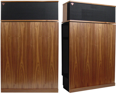

    I'm hoping a nice pair of bi-amped Klipschorns would stunt my need to upgrade as it takes A LOT more money and floor space to progress beyond those horns.

    At first I thought maybe built-ins on either side of the fireplace but the plants look way too cool to mess with their space... Maybe some super small higher freqency speakers on either side with a woofer and sub some place not so visible?
