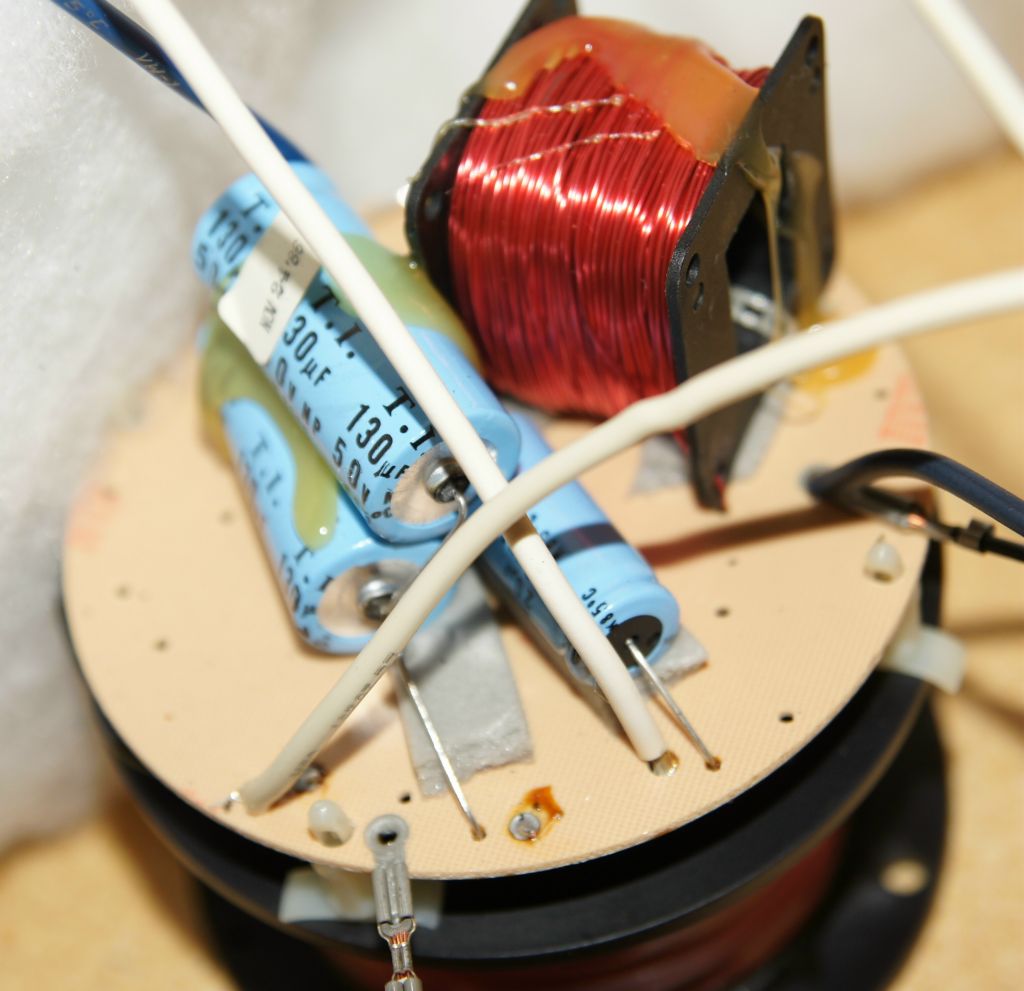

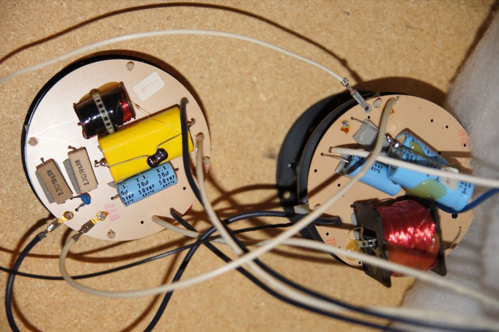

    Here are the images of the crossover boards.
    Lots of hot glue but does not like look like a difficult upgrade. I can see that the crossover is different and the 2A uses the same drivers but I was wondering if there were any major differences between the 2A and 2B from a listeners standpoint?

    The difference sound wise between the 2A and 2B i can't say as I've never heard them, I've got 1C's and CRS+'s
    The hot glues not really bad on those I've seen a LOT worse, you can use alcohol to remove it from the caps but leave it on the inductors. From this point it doesn't look to hard to do but just wait till you get those new film caps and try to get them to fit on those boards especially those 130uF one's. Here's some tips and link for parts.
    First: mark and label all the wires that connect to the crossover paying close attention to the wires for the IC socket as they are wired different for each speaker.
    Second: Only do one crossover at a time.
    Third: Do NOT clip the leads on the caps and resistors until you sure everything fits and is wired correctly.
    Forth: That little brown thing on the yellow caps are 750pF Silver By-pass caps and are not need with the new and better caps you can get today.
    Here's a link to the schematic for your 2A's SDA 2A Sch.pdf
    Here's the parts you'll need.
    Parts Express
    Solen 130uF (2.45" x 2.76") @ $48.17 ea x 4 = $192.68
    Solen 20uF (1.26" x 1.77") @ $9.25 ea x 4 = $37.00
    Sonic Craft has a 20% off sale going on right now. (There listed prices don't reflect that but the discount will be applied when you request a quote)
    Sonicap 12uF (1.17" x 1.74") @ $22.50 ea x 2 = $45.00
    Mills MR12 2.7 Ohm @ $4.15 ea x 4 = $16.60
    Mills MR12 0.1-0.5 Ohm @ $4.15 ea x 2 = $8.30 Note: these are used to replace the polyswitch (that little blue thing) but ONLY if you can keep from cranking the crap out of the volume control other wise I suggest you leave them in. The value really depends on taste, the lower the value the brighter the tweeters. 0.22 Ohms seem too be a good place to start.
    While your at it you should get some good solder like Cardas Quad-Eutectic 24ft for $7.00 is more than enough to do those.
    And some new binding posts
    Vanpire BPHEX @ $14.35 a set x 2 = $28.70
    Or Cardas CCBP S @ $26.25 a set x 2 = $52.50
    Hope your sitting down as that's around $300.00 + just for parts more if you need a soldering iron (a 40 watt), Hot Glue gun, Solder sucker or wick etc..
    BTW: On that glue for the passives just make sure it wont eat the styrofoam.
