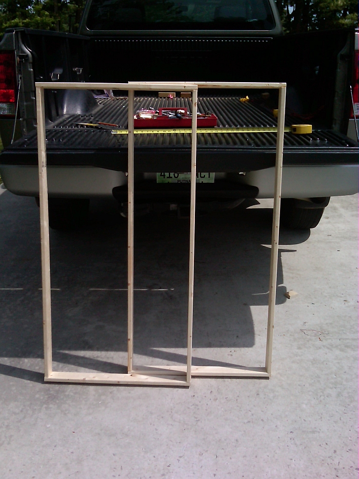

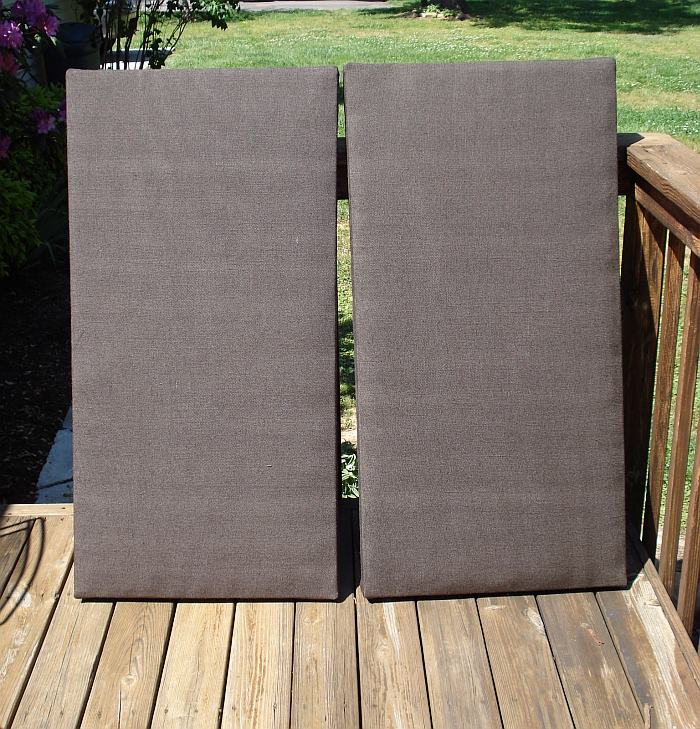

    Here's a pick of some of the stuff I made... don't look half bad...

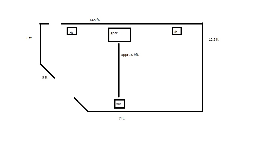

    I wish I could help this room a bit. The only place I have for my system is not square. Or rectangular. When we built the house it was a covered section on the deck and we decided to make it living area instead. Good move but I have a little trouble with the big SDA2Bs in there. If I listen at reference levels things get a little crazy. Any suggestions to improve the sound in a room with these dimensions?
    The open area in the outside lines are doors. The large area are where french doors reside and the small open area just a standard 36 incher.

    Try not to get too discouraged. A lot of people have less than optimal rooms. But, with the proper acoustic treatments, badly shaped rooms can sound decent.
    To start with, put bass traps in all the corners. After that, starting putting traps on the walls (especially the angled wall) to stop reflections. The deeper the traps, the better, and space them an equal distance from the wall as the traps are deep.
    Building/buying a diffuser for that rear wall (opposite the speakers) might help as well.

    I have been pondering how much that would help a room like mine. If it would help I would build some bass traps. Here is one I found on Youtube:
    http://www.youtube.com/watch?feature=player_detailpage&v=iyYUpkpL0gw
    Looks easy enough. The video says to put them floor to ceiling in each corner. Is that true?

    PreCd wrote: »
    Yep, those plans would work just fine. Also, that's correct - the more of the corners you can cover, the more you will knock down the bass that gathers in those corners. For even better performance in the corners, build a "super chunk" trap. Basically you cut triangle wedges of OC703 or OC705, completely filling the corners. They are more expensive than traps that just straddle the corners (depending on thickness), but they are more effective as well.

    I would trap the corner to the right of the speakers and possibly to the right of where you are sitting.
    You really can't trap the other walls effectively.
    Do you have the speakers set up to mimic the distance from each other as much as they are from you? They should be about 9ft apart maybe even a bit less. I have found that rooms with a wedge shape like yours, like speakers a bit closer to each other than normal.
    Do you have any floor covering at all? It sounds like your hearing to much reflection and a throw rug in front of the speakers would kill tons of it.
    Also Drapery on the walls would help with slapback and reflection. They don't need to be huge but they need to be heavy and porous.

    First off thanks to Phasewolf for letting me butt in on this thread. Even though it was about his room I believe we both can learn from sharing it!
    Thanks for the suggestions on trap placement. So none behind the speakers or my gear? If not then I was going to order way too much Roxul! I was looking at 12 pieces which would make 12 4' traps or a few less and a few triangles for the corners. I was thinking about making two traps for the french doors, which would not be that hard to hang, and transfer them on and off when I wanted. That left speaker is pointed at them at an angle.
    My speakers are approx. 7 - 8 feet apart and that is about as good as I can get them as far as width apart. I have not considered moving them in closer to each other but am willing to try it so thanks for that bit of info.
    The room is carpet so I have that part covered........no pun intended. No draperies though. Could I not just place a couple of traps up instead of draperies?

    Got started on my bass traps today. I used 1x3 inch furring strips. Ended up using wood glue and two screws at each corner. I have saw videos where only staples were used but I went the screw route. It will be there forever. They measure 47 x 23 inside the frame. Here they are:

  • audio_alan
    audio_alan Posts: 770
    edited April 2012
    Good start. I look forward to seeing the final product, how you installed them, and what your impressions are.
    I'm not sure how many you are planning on making, but keep in mind that you'll need to make several of them to really make a dramatic improvement. Just 2 or 3 in a room won't really cut it... unless those 2 or 3 have very large dimensions.
  • PreCd
    PreCd Posts: 786
    edited April 2012
    I am looking forward to the finished product also. At this time I have 4 built and will probably get 5 ready for this weekend providing the burlap I ordered gets delivered. That has been shipped so I would assume that by this weekend I will have finished panels.
    I did place 2 of them with rockwool inserted behind my speakers and it did make a difference so I am looking forward to experimenting!
    audio_alan wrote: »
