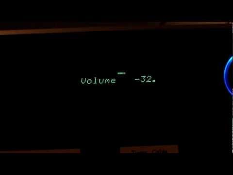

    Well, good news. It's not the receiver. Here is a video of my Onkyo doing the same thing - can't turn the volume up to 0dB without it basically sounding like noise. Here it is at -32dB with Adele - Set Fire to the Rain and the sound is already very loud.
    With my classical recordings I can go up to 0dB and over without hearing distortion.

    My issue is with the distortion. If you look at the first video I posted, I have the Denon turned up to 0dB on a classical piece and it's sounding great at that level. Nothing's wrong with the system, no blown tweeters, and the sound is really engaging to my ears. Pop in Adele, keep the volume at the same level, and you will go deaf within a short period of time...
    Now in the second video I tried this with my Onkyo receiver. I can turn the volume up to the +dB range on a classical recording, no problem, but keep the volume set at +4 with Adele and ouch!! Painful to the ears.

    There's nothing wrong with your equipment. It's compression. All the peaks have been chopped off due to everything being boosted to satisfy the "louder is better" crowd. I'd bet that cd doesn't have 8dB of dynamic range.
    For those of you not familiar with this "technique" go to youtube and search "loudness wars." You'll see how distorted and compressed some of you music is.
    Thanks. I guess there's nothing I can do except turn the music down, even at -32 it's too loud. And for those saying I would damage my gear, you guys are right - if I play one of my usual classical recordings at +4 and then switch to Adele I'd definitely be clipping my system and destroying a tweeter or more. Gotta remember to turn down the volume before switching over.
