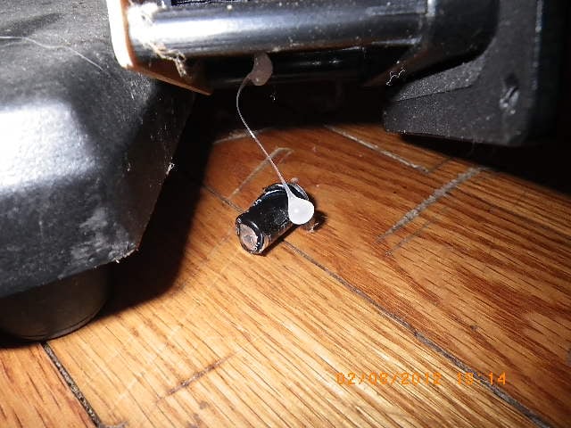

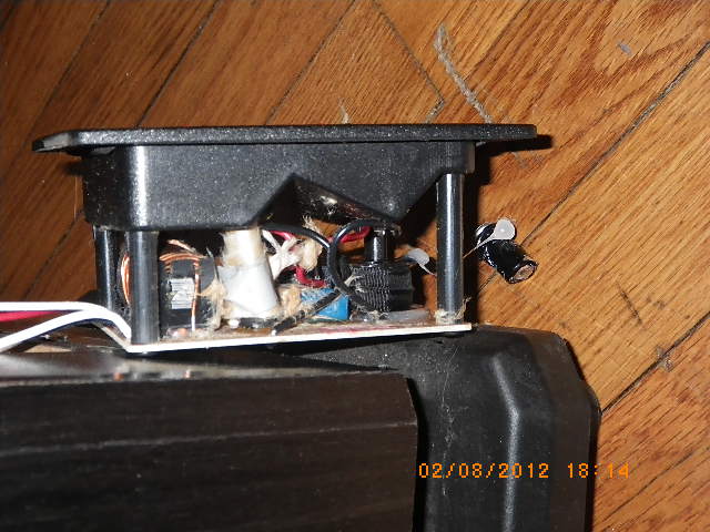

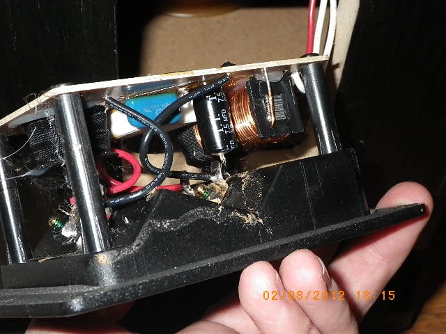

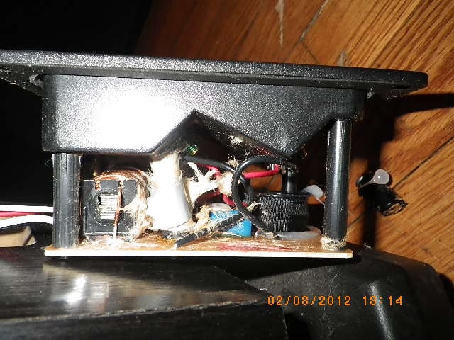

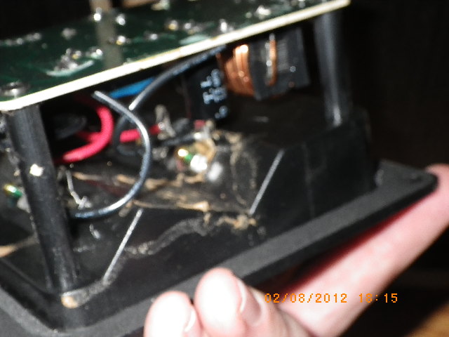

Alright, check it. I think I have a blowen cap on my crossover, what do you guys think?
Take a look at the RTi70 schematic here. You will see that the 7.5uf cap (C1) that is blown in your crossover is indeed in the tweeter circuit. It's definitely worth it to try replacing it, as the cap will be inexpensive. However, just replacing the cap won't ensure that there aren't other components in that circuit that are faulty. Do you have a DMM that you could use to test the other components in the tweeter circuit?
...I would probably try replacing the cap anyway if I were you.2.1: PC>Schiit Gungnir MB>Schiit Freya Noval>NAD C-270>Ascend Acoustics Sierra-1, HSU STF-2 5.1: HDMI Bitstream>Denon AVR-1910>polkaudio RTE55, CS350-LS, RT3, HSU STF-2, Visio M55-F0 -
