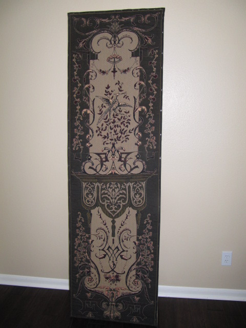

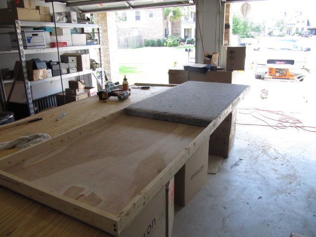

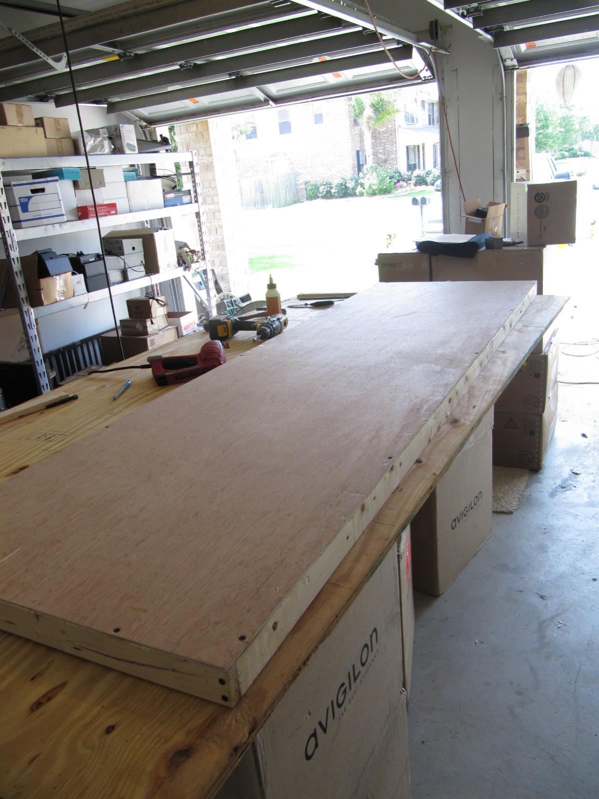

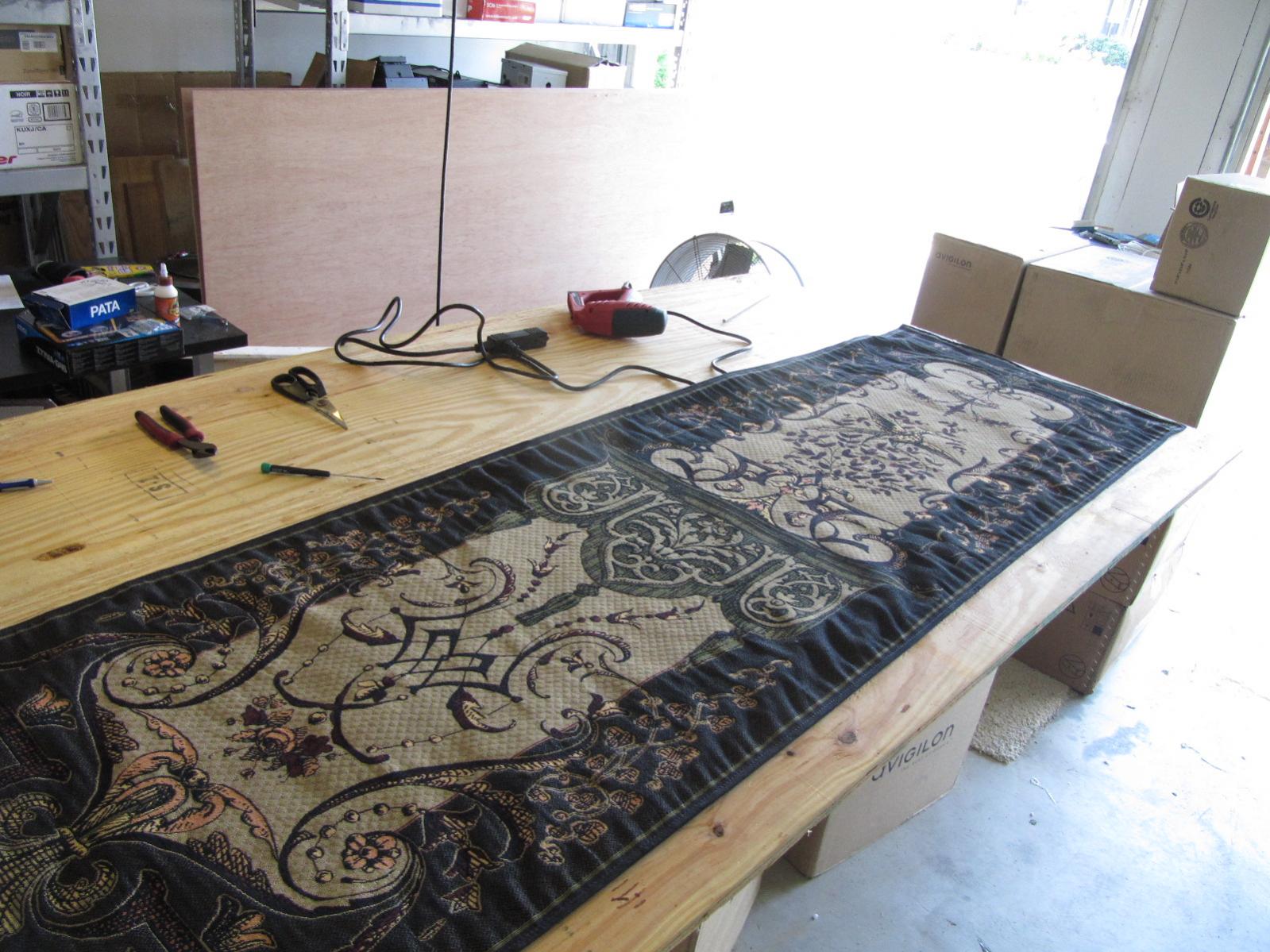

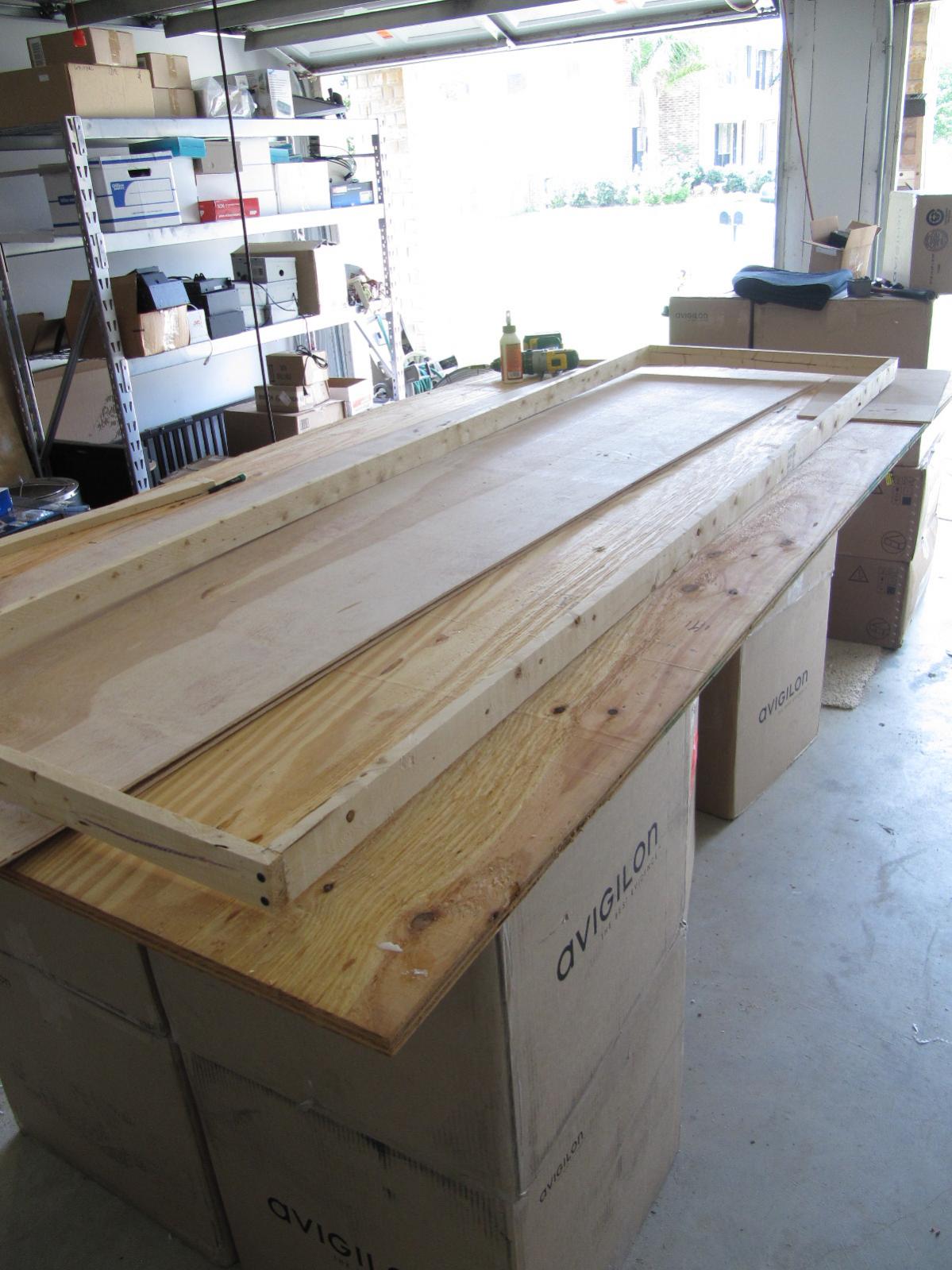

    Here are some WAF DIY (2) panels I worked on today, I have some 2 3/4" deep DIY picture framing coming which will frame these 26"w x88" tall.
    Bought a couple tapestries, and some 2"ECO acoustic insulation from Acoustimac.
    These will go behind my Usher minidancer-2's in a couple weeks...so far so good...like I said wife approved

    Those panels do look good my friend. One question. Why enclose the back of the panel? From what I have been reading from many different sources leaving the back permeable allows the sound to bounce from the wall back through the panel therefore increasing the efficiency of the panel.
    Then again I look on the ATS Acoustics website and see that the panel they sell for DIYers has an enclosed back.
    SDA2BTL
    Marantz CD5004
    Adcom GFA-545
    Bottlehead Quickie Tube Preamp
    txcoastal1 Posts: 13,500
    edited April 2012
    PreCd wrote: »
    The density of that backing (shot 9/16" staples like butter) is really no different than the sheetrock with 3 layers of paint, plus having 14' ceilings those panels are 7-1/2' tall helped keep frame rigid
