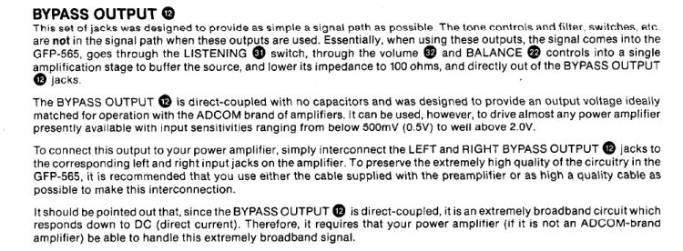

    Hm? I wonder if the bypass mode on my Adcom GFP-565 is passive? I think I remember reading that it was. I will check that out tonight.

    It's not. Bypass simply bypasses the tone controls. The Adcom GFP750 preamp has active and passive stages.
    No, it's still going thru preamplification stages. These "electronics" are absent in a passive linestage. My passive (placette) does nothing but control volume, and it does that with an array of Vishay resistors. Since most sources provide 2 volts or better at their outputs, amps that have an input sensitivity at, or below this can play at full volume without the need of a preamplifier stage. For example, my Parasound amp has an input sensitivity of 1.7 volts to achieve maximum output.
  • PreCd
    PreCd Posts: 786
    edited December 2011
    Nope. My Adcom GFP-565 is not passive in bypass mode. <br>

    steveinaz wrote: »
    You are correct. Well this is still better than running it through the many capacitors inline.
