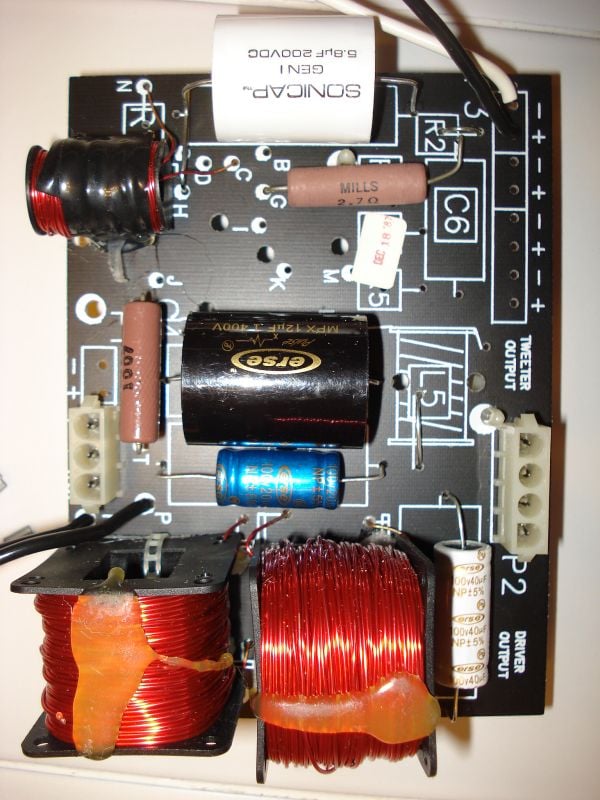

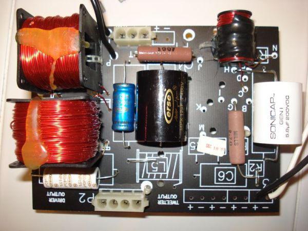

I was looking over the pics of the mod to my SDA2Bs and things look strange. Looked over the schematics and it cleared things up a bit. I attached some pics so that you all could see what I was looking at. My speakers were originally SDA2As, were upgraded to SDA2Bs by the audio store in 1987 or so, and I just wanted to be sure we were looking at apples to apples here. Pics below.
Red Line = 5.8uf Sonicap
Yellow Line = 2.7 ohm Mills resistor
Maroon Line = 12uf, 20uf, and 40uf capacitor.
Please take a look and give me your feedback. I want to make sure I have everything in the proper places. I flipped the foil side horizontally so that it would be easier to follow the components on the board.

The crossover pic looks right.
Remember, new caps take a couple of hundred hours to burn in. -

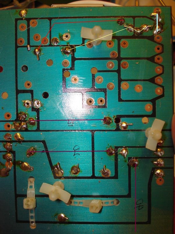

When I placed the notch filter on the boards I did notice that the solder pads had oxidized. Being new to all this I did not understand at that time that this could be a problem. The acid in the flux is supposed to take care of some of the oxidation but I do not think it eat through all that was on the board. I am going to let it run for a while under the current setup and see what happens. If after burn in I still am having the tweeter issue I will pull the xovers, unsolder the notch filter, and clean the pads up. I did that with one of the pads that would hardly take solder using a pencil eraser and then cleaning it with 90% alcohol. The solder on this pad would just pile up on top of the copper solder pad in a ball. Could be a potential problem.
