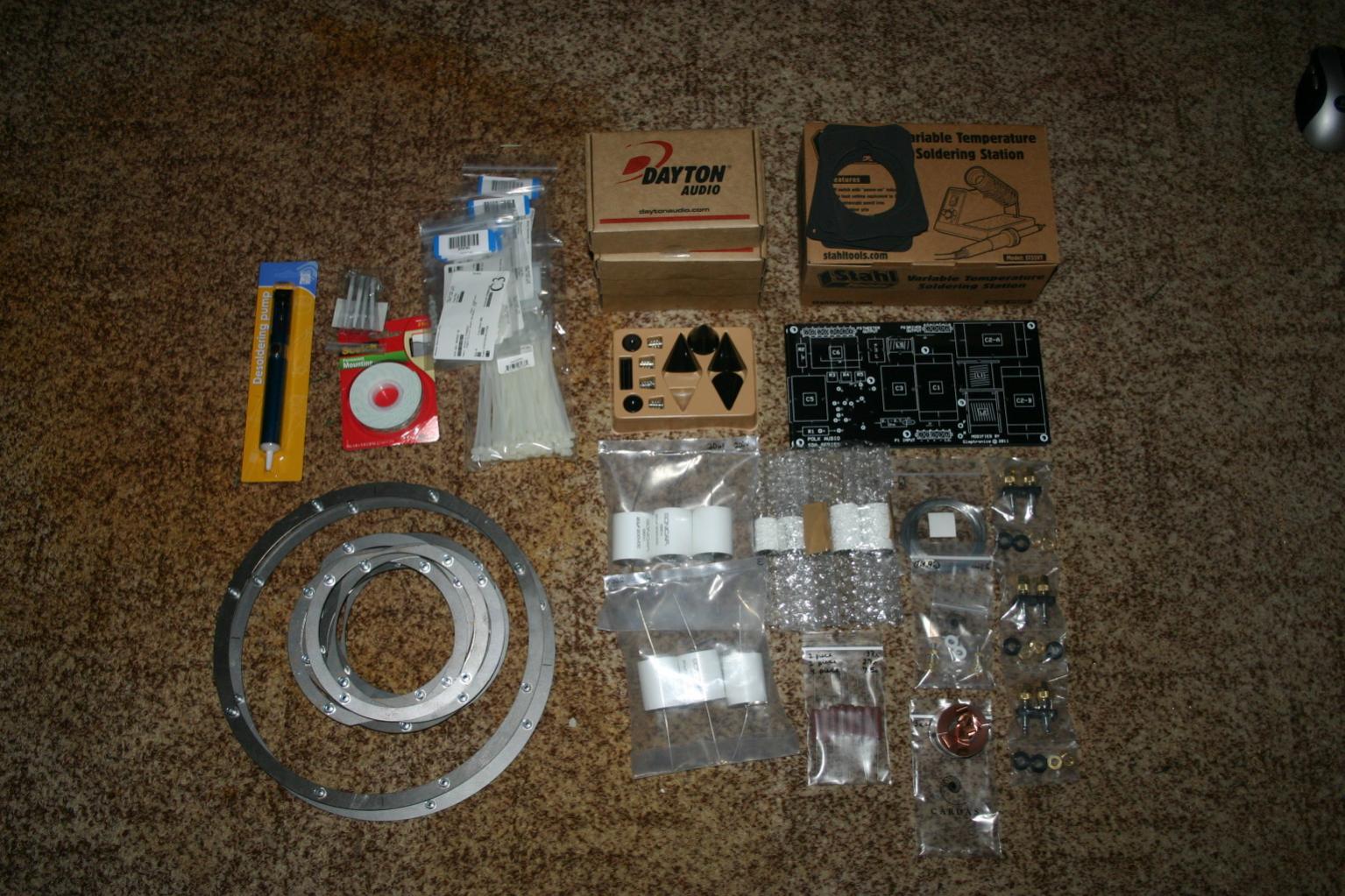

My list of parts thus far is as follows,
Rings,gaskets,boards,solens,mills,spikes,rd0's(already installed)cardas binding and IC post.
I am toying with the silver teflon wire for the harnesses and IC cable but I'm yet to get around to ordering that or JB weld and dynamat but they will be before I start.
I will post pics as they become relevant throughout the build. Once all parts arrive I don't see it taking more than a week to complete it but I am a stickler for all parts prior to commencement so I will be waiting till then.

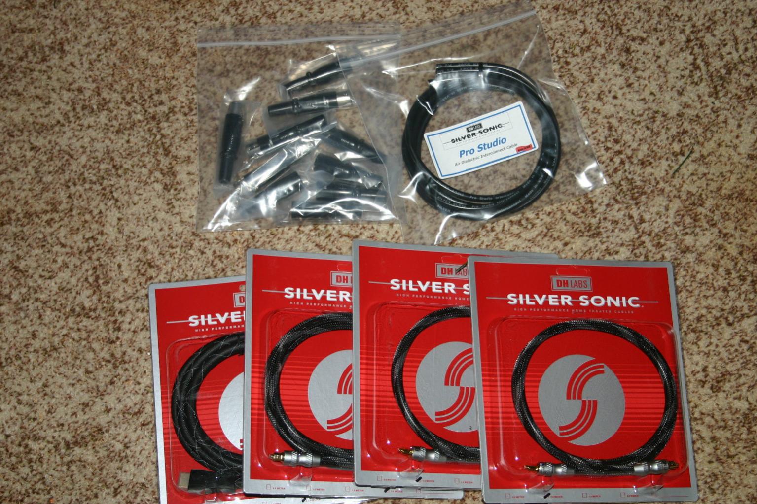

    Add to the list of parts for installation the following;
    (1) PS3 (for bluray source mainly)
    (2) DH Labs Silver Sonic Toslink 1 meter
    (1) Dh Labs Silver Sonic Toslink 2 meter
    (1) Silver Sonic HDMI 1.4 2 meter
    (5) Pro Studio/ OFC xlr .5 meter
    They said they would drop it in the mail today :)
    Thanks, 1C

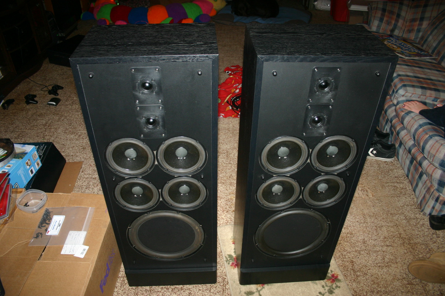

    The list is coming together. I guess now I need to buy some time! lol

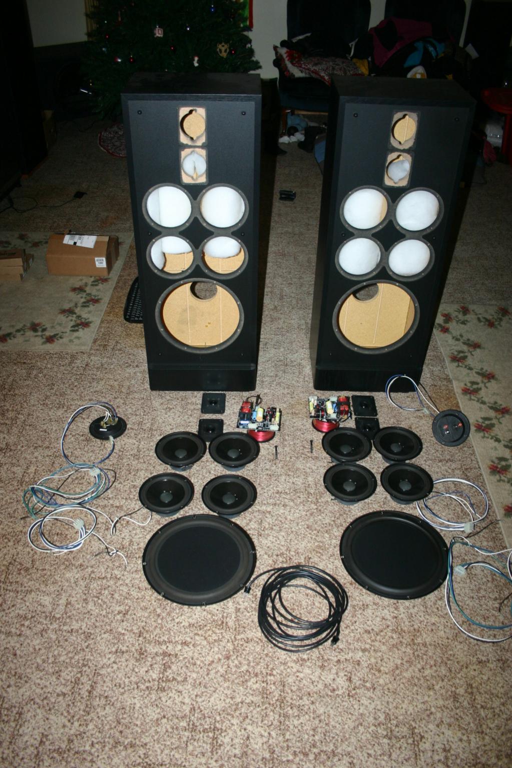

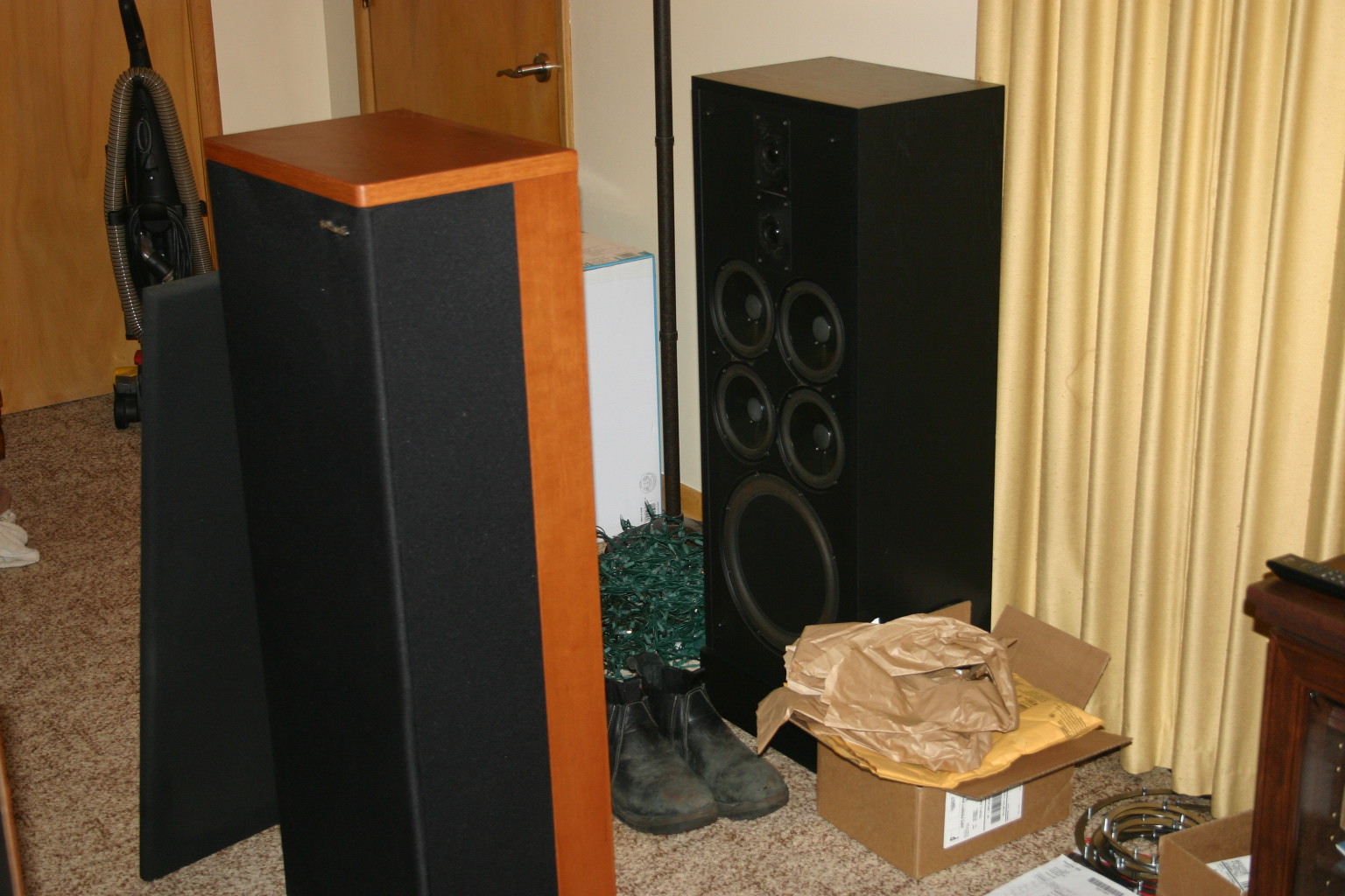

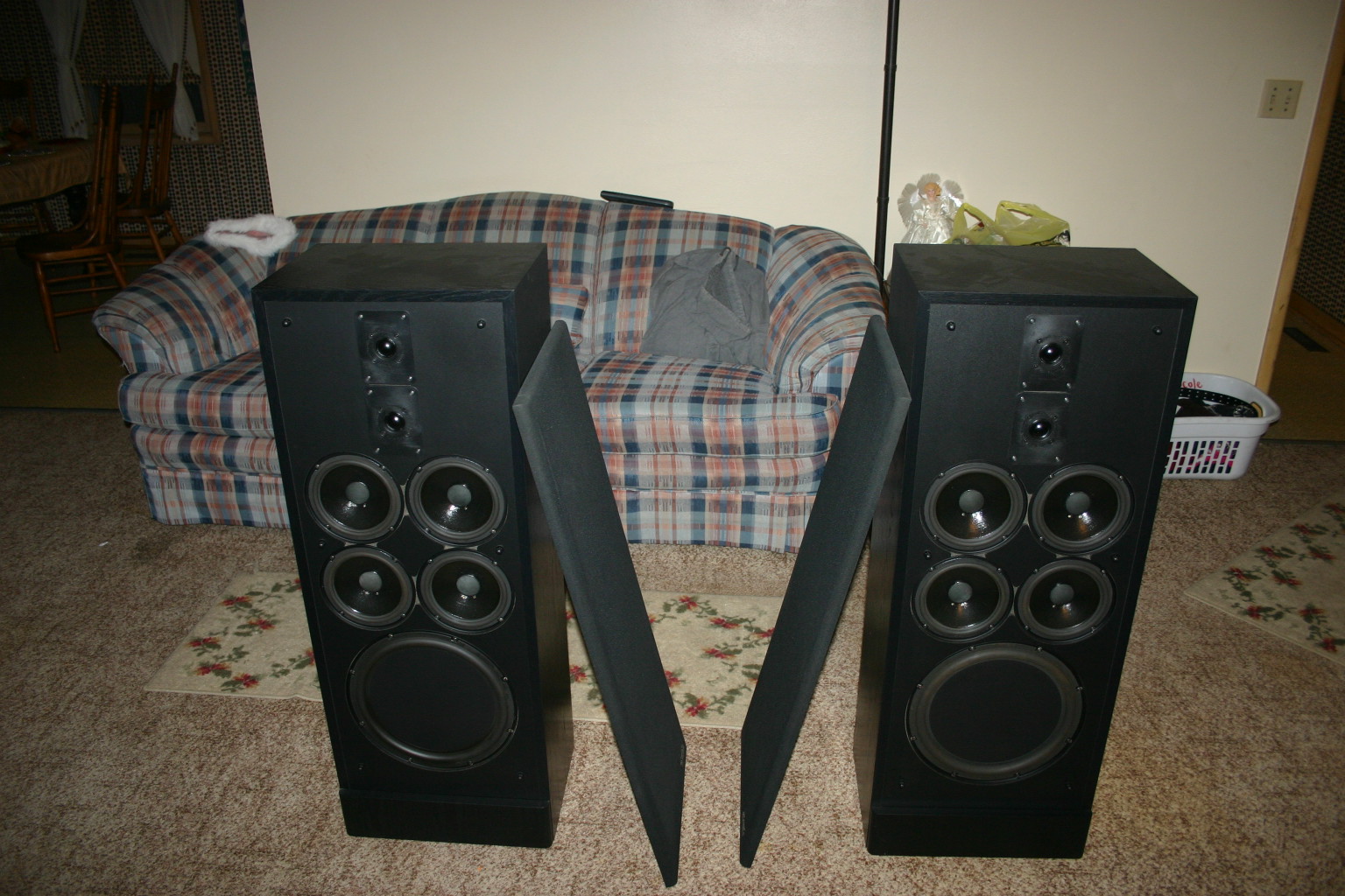

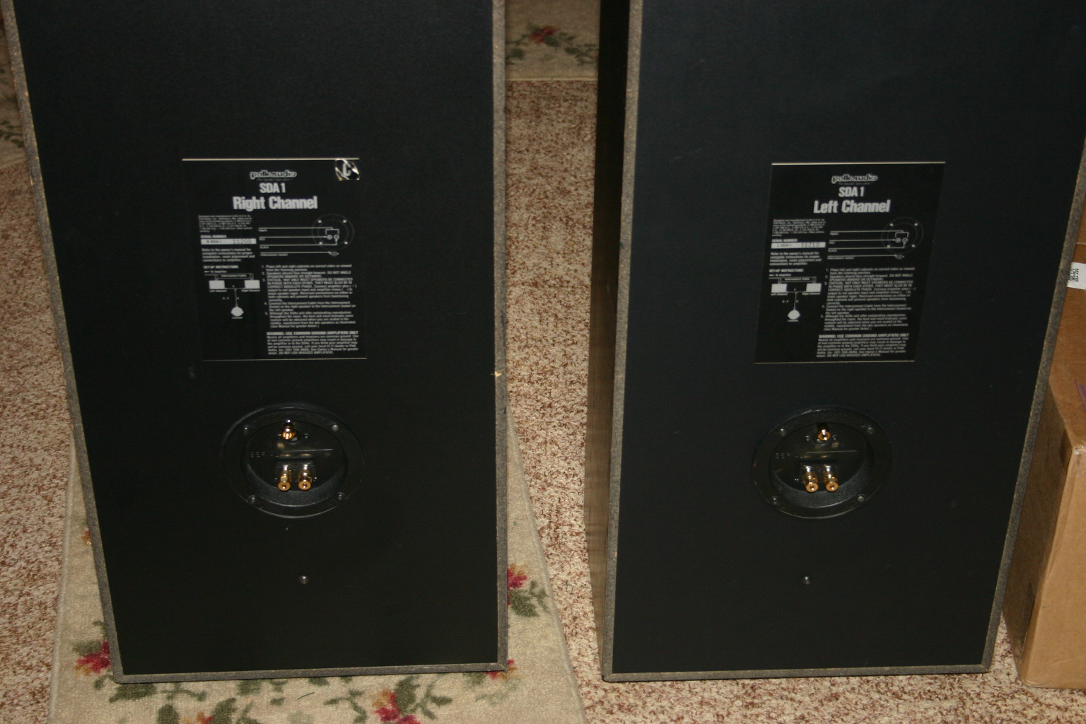

    Okie Dokie...Here we go!
    Before shots with the temp replacements in place and the studios removed for posterity. I will NOT go with out SDA in front channel! OOOP! guess the pic of them isn't actually in place but close to it. Anyway... the temp set is there to continue the duty till the stud's get modded!
    More to come! 1C

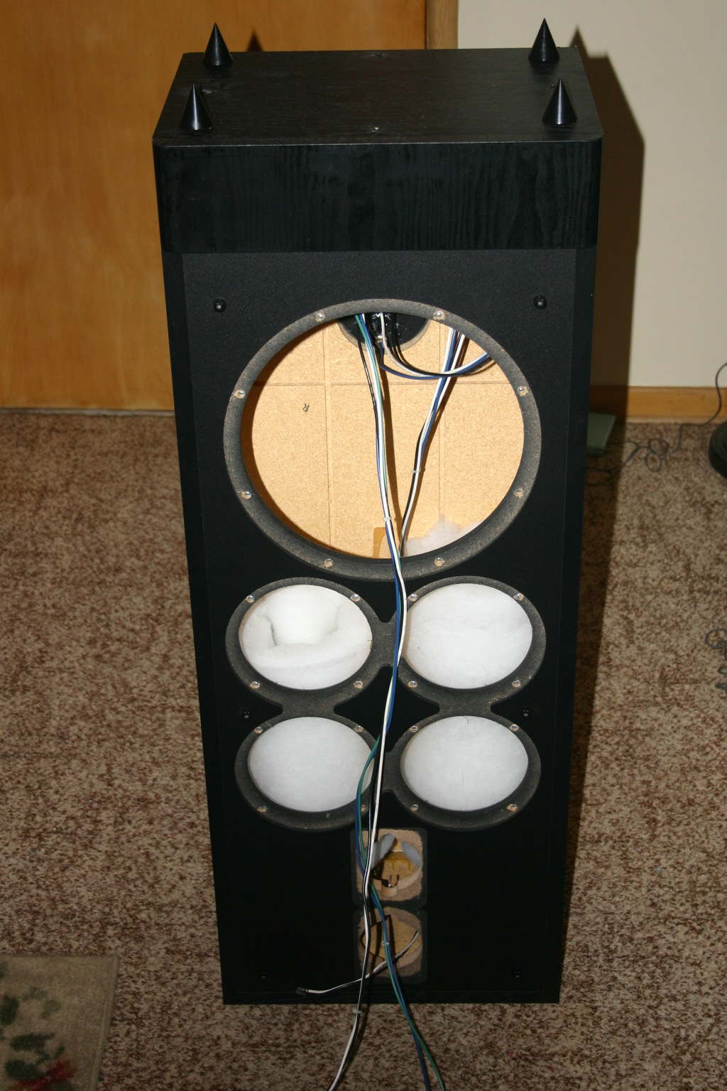

  • SDA1C
    SDA1C Posts: 2,072
    edited November 2011

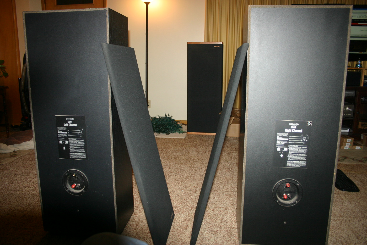

    Out with the old...

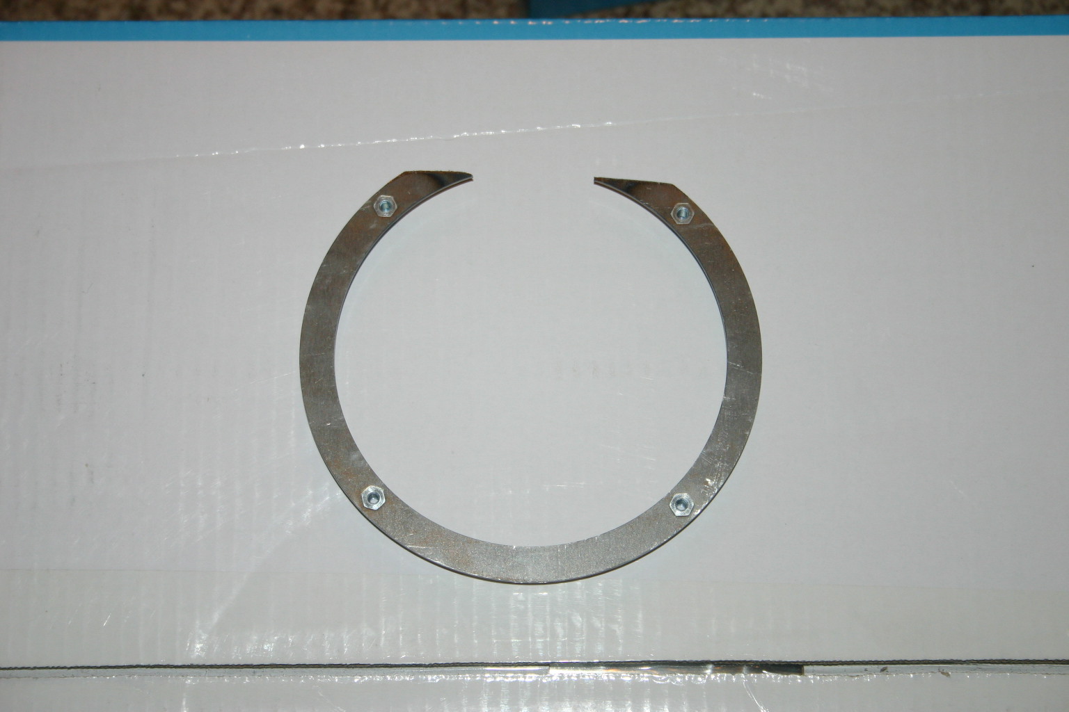

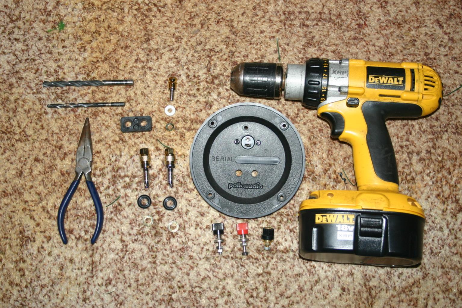

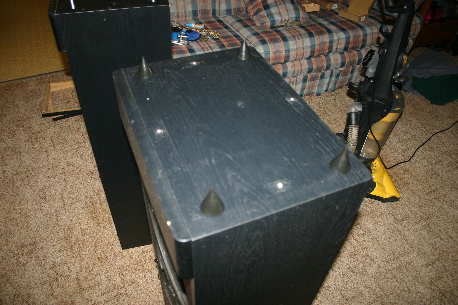

    Once the cabs were disassembled I bet I have less than 2 hrs installing (modifying) the rings and the spikes. Both jobs are a snap!
    Easy Peasy! Mark some lines, drill some holes, Screw them in....Cake walk for anybody!
    More of the same. Other Speaker.

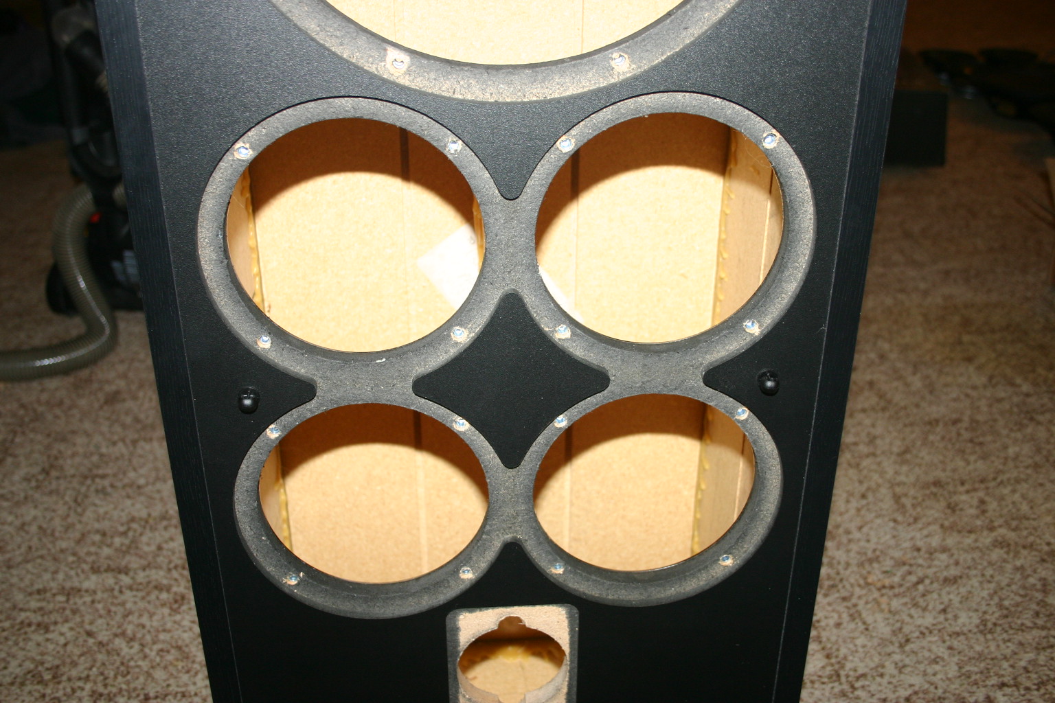

    This was the only thing that took time. The internal brace encroached the space the rings are designed for. Instead of carving out the cab (NoNo!) Just grind off some of the ring. Also, Have a chisel handy cause glue must have been cheap in the 80's lol. Easy to scrape the glue off but it MUST be done to get the rings to sit flat and work properly.
    Shazaam! Rings installed... Now off to the closet for these cabs till the xovers are finished. I am toying with the idea of buying new inductors. Same but new (For some cosmic reason that just "is" but cannot be explained:rolleyes:you cannot use the foil type. I'll verify when I mod the xover in my cs350, I already bought the new foil inductor, that it might just be an SDA thing) and keep the original x0ver boards intact. It may set me back a few days but I jumped the gun anyway by starting before the dynamat arrived HeHe.
    Welp! That's all for now.

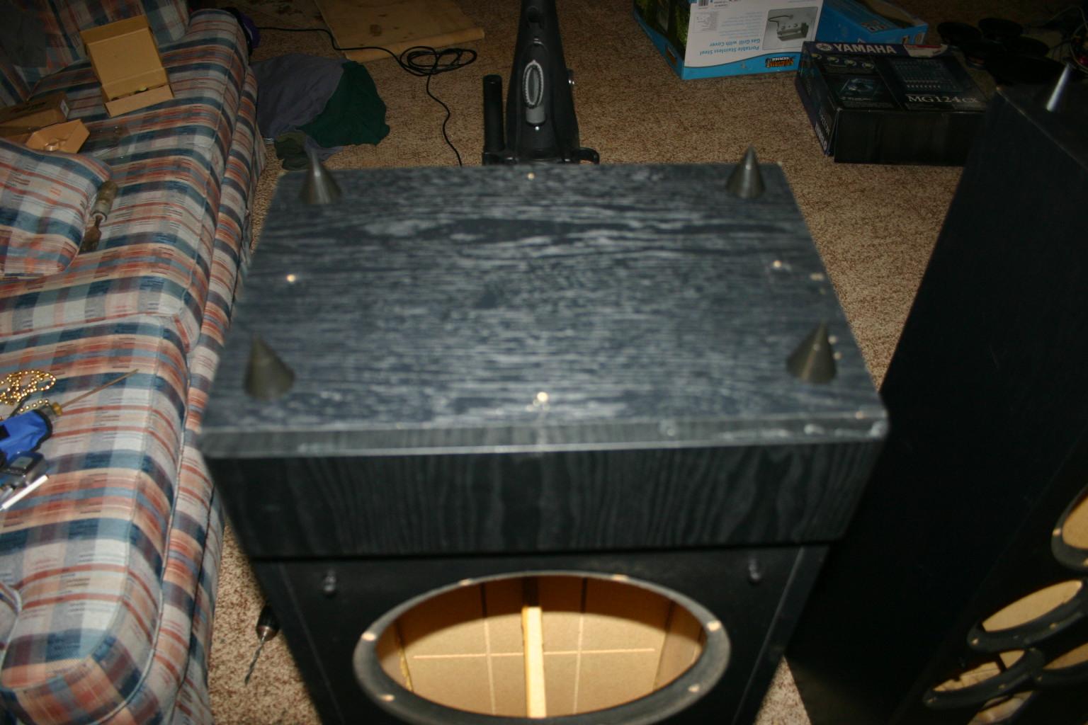

    I might spike my 11's while I wait for the soldering iron (Yes, it's that easy)
    1C

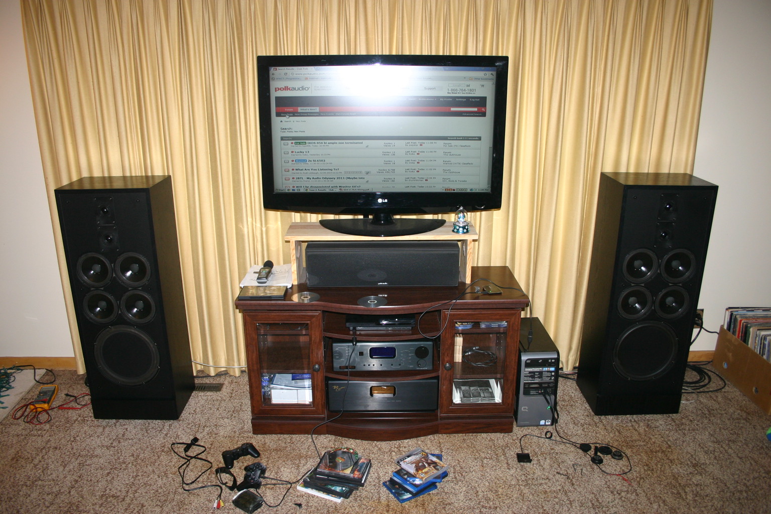

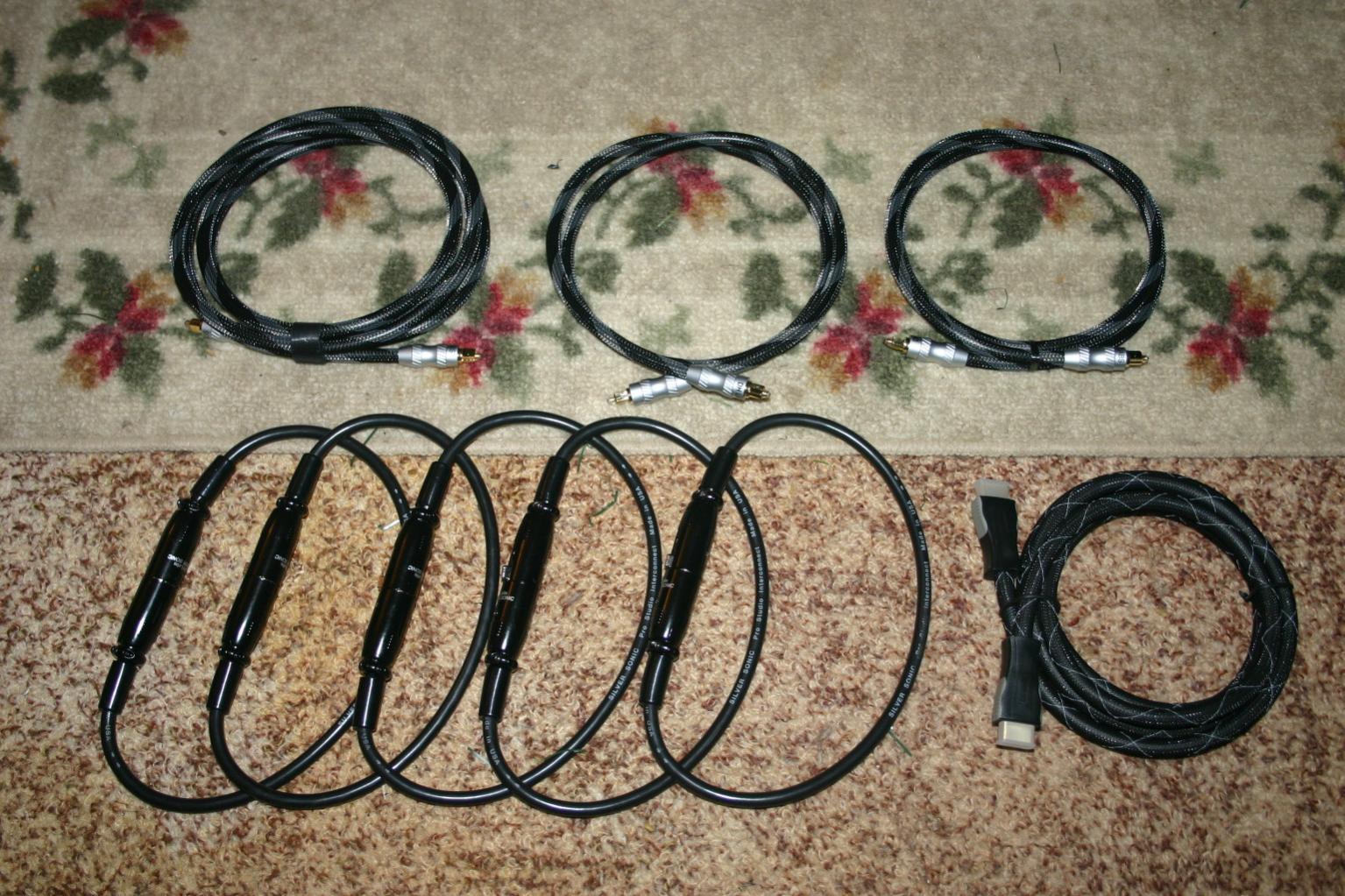

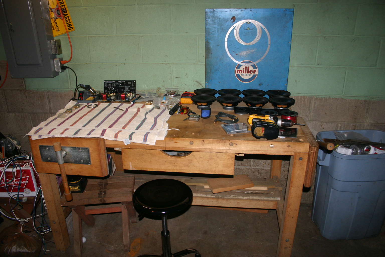

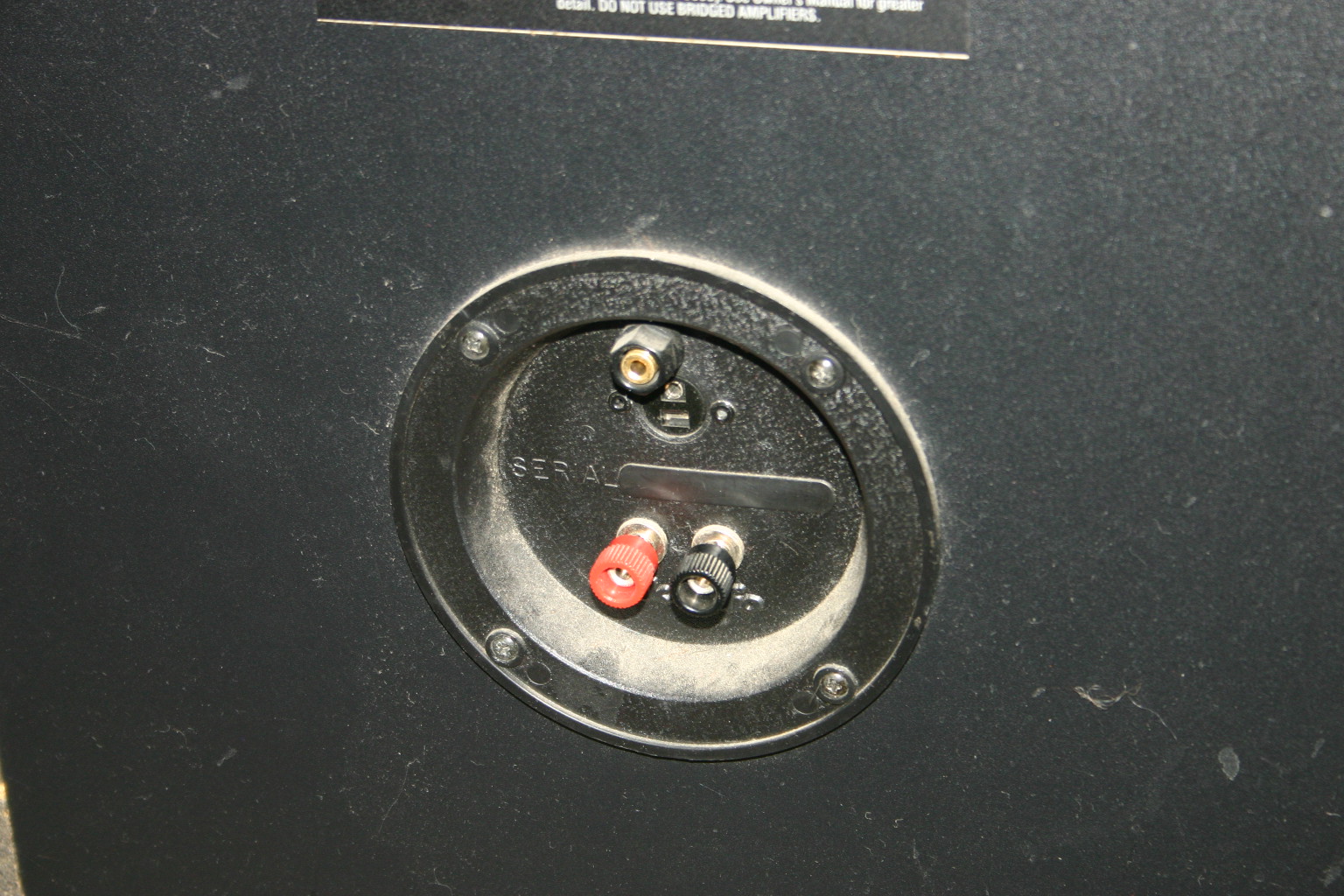

    IC upgrades complete. All Silver Sonic.
    Starter on the oxvers. My little work bench.
    1C
    p.S. The hole for the SDA IC was already there and off center. I sort of had to go with it. No biggie or functional difference it just would have been nice to have it in the middle.

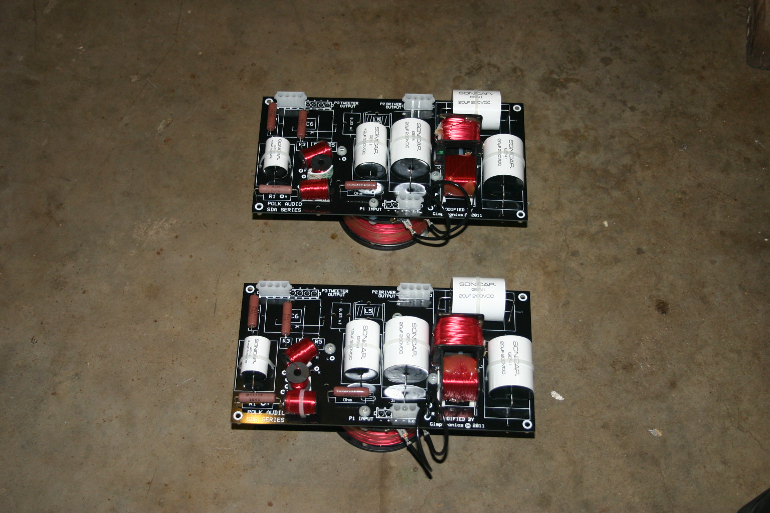

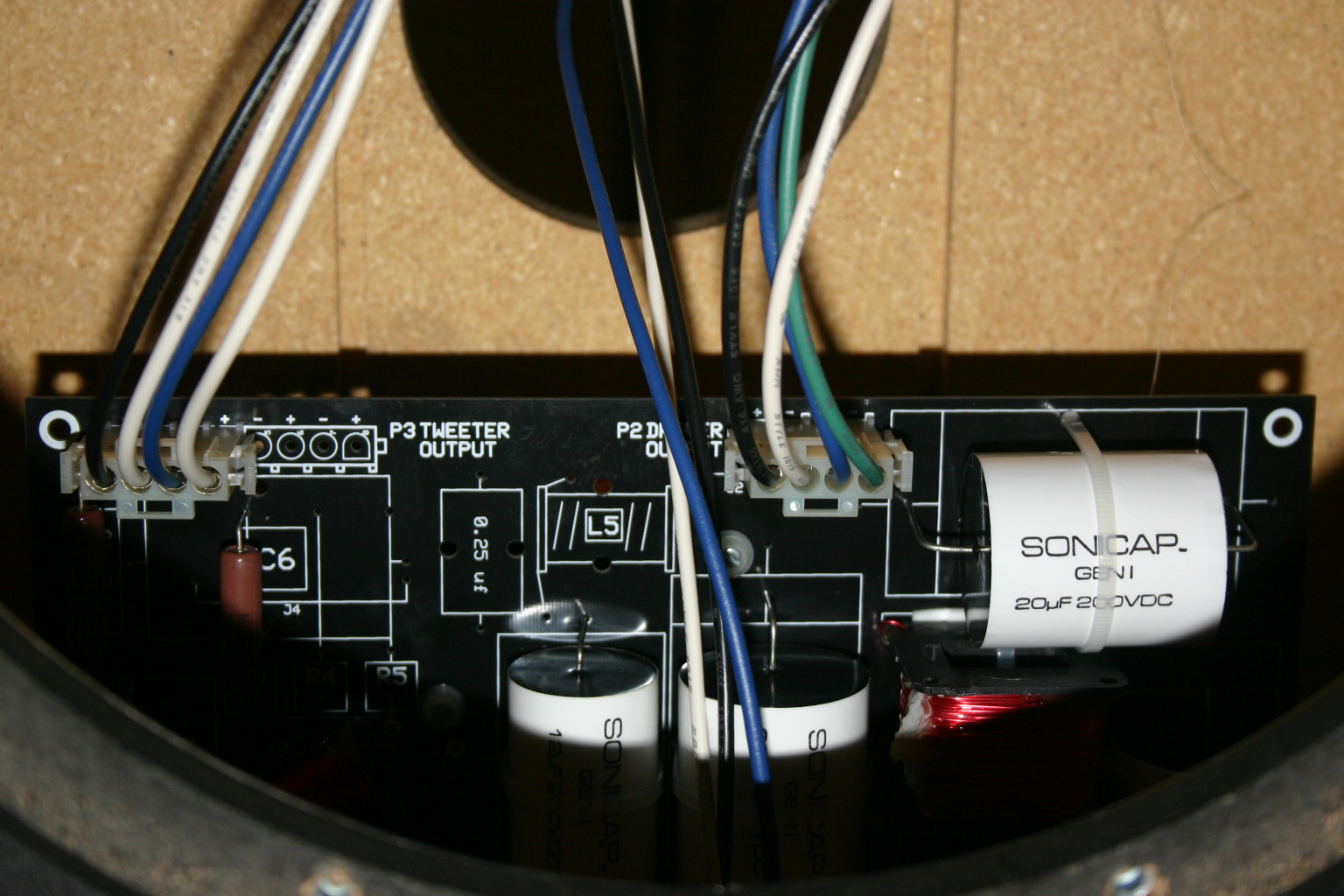

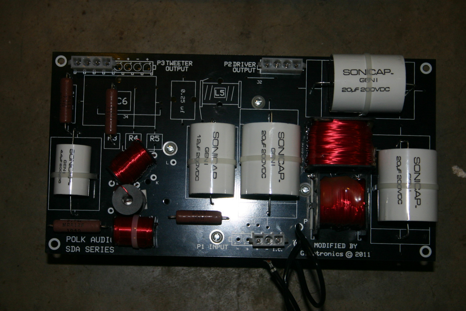

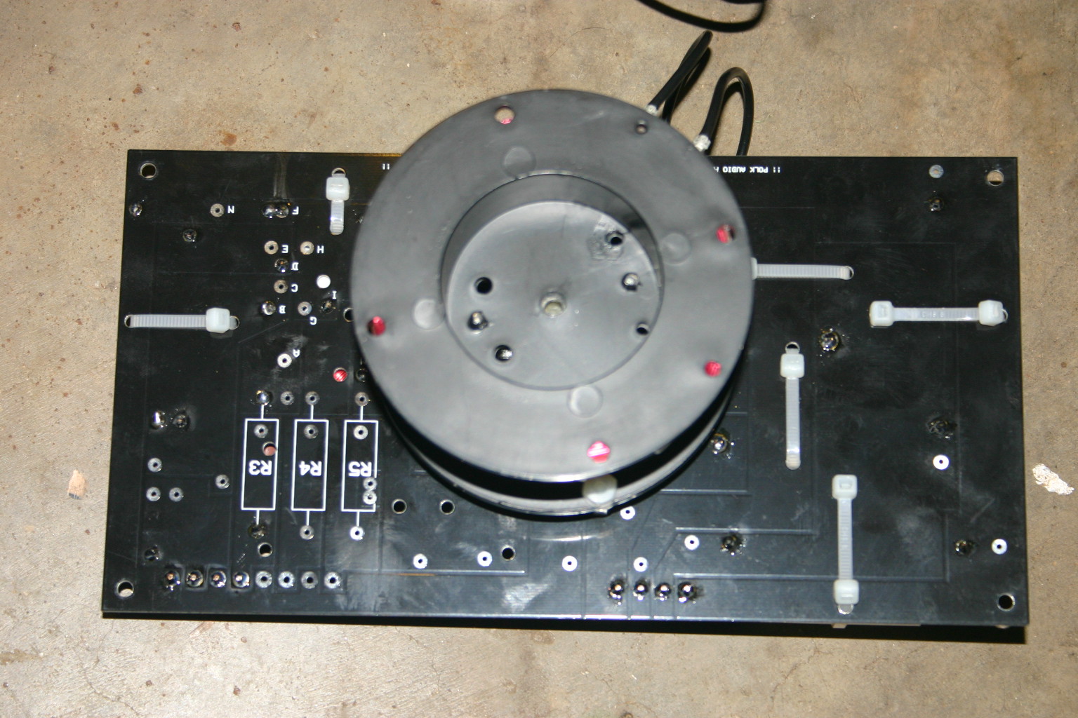

    All Done! What a difference! I can't WAIT to start cooking tweeters! I would go through the numbers on how and all that but honestly.,..Gimpod has done such a stellar job of all things xover I really have nothing to add. Oh I did think of something! Don't forget the jumpers lol.
    Here's a few pics of the fun.
    Too much **** to list....

    Thanks, I still have the dynamat and jb weld but figured I could wait untill I get all the gaskets and do that all at once.
    I should take some pics of the old xovers lol there were resistors that weren't even attached! Sort of why I decided to use the factory inductors rather than get new ones. I thought at first Id have a chance at keeping the old ones functional but they would have need a complete workover to everything but the connectors so I said heck with it.
    These have become a set that will not be let go. They sound phenomenal and look just as good as they sound. I couldn't be happier!

    One thing to note here if you aren't aware and might be having someone else do your xovers.
    In the fist pic (of both xovers side by side) You'll note a gap between the resistor and the board. It is there for a REASON.
    At higher listening levels those resistors will get warm. (That's why they "burn out"). If the resistor is placed next to the board or on sticky foam (lol) It will burn the board,the resistor, or your house. Either way it's safe to say under these close proximity circumstances YMMV...eh? Premature failure of the resistor is a best case scenario as the resistor casing will now expand and contract at different rates. Quickly cooling one side of the resistor and doesn't allow sufficient cooling to the other.
    1C

    I think you would have to really crank it for extended periods on a regular basis for that to be an issue, IMO.
