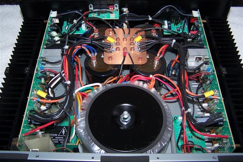

    The first step is to remove the cover and see if you can see the fuses. Then remove one and bring it to any place that stocks electronics parts. In the old days I would have recommended Radio Shack, but not so sure now. In all likelihood it will be a "metric" size fuse: 5mm x 20mm as opposed to a longer fuse. The current rating is 3 ampere and it is a fast blow instead of a slow blow or time delayed fuse. Most places if you bring the fuse will help you find the correct replacement.
  • pmckeealaska
    pmckeealaska Posts: 808
    edited October 2011
    I took the top off but there is a red plastic housing around the right unbalanced input site and I cant see where the fuse might be. Any ideas?

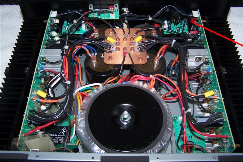

  • pmckeealaska
    edited October 2011
    The red plastic housing I'm talking about is at the top right of the attached photo. See red line pointing to it in the attached picture.

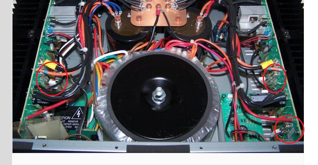

    txcoastal1 Posts: 13,306
    edited October 2011
    There are fuses in the bottom right and left of the pictures
    edited October 2011
    Fuses marked with circles
  • pmckeealaska
    edited October 2011
    So I assume that the fuses on each soundboard correspond to each input (i.e. right and left unbalanced inputs in this case?). Thanks for pointing me in the right direction txcoastal as I really dont know what I'm looking at when it comes to electronics!

  • pmckeealaska
    edited October 2011
    OK, closer inspection shows no outward flaws with any of the fuses yuou circled. I assume this means its not a fuse issue. No idea where else to go with this.
    edited October 2011
    If you can take a small screw driver and pop them out and look at them with light...the filament is small does not have to be black...would be best if you could test continuty of the fuses with a cheap tester if you did not want to pull them
    also I am not sure if there are more fuses...those are the only ones I can see in pics
