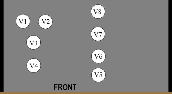

    It seems to be a filament issue since this is what dies. Tubes filaments are wire together V4 to V8 and none other tubes seem to die?
    Confused does output tubes die faster?

    Are both V4 and V8 dying at the same time, or is it just one or the other?

    When it died, and I found that the tube V8 5965 didn't light up I moved V4 to V8. And now V8 blow up again. But they are the same GE 5965 tubes. I think I remember that the V8 tube looked pretty light, could it had a bad tube? A tube with bad vacuum, blowing the filament? I have a 5751 tube in the socket and it doesn't sound bad, or look odd, too bright, or anything odd.

    Yep, equivalent replacements only, and never power up with a dead tube or tube missing from it's socket! Bad things can/will happen.
    Steve, you know the 5751 is 12AX7 variant and the 5965 is a 12AT7 variant, right?
    V1 & V2: 12AX7
    V3, V5, V6, & V7: 5751
    V4 & V8: 5965

    Ok get your point, but still confused as I understand this V1, V2, V3 and V4 drive the phone side and it has a voltage reg for those filament. Where V5, V6, V7, and V8 are the line side of amp, and has another voltage reg for these tubes. So why would a dead tube kill another tube on the other side, it seem that the pre amp could be removed V1 to V4 and work ok if not using the phono side.
