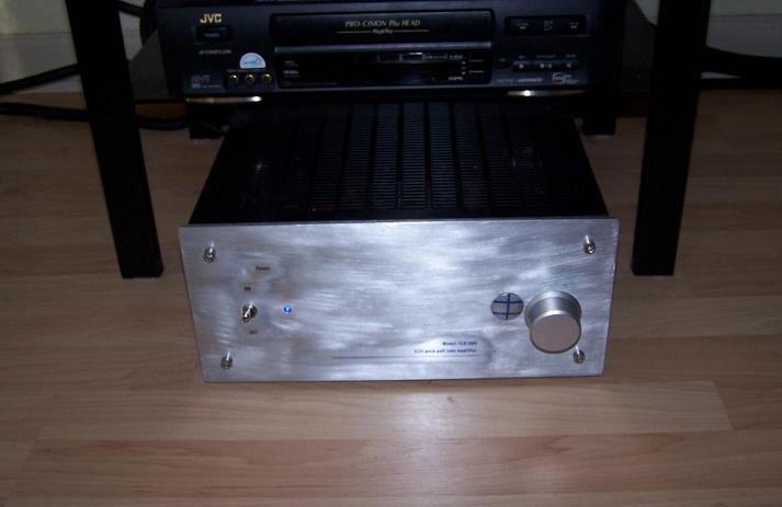

  • lanchile
    lanchile Posts: 560
    edited February 2012
    This is my diy amplifier. Attachment not found.
    Make it simple...Make it better!

  • drselect
    drselect Posts: 664
    lanchile wrote: »
    Sorry you can't make it. Nice looking amp. Sort of looks like the one I have.
    By the way.... "Tube Rule".....:cheesygrin:
