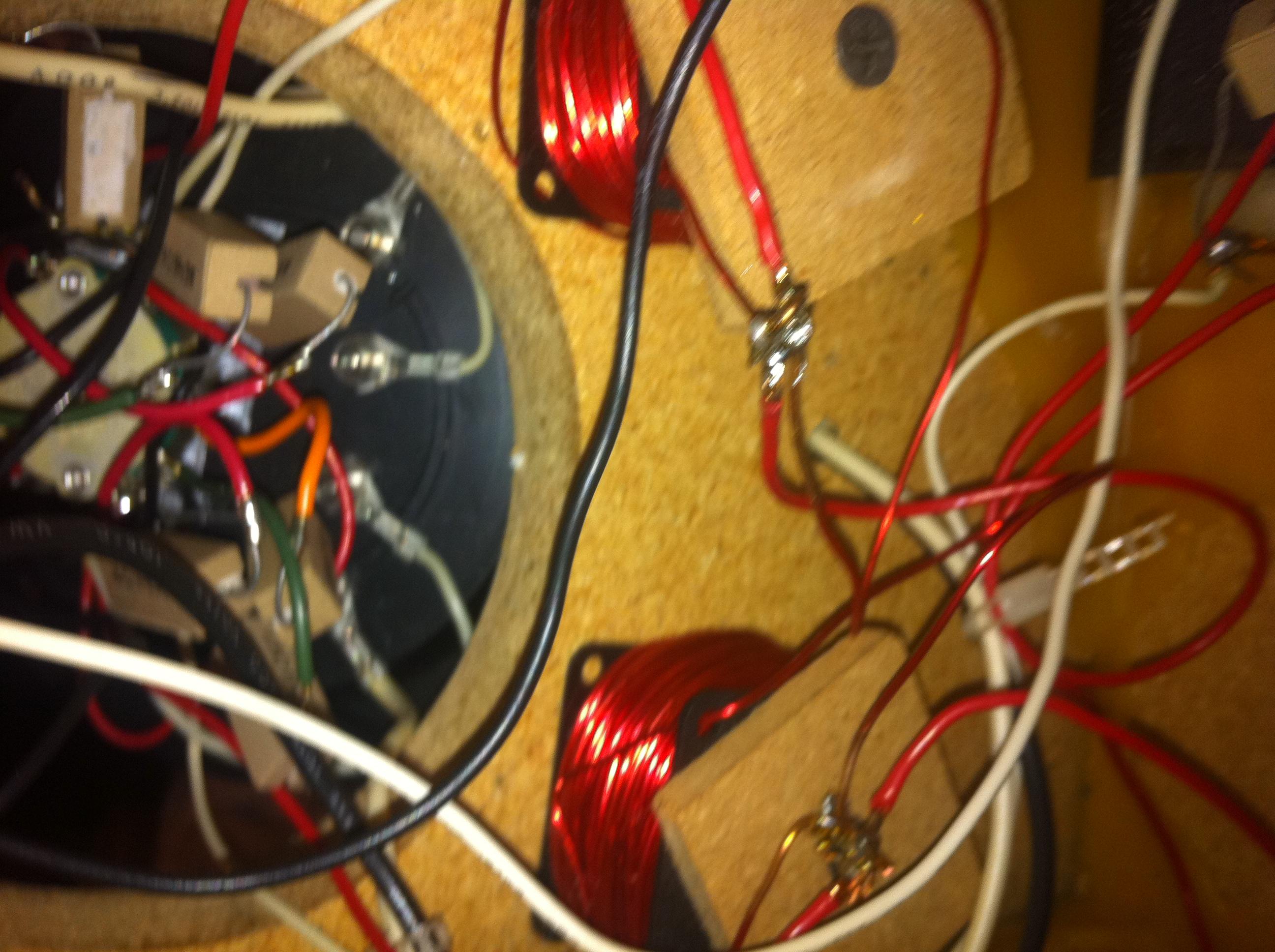

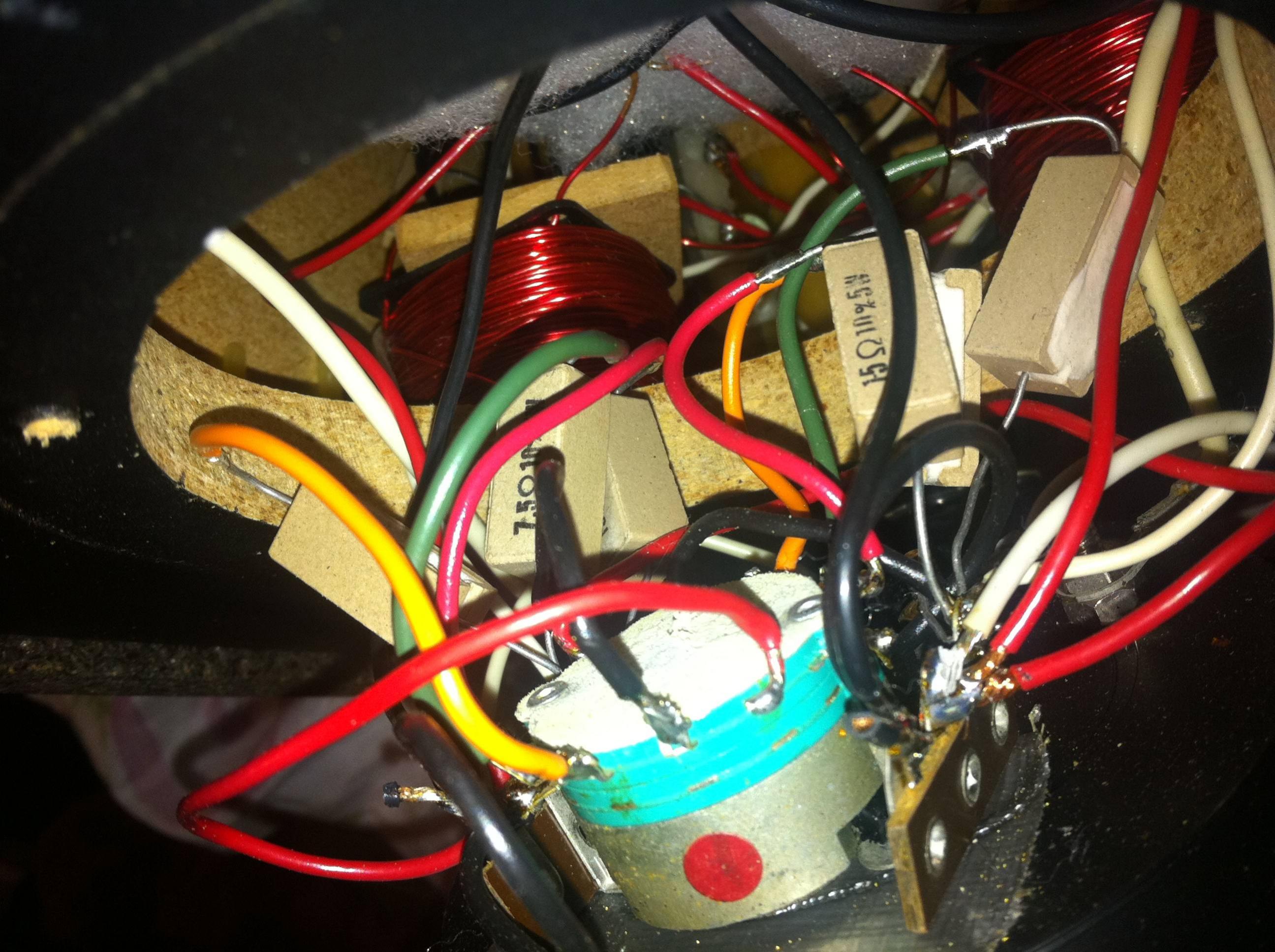

    as promised, the internals of the "SDA" m4s
    #1. pic of the back plate
    #2. inside
    #3. tweeter...definitely different.

    Toolfan66 Posts: 18,158
    edited March 2011
    Thanks!!!! What a mess,it's hard to tell if that it's legit or not. I really thought this was going to be a joke. Now the question is did polk have their hands in this/is this a prototype of some sort??
    Pics of the back of the driver??
    Thanks for posting these,and sorry for the rant above..

    Well let's see...I'm moving soon, so I put them in storage, and I went there and dismantled it on the spot. The driver is sill in storage.
    Don't worry bout the rant, there are hundreds of people putting fake crap online everyday, so I understand the skepticism, and I should have understood your point of view. I was just looking at who I was.
    I really think it's a prototype. This is Polk audio build quality. I owned a pair of 5jr+s for years, and there is nothing to make me think that someone other than Polk built this.

    Wow, do they rattle when you shake 'em? Based on the description of the SDS 400 it definitely sounds like these are a prototype of that model. Too bad there isn't a schematic for them.
