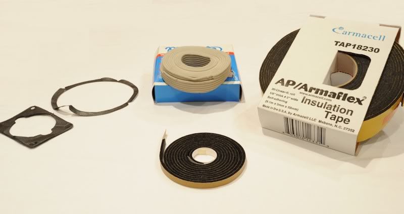

    Just a bit of an update... The combination of Larry's rings and the Armaflex have brought a night and day improvement in the performance of my SDA's. The imaging is so much more focused and the bass digs much deeper. The speakers are more revealing of details that you really had to listen for... almost Maggie-like.:biggrin: The improvements even revealed a driver that was on it's way out. Thank god I have a secret stash of 6510's on hand.
    On one hand, I am happy about that, but on the other, I am being drawn even deeper into the SDA rabbit hole. I guess the Maggies I wanted will have to wait.:mad::wink:

    DK, did you end up ordering the Armaflex from Ace Hardware? Man that looks like a very large quantity!

    audiobilly wrote: »
    Yes, but not directly from Ace's website. I ordered from Ace Hardware Outlet through Amazon.com.
    audiobilly wrote: »
    I have a large quantity of SDA drivers, tweeters and passive radiators.:wink:

    Ok, Armaflex ordered. Now to decide whether to use Mortite or Armaflex. Who would have thought we'd be talking about using window sealant vs. pipe insulation on our SDA's? I love inexpensive mods like this.

    No. I expect it will be sometime during the summer before I try this. I do have the Armacell tape.
    When I get around to doing the Armaflex tape evaluation, I am going to replace the Mortite on one of my identical pairs of CRS+'s and compare it to the Mortited pair. If I hear an improvement, I'll go from there to my other SDA's. :smile:
