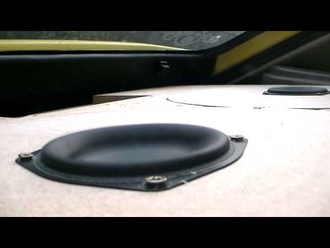

    This thread reminds me of a YouTube experiment where a ported box was built to house 15s in a car's hatch using their TS specs. It was quite large! The builder then fabed adapter plates to fit 4" subs where the 15s once we're. The output and response between the w were surprisingly close... I'll see if I can find it...
    Here we go: https://youtu.be/W5KuSIf78_o
    The other one I could find:
    https://youtu.be/W0QUloqPIyk
