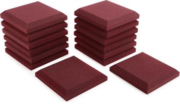

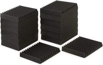

    @ bluefox.
    the room is certainly lively. the handclap resonates to the point of annoyance.
    which auralex foam did you use and how effective were they to tame the treble?
    theres these:
    and
    which walls did you treat?

    edited October 2010
    asmd wrote: »
    @ bluefox.
    I used pyramids. That is a 3rd type. I have a 2x4 at the reflection point on each side wall, two 2x4 panels on the back wall, and a 2x2 on each corner wall extending about 1' above the top of the LSi15s. I had some 2x2 on the ceiling, but took them off.
