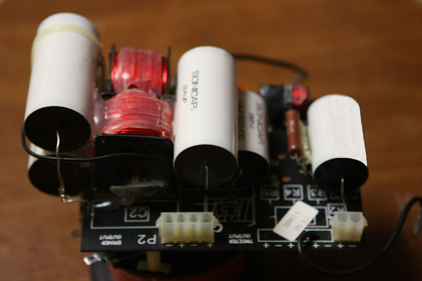

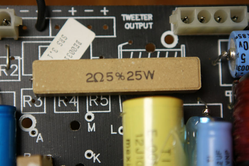

    Ok guys couple of questions,
    First in Ricardo's post:
    http://www.polkaudio.com/forums/showthread.php?t=47929&highlight=crossover
    He used the Mills resistors 2.5 and 2.7 in parallel-(Mills MRA12)
    1)Who or where do I get the resistors? (mills)
    2)When I order caps (sonicap)I guess I should copy Ricardo's formula?
    3)Are those foil caps? I noticed one of the previous 12uf caps says MYLAR... what is mylar? and I suspect that is a lower grade cap? than the new replacement?
    4)Ricardo used a 0.1uF bypass capacitor (Sonicap Platinum) did he run that in paralell with the 12uf in the middle of the board? please use the link and photo's as reference. UPDATE: I read the post again and he stated he REMOVED the bypass cap...now I think Im confused
    :confused:
    BTW also somewhere in one of Headrott's older post of his XO upgrade of the 3.1's he used, and I cant remember the value...:confused:
    5) Headrott used a resistor in place of jumper(s) there is two on this board
    a. why replace jumper wire...?
    b. should I replace both...?
    I appologize for sounding like the nerdy school boy...but remember I am the new resident NewB here!
    Thanks for looking,
    Matt

  • headrott
    headrott Posts: 5,496
    edited September 2010
    Hi again Matt,
    You can get the 12W mills resistors (2.5 ohm and 2.7 ohm) at Sonic Craft along with the Sonicraft capacitors. They are film capacitors but I am not sure anyone knows what type of film they are made from. Any fellow Polkie know? I found nothing about what they are manufactured from (other than a type of film). Mylar film capacitors are typically OK, but not outstanding (in most cases). Mylar is a type of film, made from polyethylene terephthalate (a plastic basically). I don't remember the values of capacitors that Ricardo used, but stick with the original values on the crossover and when you need to combine values (parallel capacitors) you should divide the total capacitance as evenly as possible between the two capacitors.
    It has been decided that you should not use a bypass cap when high quality caps are used to replace the originals.
    As far as me replacing the jumper in the s1 slot with a 0.5 ohm resistor it is a matter of taste and system set up, but I preferred it to only the jumper only. I recommend it, but it's up to your ears.
    I think that covers everthing, but let me know if I missed anything or messed up on something.
    Greg
    F1nut Posts: 51,930
    Parts list, total.
    Caps;
    (4) 12uF
    (2) 24uF
    (2) 55uF
    Resistors;
    (2) 1.3 ohm, 12 watt
    Remove and disgard the 750pF bypass cap. Do not replace with a jumper.
    All parts are available from Sonic Craft

  • Ricardo
    Ricardo Posts: 10,634
    Matt,
    Don't waste your time/money. Forget about the bypass. As you read, I removed mine a few days later.

    Hey all,
    Finshed the mods... I did dynamat, rings, and XO's all at the same time.
    I would like to take this time and my thanks goes out to EVERYONE who was involved. Thanks again for your pics and tips and most of all your support.
    It was a little tricky as Greg (headrott) explained in his post. You almost
    have to "carve" the braces to install the rings. I found it easier to use a dremel
    and to carve away at the braces a little at a time untill the rings fit. The rings
    fit like a glove, I am very impressed with Larry's work on them. I am very pleased with the overall and integrity of this build, the rings allowed me to snug the bolts up real tight. Something that was not possible with the original standard screws that were factory.
    The dynamat was a snap, however it was messy... LOL
    The XO's were not that bad either. Like I stated earlier, I had much help with the other members supplying pics of their builds (Ricardo)
    I had one problem with my cross over which I will post next.
    Thanks for supporting me (Stubby) and especially (F1nut) who gave me the idea of and the confidence to tackle on these upgrades. Much appreciated :D
    Here is some pics of the build(s),
    Matt

  • TrashyTrucker
    TrashyTrucker Posts: 225
    Here are some more pics
    Matt
