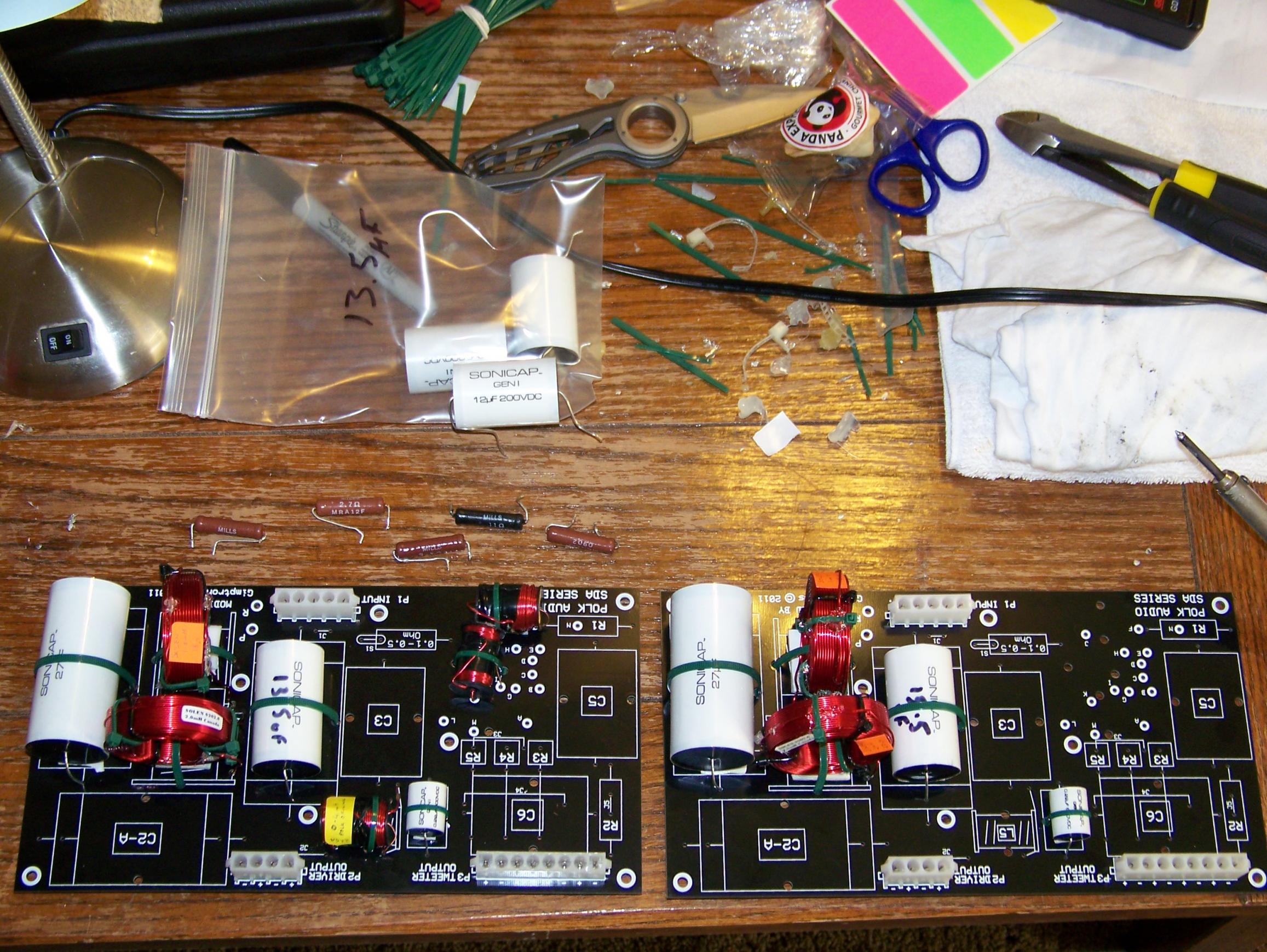

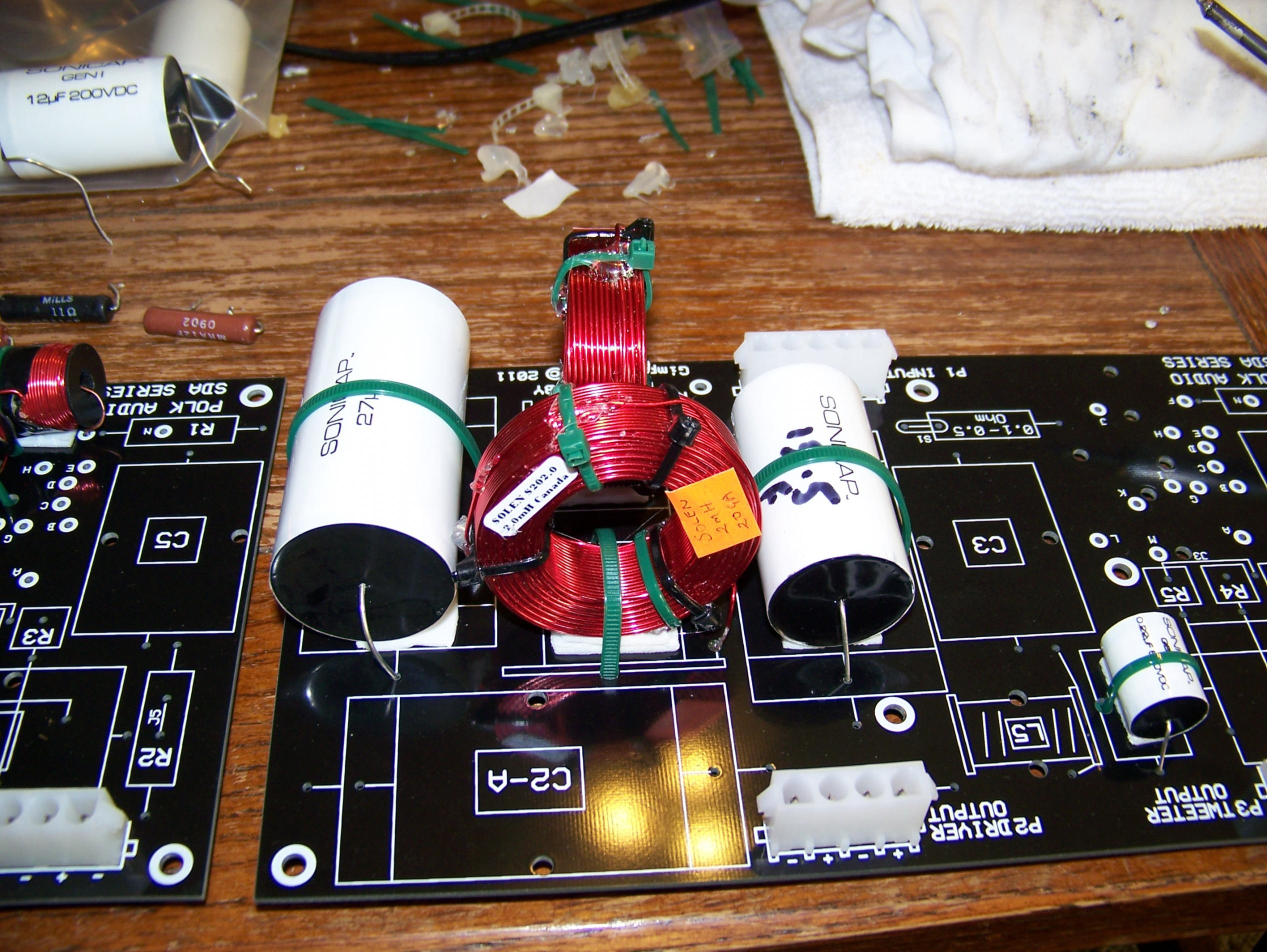

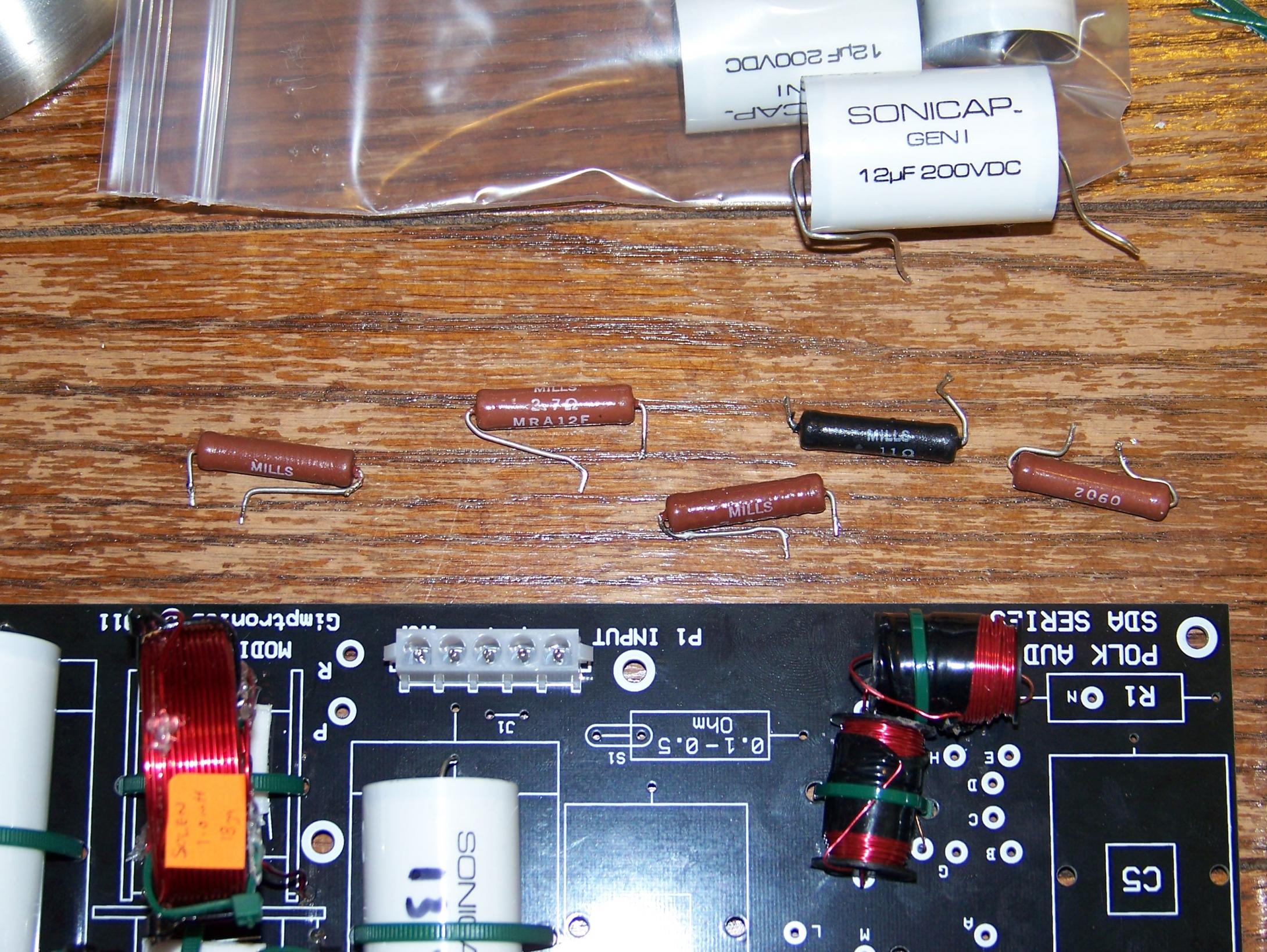

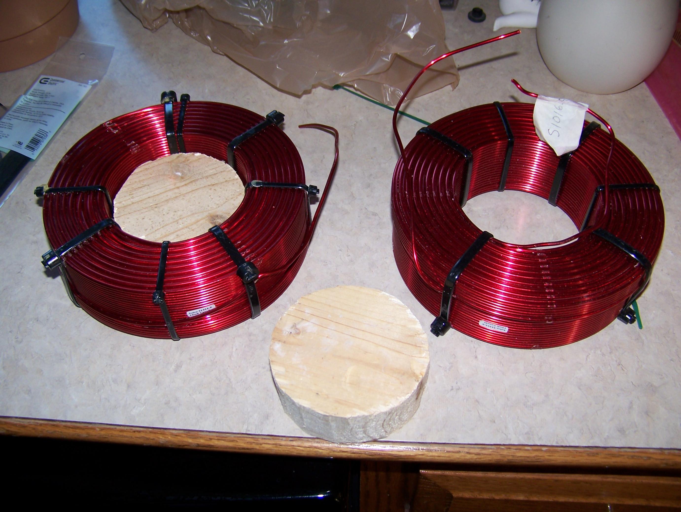

    Got new Sonic caps for the LF section. Got new Solen inductors for the LF section as well.
    Old resistors and caps pulled of the crossovers done by Ben a year ago that will be reused. Doing this one at a time as I would like to be able to tell the difference
    New 10Ga coils and I cut the wooden blocks out of a 2 by 6 with a jig saw. Not pretty but they will work. Did not have a hole saw big enough. Not sure how I will mount them
    Hopefully they will breathe again by this weekend.
