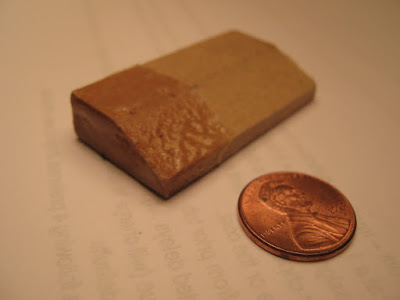

Well, I had the shipping boxes sitting there, and being eager to get them into the recycle bin or on their way back to amazon.com I went ahead and opened up the speaker...
I could tell that whatever it was had fallen to the left-rear corner, close to the back panel where the wire terminals are, so I opened up that panel by removing four screws, and was able to reach in behind the insulation without disconnecting any wires and remove a loose scrap of particle board:
The penny wasn't in there - just in the pic to provide scale :-). Any idea what it is for, and now that it's out, is it a problem? Perhaps it came into the speaker by way of the opening in the back?
Anyway, the speaker seems more than structurally sound, and I'm thinking it's a keeper.

Test the CS10 once more and if you are happy with it, consider it done! I don't believe that small piece of MDF will affect its performance (as long as everything is sturdy).Well, I had the shipping boxes sitting there, and being eager to get them into the recycle bin or on their way back to amazon.com I went ahead and opened up the speaker...

You just removed the speaker's tumor. I think it'll live happily nowSpeaker: LSi 15
