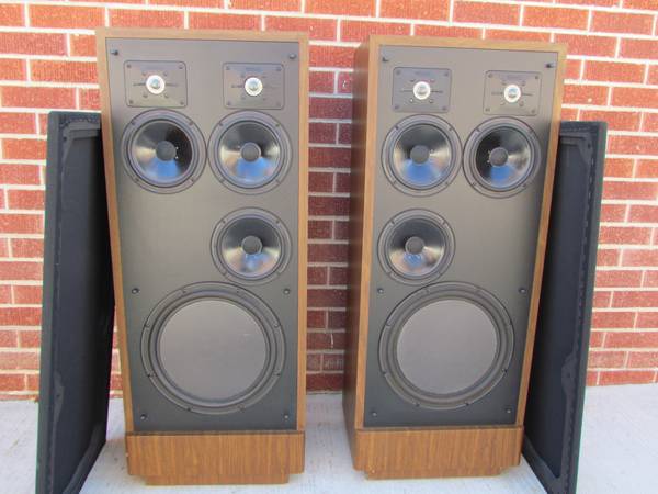

I picked up SDA-2's today.
I posted these here few days ago: http://www.polkaudio.com/forums/showthread.php?134423-Vintage-Monitor-and-Sda-Speaker-Deals&p=2031614&viewfull=1#post2031614
But they were still listed so I had to get them.
I know, I'm a sucker.
They didn't have IC cable but I tested them with a speaker cable and all drivers work fine.
Few knicks and scratches but overall look to be in good condition.
What are DIY methods for b/b IC cable?

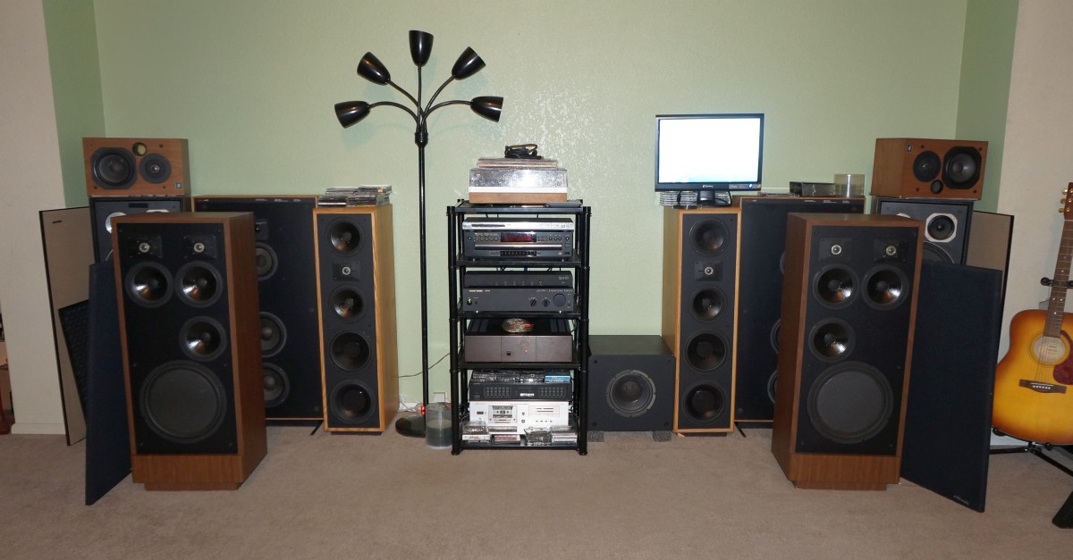

Looks like you have some speaker placement issues going on.... but the IC cable depends on $, speakon representing doing it right the 1st time or cheaper alternative with good results from PE. Would second the dimensional tweeter removal.

Yes, they look crowded but SDA's are well in front of them without anything in between.
Few pairs from that crowd are/will be up for sale so they'll have to fit tightly until something sells.

I am just trying these out of curiosity as I never had this model with two tweeters and 3 mids.
I had couple pair of 2B's before.
I'd do speakon if I decide to keep these so b/b cable will do for now.
Curious as to why you would disconnect the dimensional tweeters?
Polk discovered that the dimensional tweeters detracted from the overall sq. All SDAs after the 2nd generation had either a single tweeter, or multiple, vertical tweeters in a progressive point source arrangement wired to the stereo circuit only. All dimensional tweeters were eliminated.Commander7716 wrote: »Curious as to why you would disconnect the dimensional tweeters?Home Theater/2 Channel:
