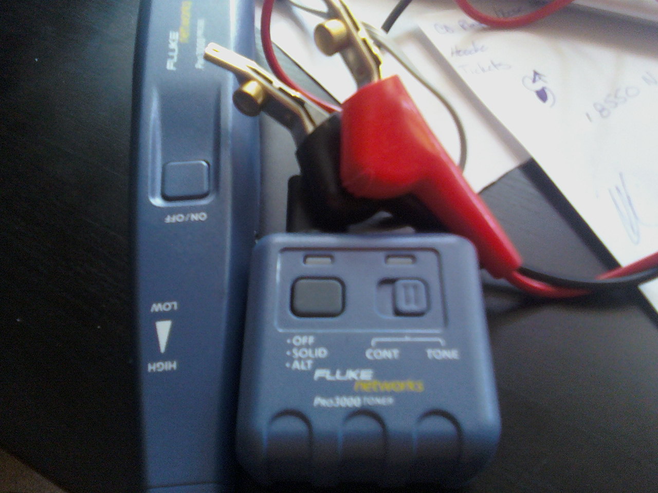

    it's like $90 at home depot use it for what you need and return it.
    if you have and idea where the wires are connect the aligator clips to the exposed wire (stripped ends) press the button for a solid tone or an alternating tone walk over to where the wire might be use the wand to sniff it out around the area. you will here the tone it will be louder when your closest to the wire it is actually really simple
    sorry it is a little blurry. cell phone :)
    you'll be able to narrow it down to which studs the wire is between then when you cut your hole for the speaker you just reach in and grab it
