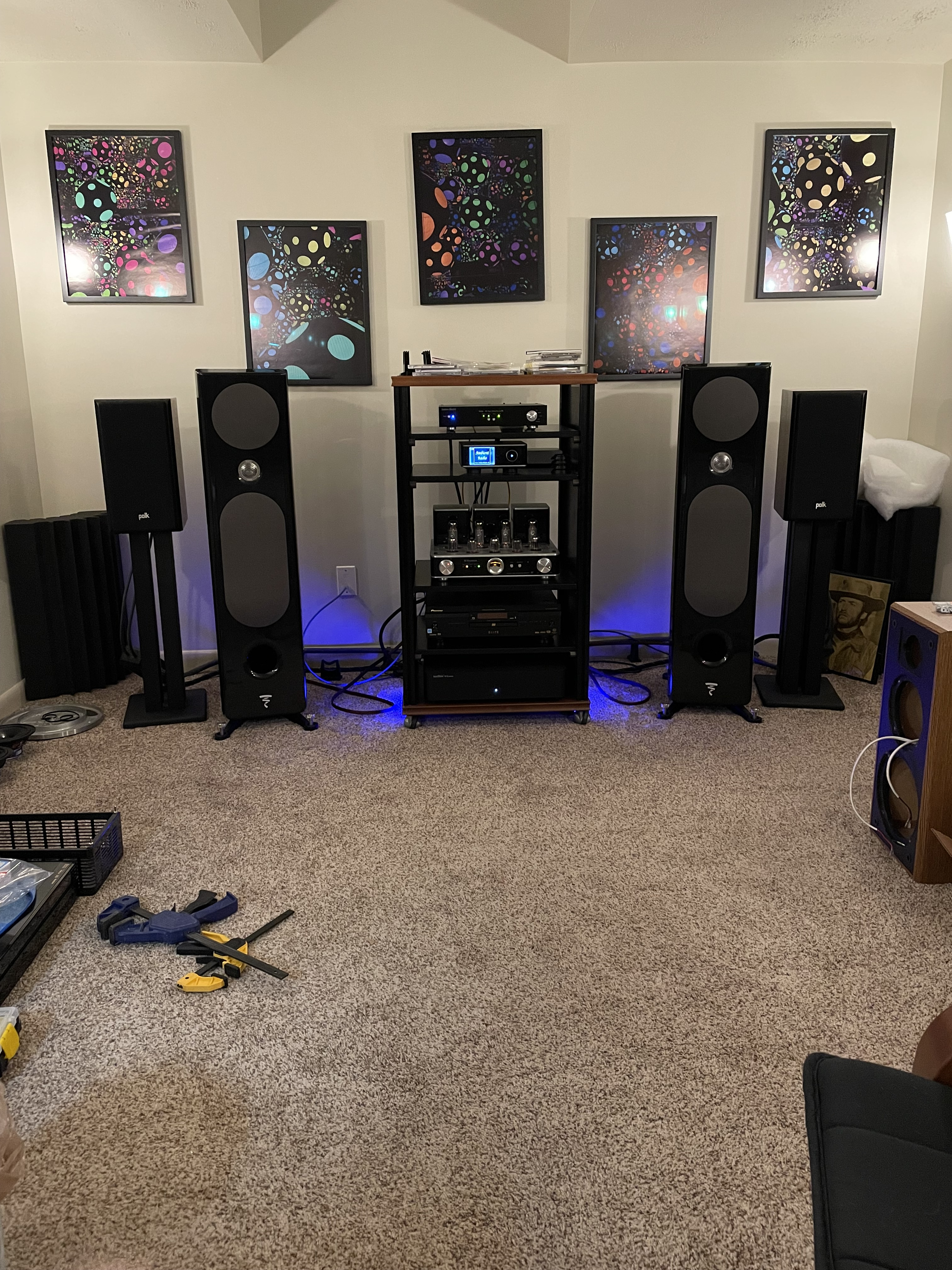

I was able to move them in a well padded wheel barrow down a hill and into the basement without killing myself. Forget about lifting them up and down stairs unless you have a Schwartzenegger physique, which I no longer do. I plan on doing some serious listening this weekend.
Here is a pic:

Ill get some naked pics of them up soon. I will say moving them forward just 3 or 4 inches made a huge difference in the boominess. Also, these are a very tight, direct sound. Im am grateful for carpeted room at this point. Gobs of detail in acoustical guitar and Mick's voice fer sur.
