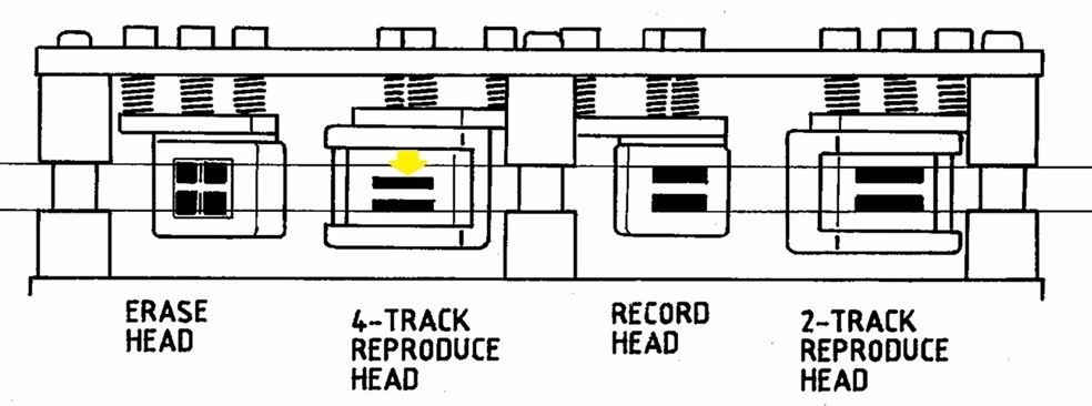

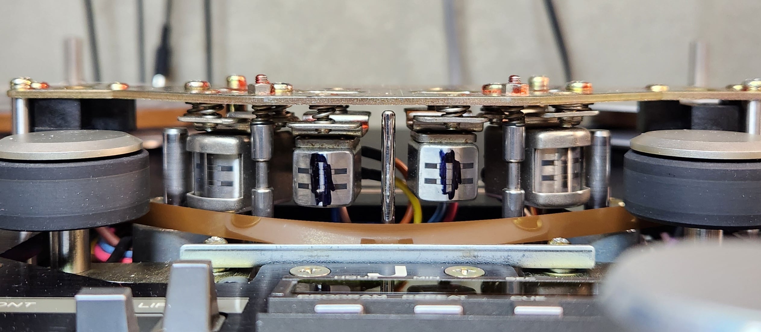

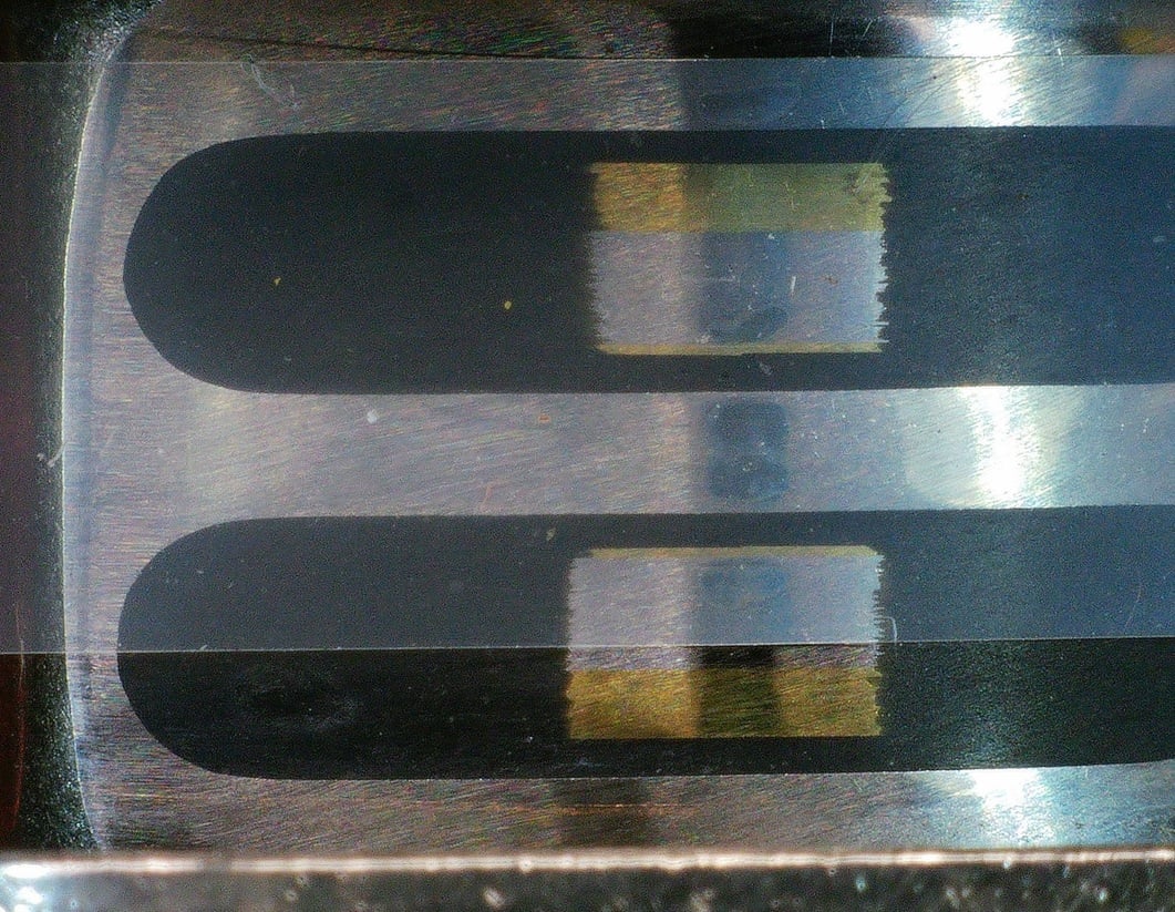

I finally scored a reasonably priced Otari MX-5050 BII-2 head block with 4T playback head. This was standard on a BII but optional on a BIII. It will plug right into a BIII-2 deck. I’ve seen them sell for $300-$500. I got this one for $221 shipped. Heads are worn but not worn out. They do need lapping before installing and aligning on a different deck. This option will slightly increase the value of deck and make it a bit more desirable to a buyer as you can play 4T track tapes on a 2T deck but not record 4T.
BII block above mine. Since my heads have little wear I may just remove the fixed guide, move the erase head to end, align, lap and install 4T playback head/align on mine. That way I won't have to calibrate deck to different 2T heads. The 4T head runs with the 2T calibration. I would need~ $1,000 in MRL calibration tapes to calibrate deck. (One 3.75, two 7.5 NAB/IEC EQ, two 15IPS tapes NAB/IEC EQ).
Top block from L to R, 2T reproduce, 2T record, 4T reproduce, erase.

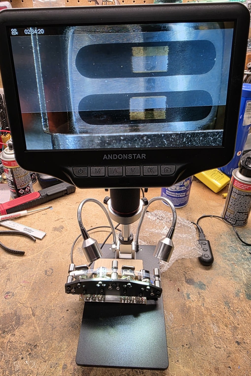

It takes some effort to arrange lighting to take a really good pic of head that shows wear without glare, especially with shields shrouding repro heads, so just the 2T record head from the ebay block is shown. The other two are similarly worn.

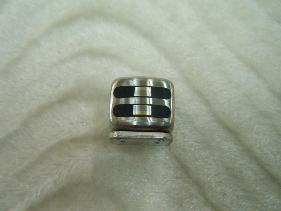

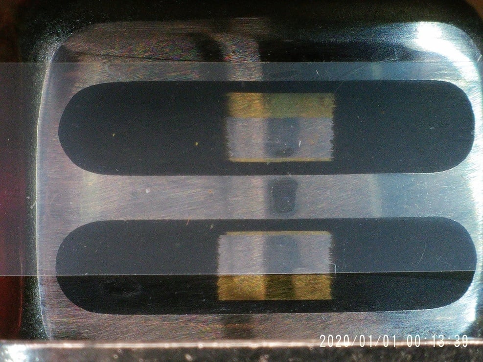

I lapped the worn heads and the 2T reproduce and 2T record came out nice. You have to rotate the head while dragging on sandpaper to maintain head profile. I have a sloped board I place across laundry tub and run water on wet dry sandpaper sitting on thick piece of flat glass while lapping.
The 4T reproduce went open gap. This can happen with worn heads. Sometimes they wear into open gap or you find it when you remove material to get rid of wear groove by lapping. If you ever buy used heads, get good pics. Many sellers do not take good, detailed pics of heads.
My options are gamble by purchasing a used head that will fit and lap it. Technics RS 1500 and Pioneer RT 909 heads are similar mounting and will work. Otari 4T heads are scarce. There is a seller on ebay that offers a new head for Pioneer that fits Otari. It’s a 4T core in a 2T body for $200.
I consulted with an Otari specialist, and he said just about any 4T playback head that will fit will work. It’s the record heads that are touchy. I have some lapped Teac X-1000r play heads here, won’t cost me anything. Comparing inductance, the Otari 4T head measured ~ 450mH while the Teac is 550mH. Trouble with the Teac head is different mounting screw location and they are slightly wider spaced.
The heads need to be positioned at the correct height or you’ll lift the tape off adjacent heads, the 2T record and erase head in this case or be too low for tape to contact head.
I told my best layout man to lay of the coffee and mark and dill new holes in the head mount bracket. The holes cannot be too big as they are secured with 2mm x 5mm screws so proper placement a must. I clamped the heads together tape contact side down and marked the mounting difference on the Otari head. I measured the difference, center punched and drilled new holes in the head bracket.
Luck is where preparation meets opportunity… I did good. Next up mount the head on block, align head with clear leader tape, plug it into deck and run calibration tones for azimuth. They make head height tapes for really fine tuning. Typical calibration tapes are full track where a head height tape just has separate tracks.

I decided to purchase a new 4T playback head for my BIII-2 head block 'add a 4T play head' instead of adapting one to it. $236 shipped. Other option is taking a chance on used head, and some sellers ask near or same money as the new one. Staying with my BIII head block with slightly worn heads means I don't have to recalibrate the deck to different heads. Lapping/thinning heads can reduce or eliminate high frequency response. Recalibration would be pricey as I don't have the 15ips NAB/IEC and 7.5isp IEC calibration tapes needed.
Back in 2018 a Tapeheads user by the name of Twinimage offered some newly manufactured 4T heads for Pioneer RT 909/707/701 and Otari. They share similar specs and mounting. They are sold on ebay through his wife's ebay account, sewing-pro. Occasionally they offer 2T play and record heads for Technics RS and Otari. Twinimage must be Roman Sokolov of Electronic Engineers, an analog audio repair shop in Chicago.
In one ad the description reads the heads were made by the last company that supplied heads to Otari. Otari manufactured decks up to 2007 IIRC. For 4T heads, they stuff a smaller lamination in a 2T body.
They said align edge of tape with copper laminations. At first, I chose the wrong side edge and it didn't sound very good.... Part of my error was due to following the alignment image in service manual. Tape edge should be aligned with opposite or left channel/mount side of 4T head. Image from Otari BII-2 SM. The 4T play head with 2T/4T play switch was standard on the BII 2T head block, optional and rarely found on the BIII 2T decks.
I remembered my Andonstar AD407 USB microscope sitting covered on shelf. I've used this for TT stylus inspection. It has a micro SD slot. Attaching tape guides to head block makes initial tape edge alignment easier than aligning on the deck.
This makes it so much easier. Head needs to be moved. I can snap pics or make a movie with this thing. Image from microscope.
Much better. I need to set correct date or shut timestamp off..... Next up FR or frequency response tests to see and hear how it compares to 2T playback head. The 4T head runs on the 2T head calibration.
This head block is from a different deck, but I'll use the Sharpie test to verify a good tape wrap on the heads. Apply Sharpie (or grease pencil), run an old tape and check wear pattern.

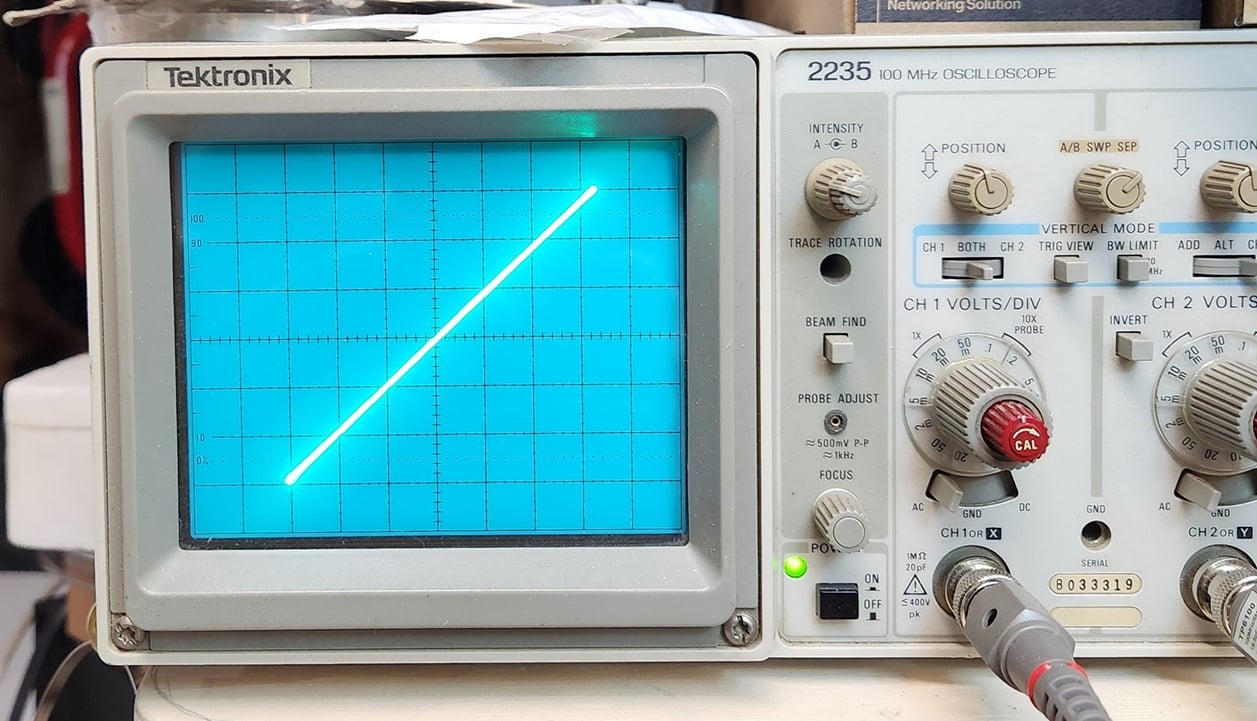

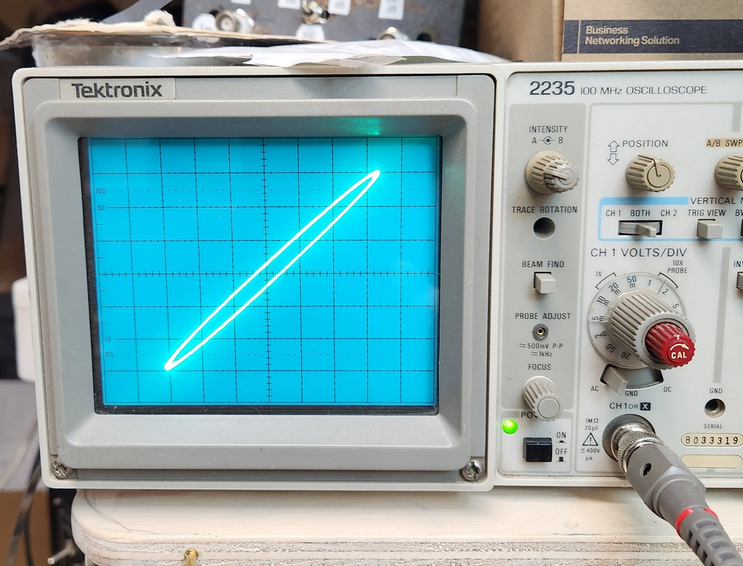

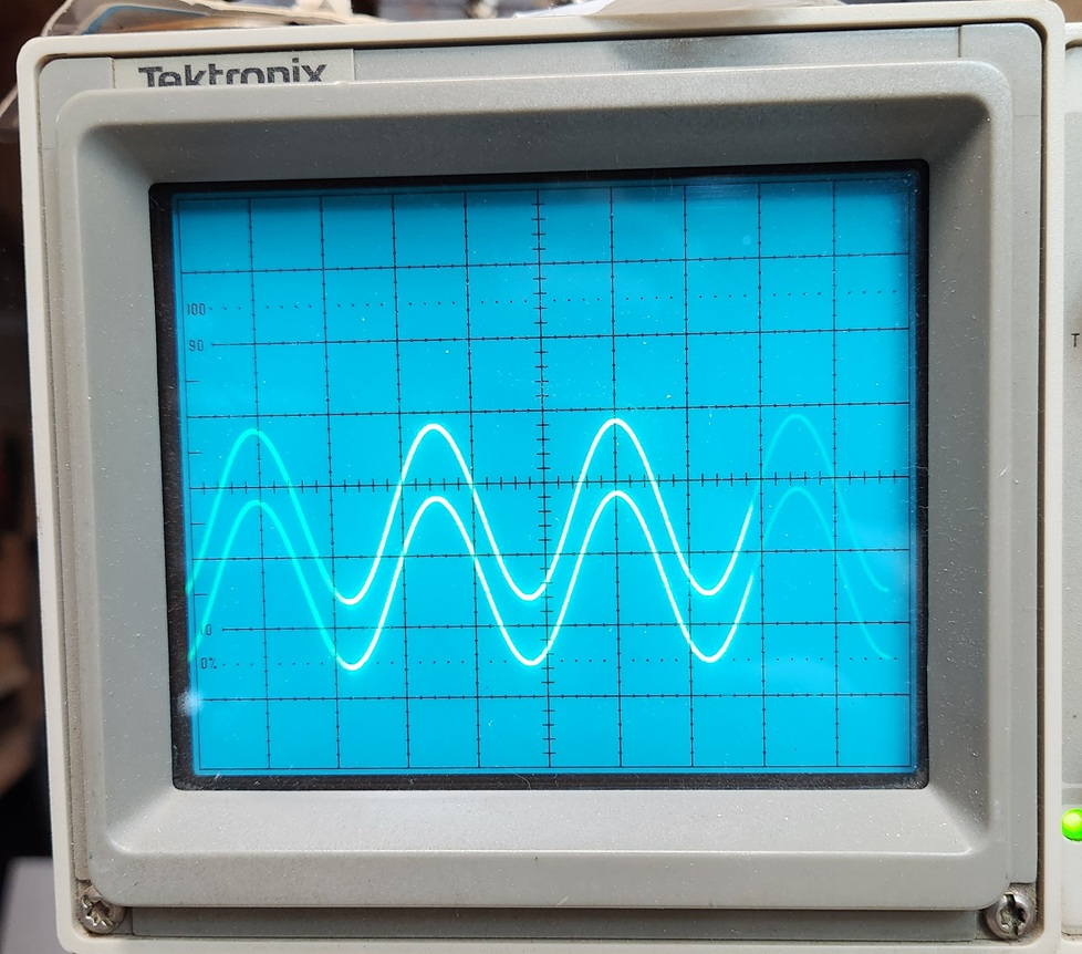

The other adjustment is azimuth done with a calibration tape and oscilloscope. The old way suggested in service manuals was Lissajous, scope set to X-Y mode to get that flat 45 degree line. I now use what some techs prefer, two channel mode and comparing R and L channels.
