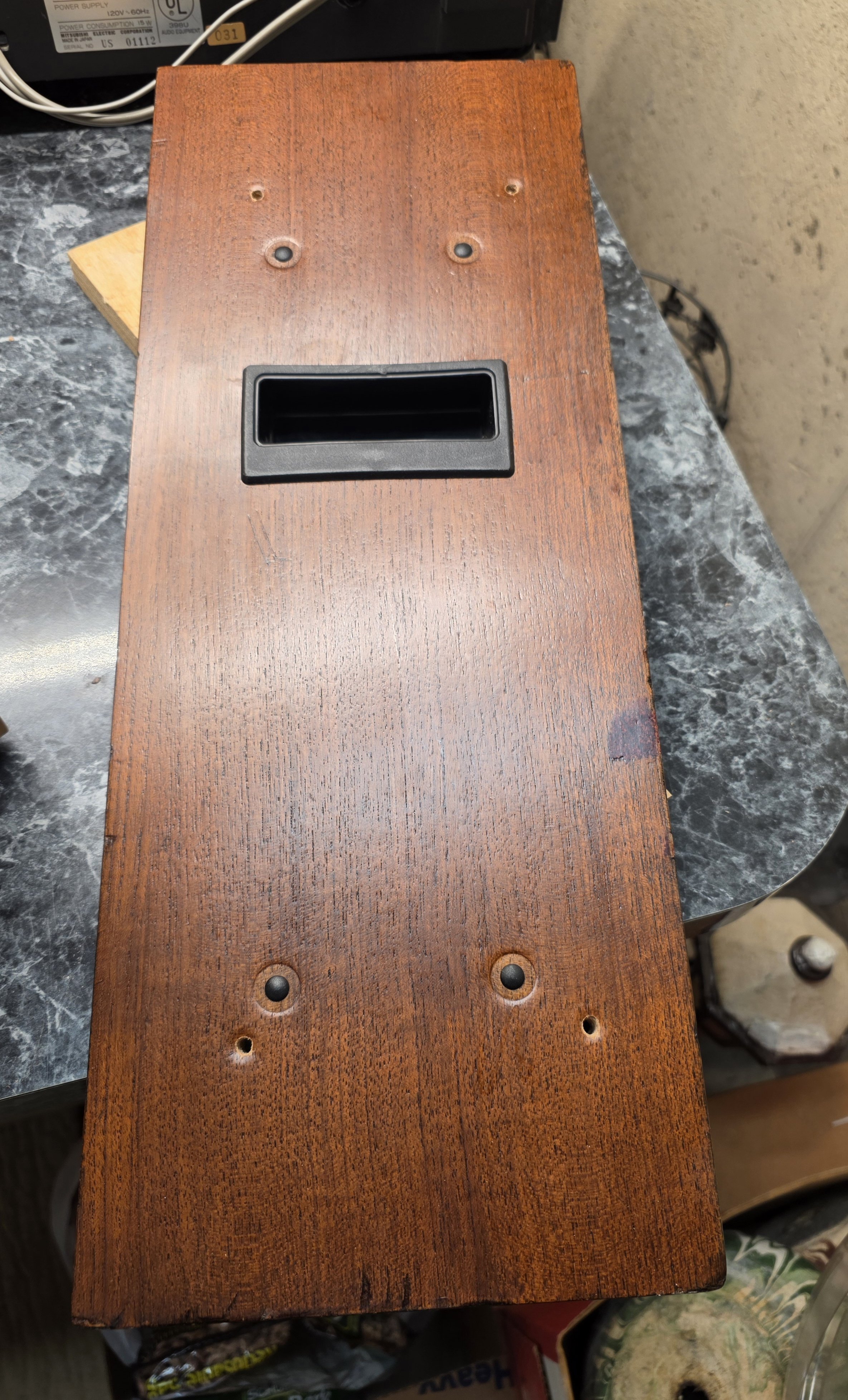

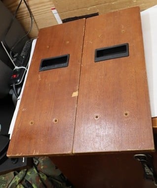

    While it was in isolation I bought some inexpensive wood sides for a MX5050. They were rough, Aaron called them firewood. I did a half fast repair on them only to find mounting holes don't match up. Handles were removed to repair them. I sure wouldn't lift it with my fingers in them shallow pockets.

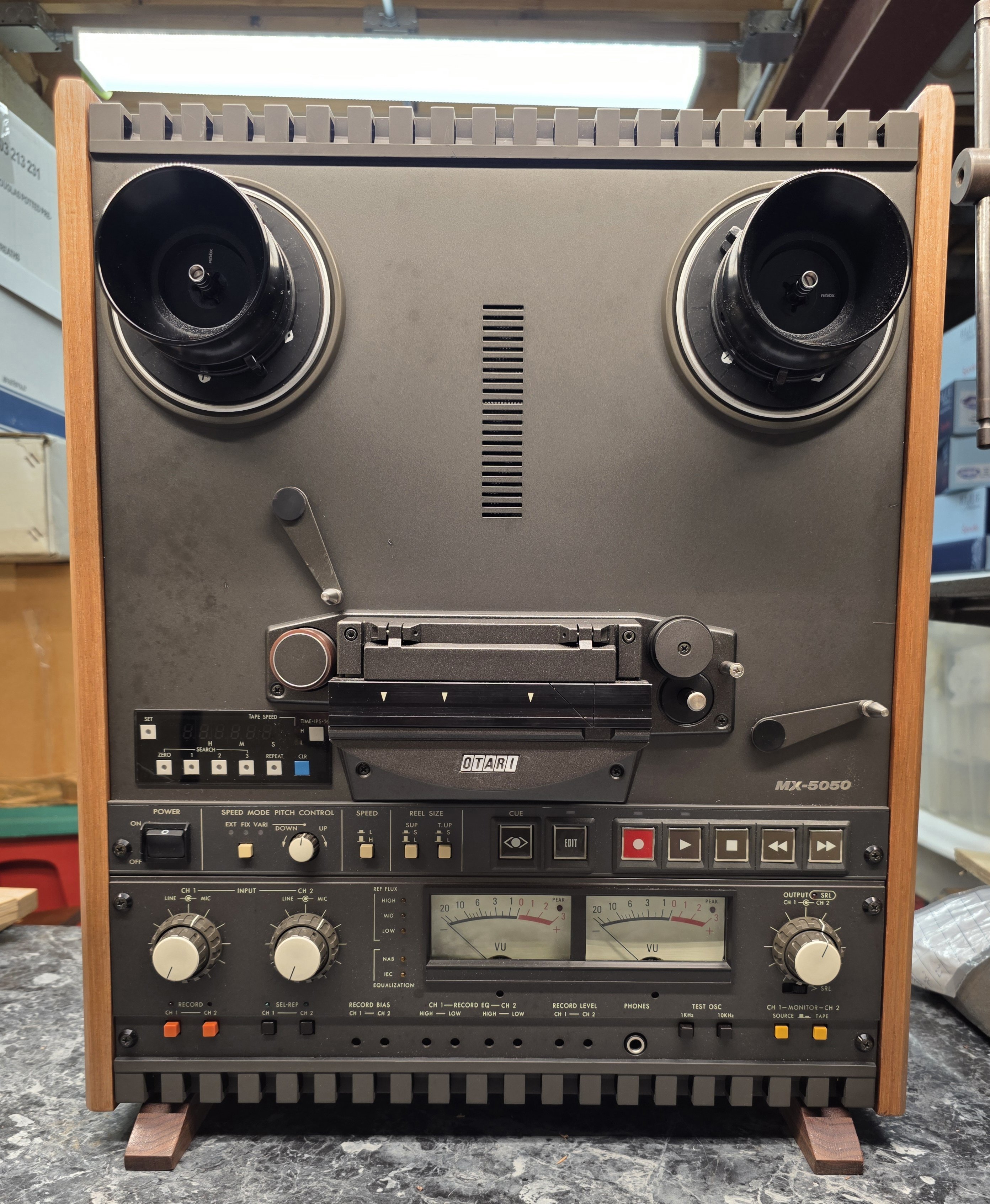

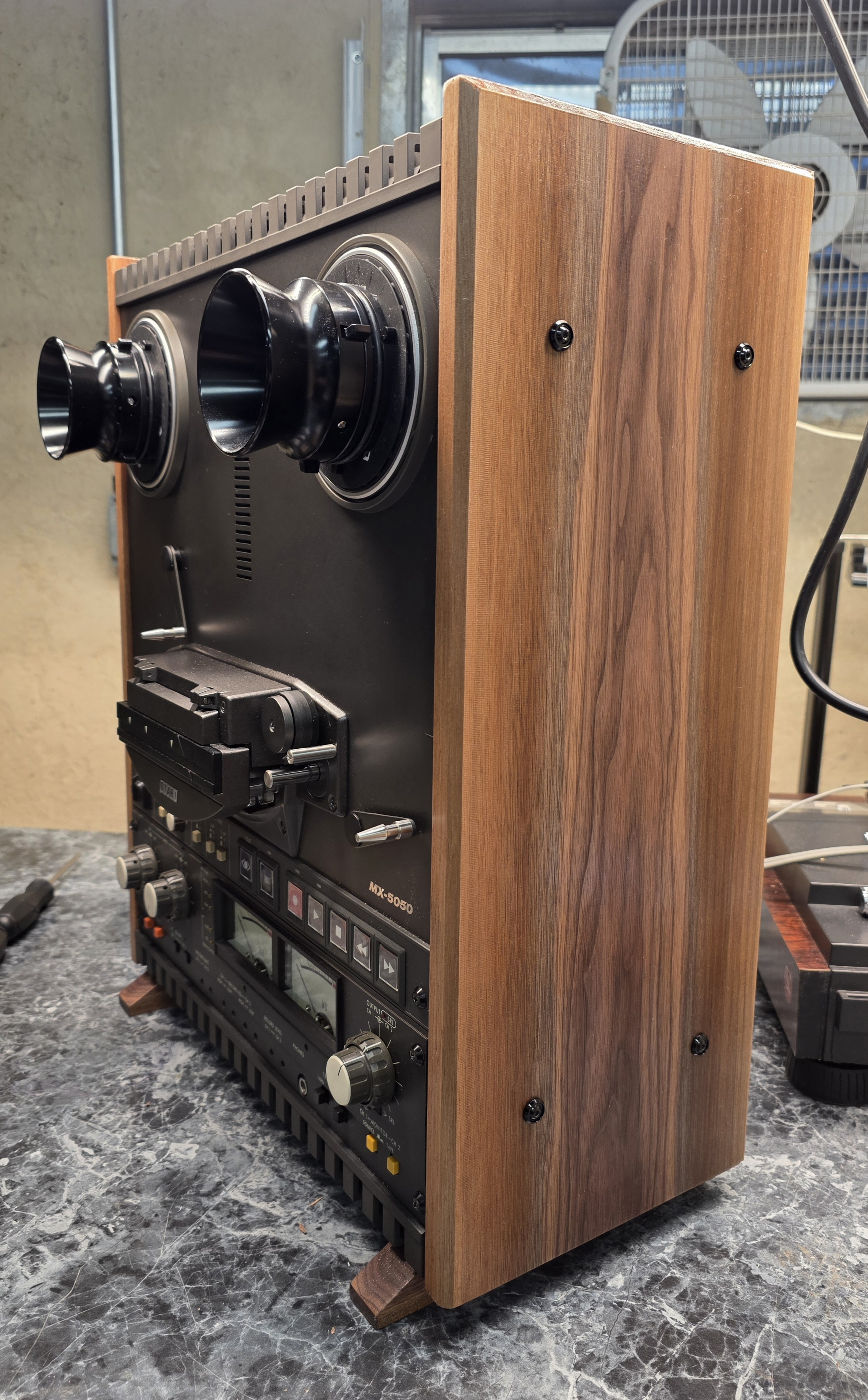

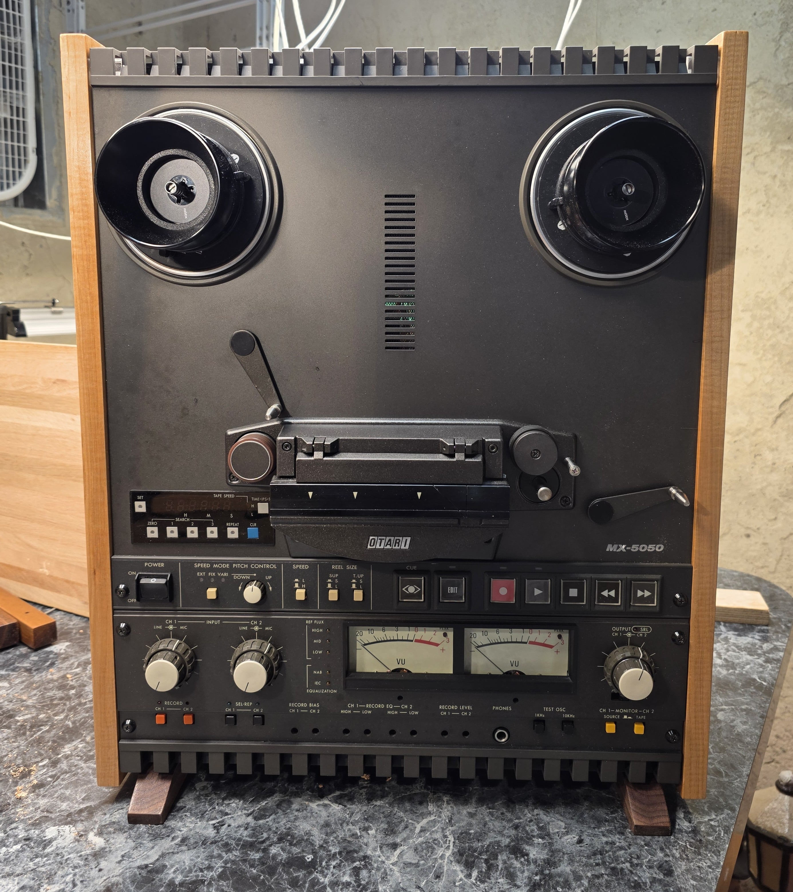

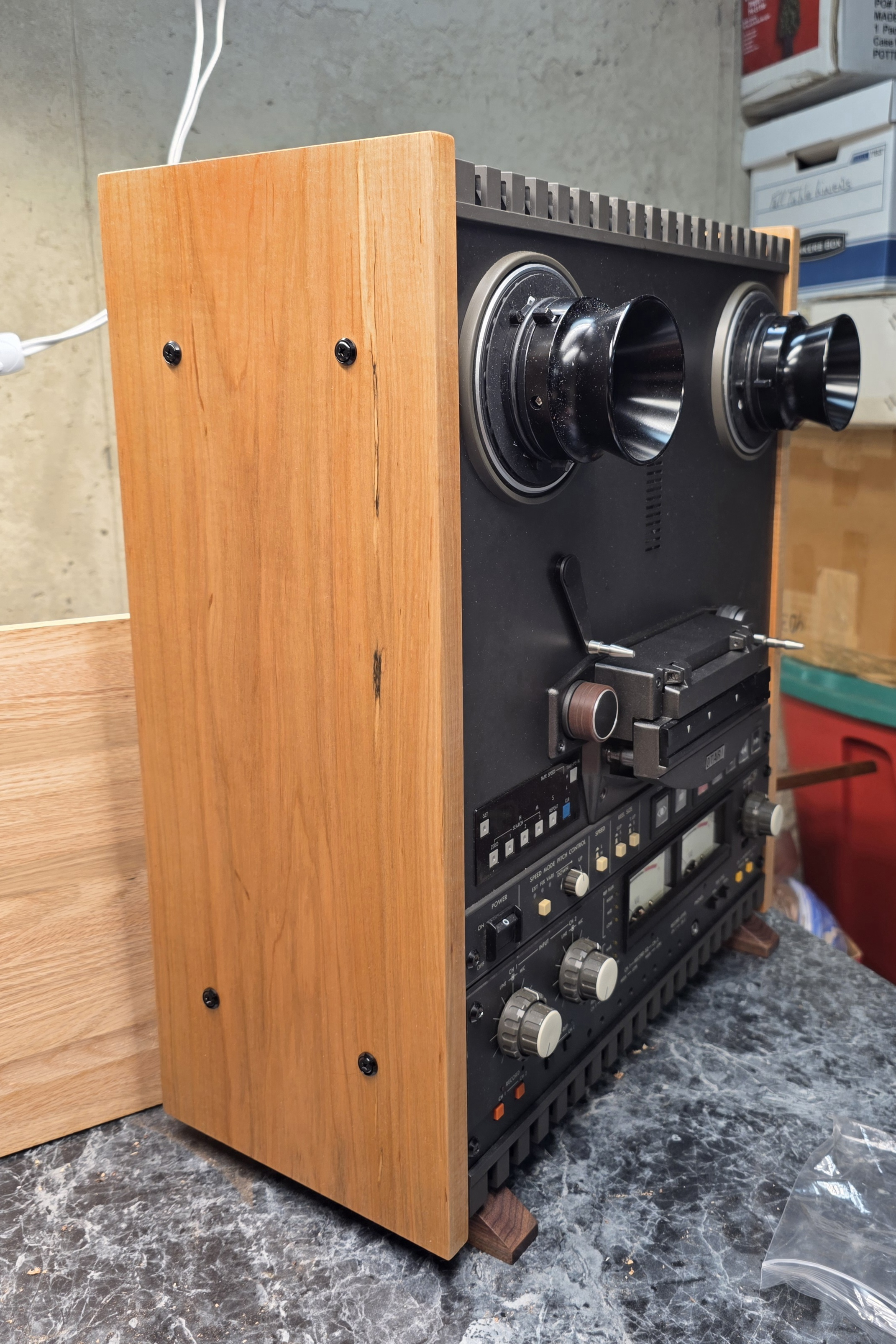

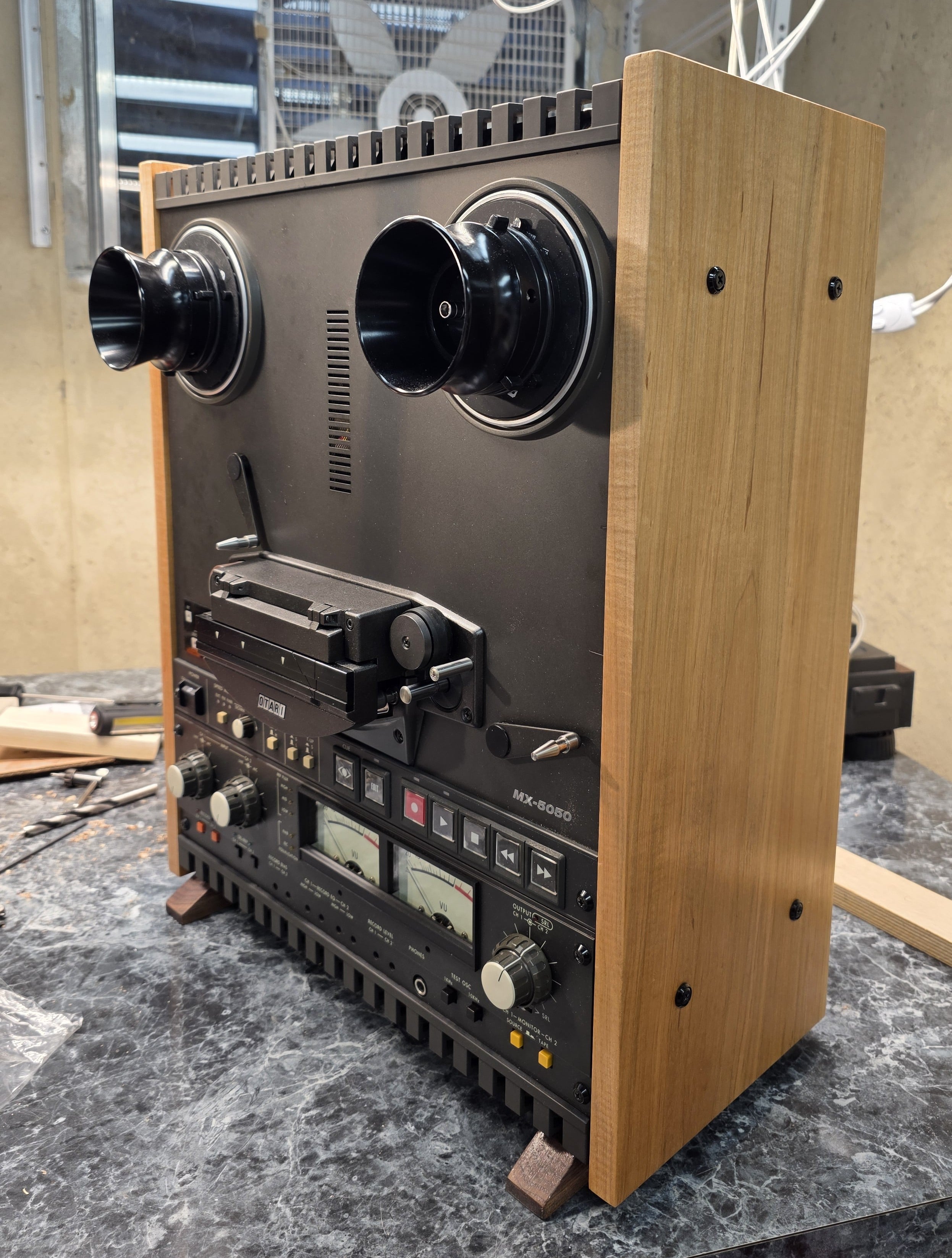

    Aaron had a week off and said pick a day go to the tree farm to make some nice side panels for the Otari MX-5050. It’s a long day at ~1:30 to Aaron and then another hour to the farm plus working the rough-cut wood.
    Everyone seems to do dark wood for Otari sides so we chose some Cherry along with some nice Walnut. The chunk of Cherry I brought back to make matching footers didn’t make it through the planer so that's on the to do list. The Walnut sides are still in stages of finishing.

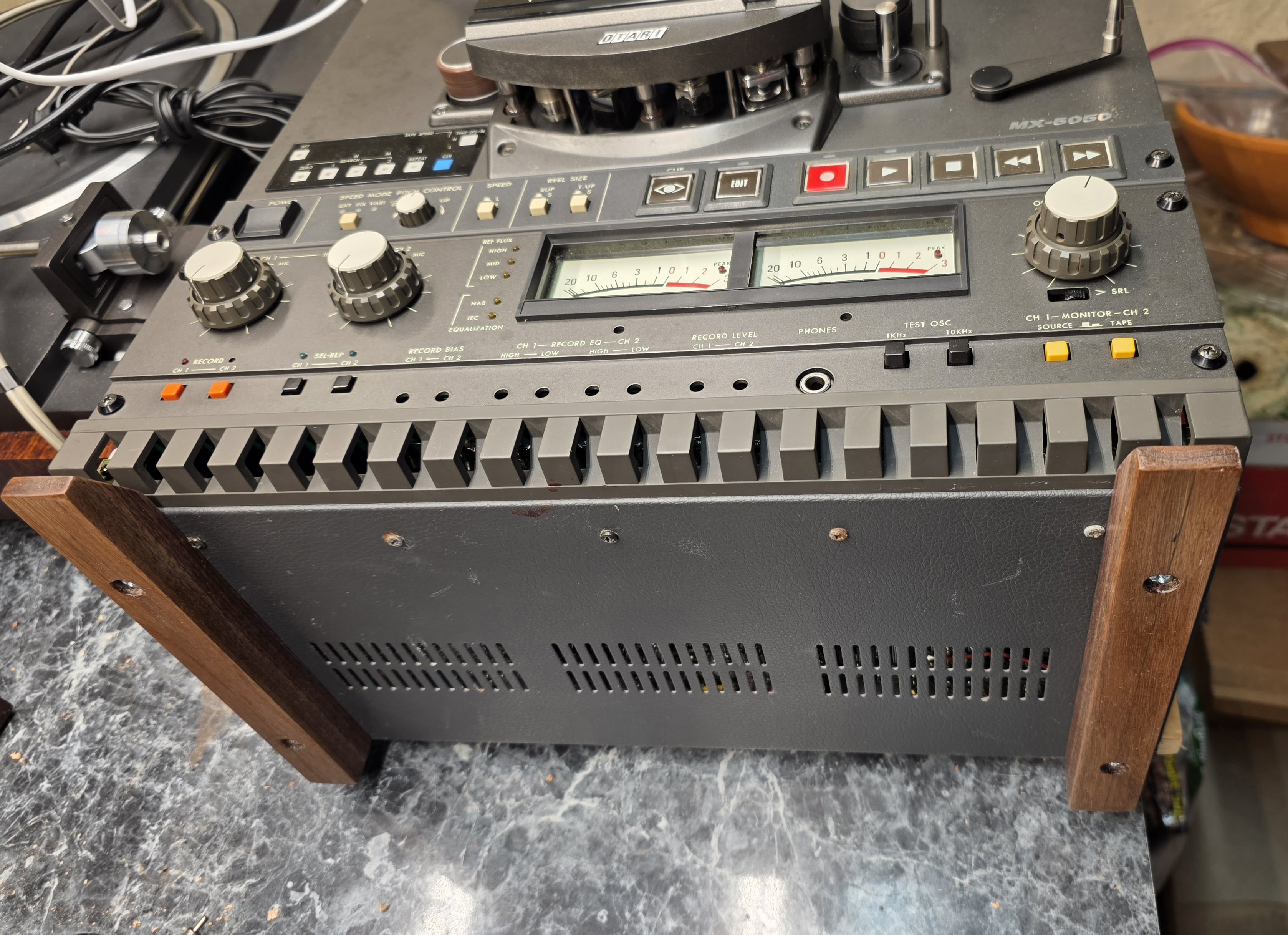

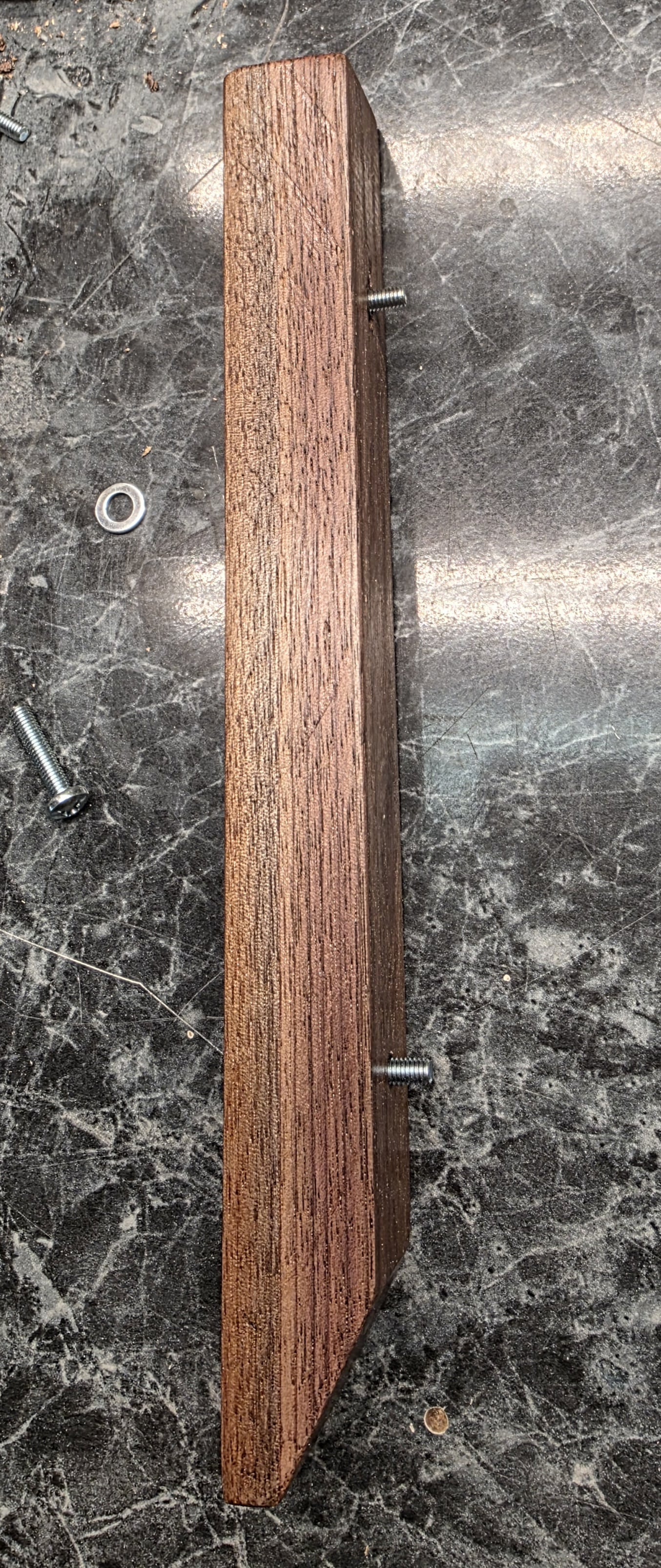

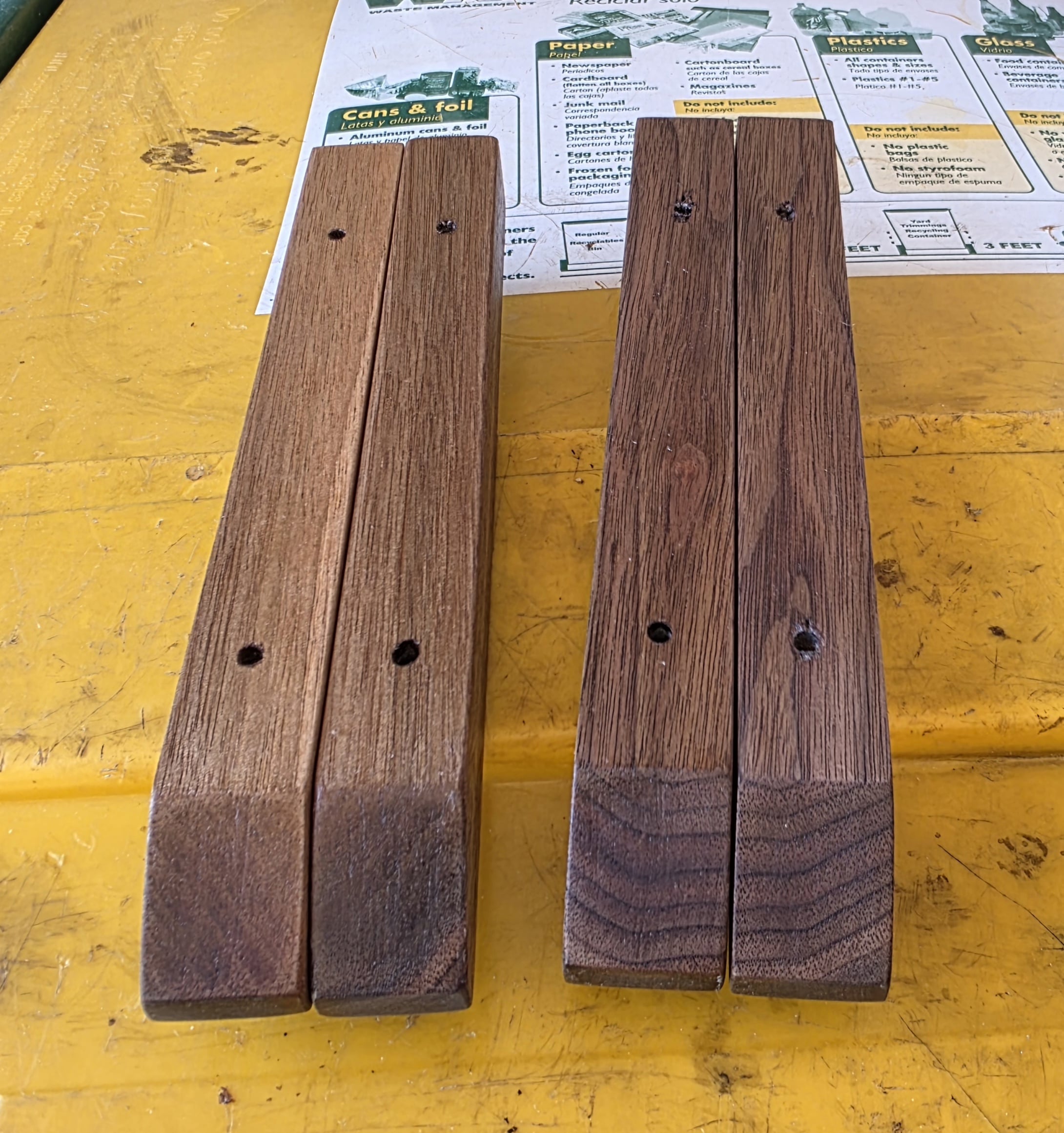

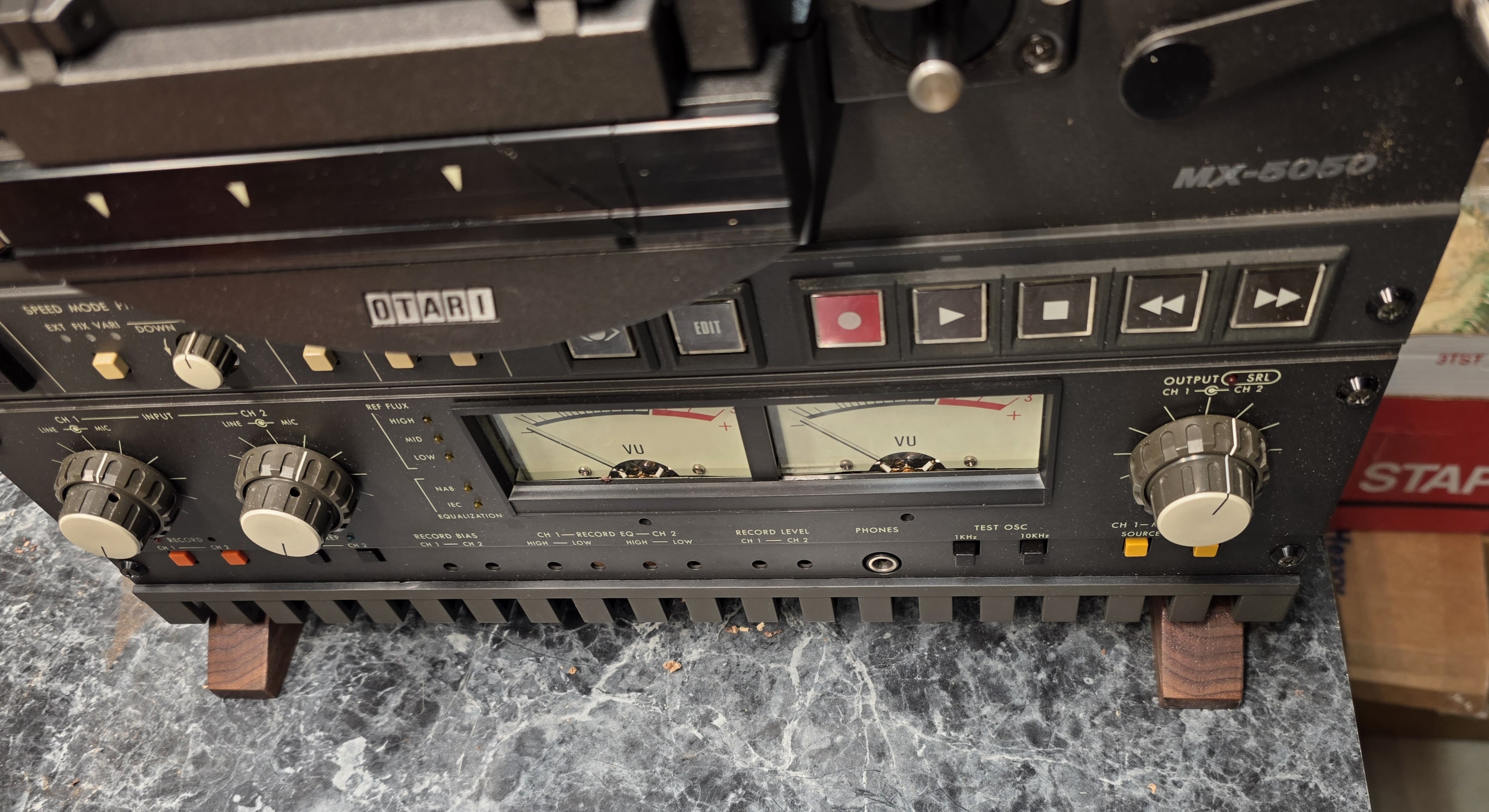

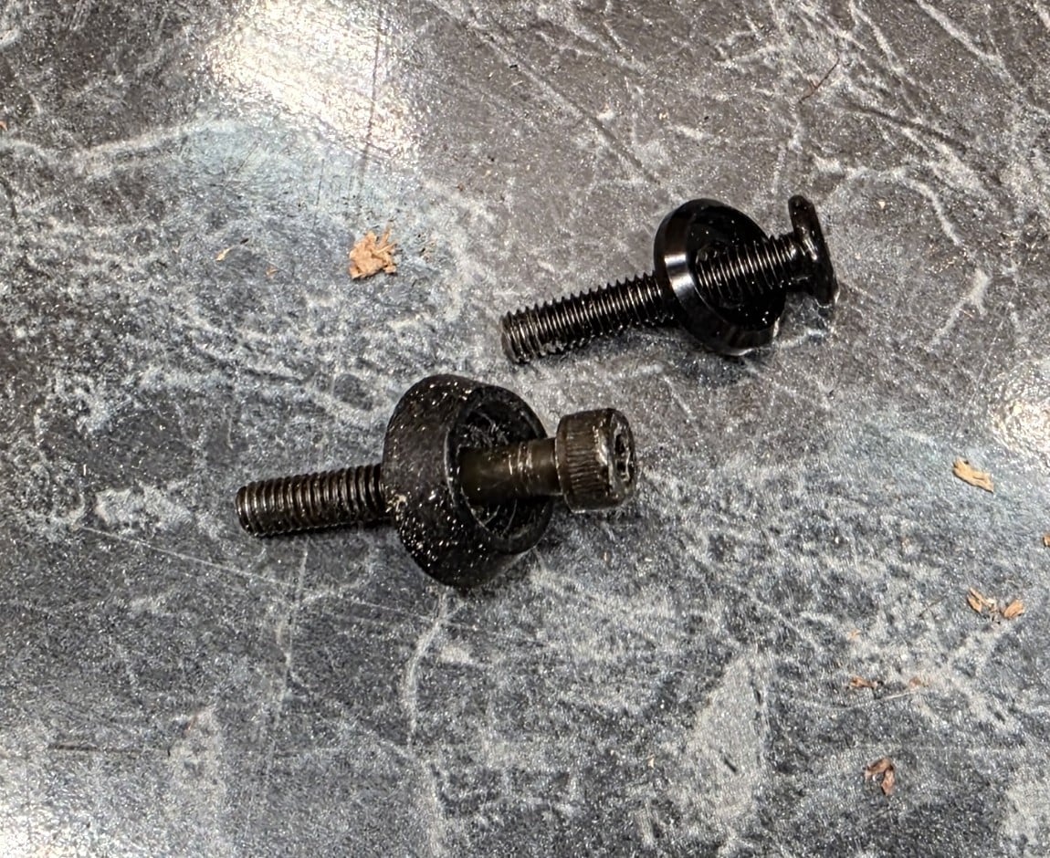

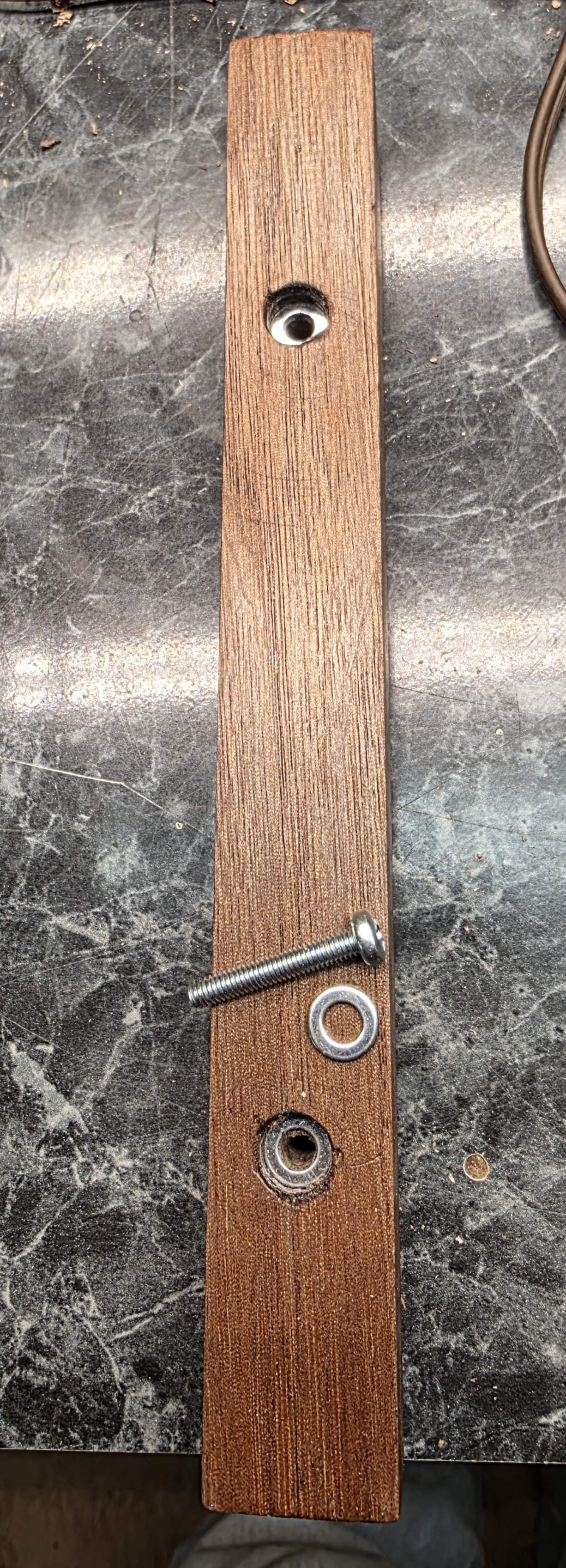

    This deck came with rack mounts and had no footers. They sell reproduction plastic footers on ebay. I’ve seen 3D printed and ones machined from Delrin. Cost ~ $60 to $70. Some offer wood footers which look a bit nicer. These were made to exact length of 8.66 though I chose to make them a bit thicker (15/16”) than original. This deck weighs 62 pounds and the last thing you want is setting it down with your fingers under the side panels with thin footers.

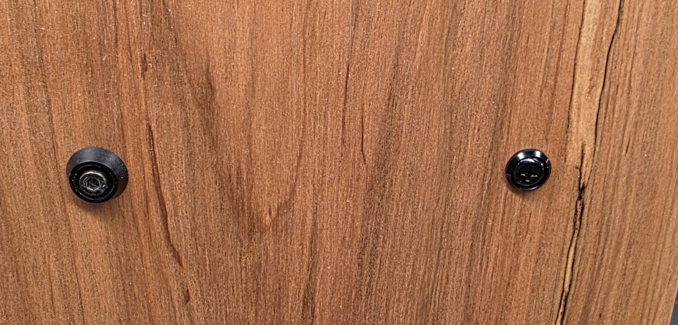

    Mount screws were countersunk and I installed metal washers to keep the narrower screw head from burrowing into the footer.
    Plenty of screw thread engagement in base of deck.
    The original footers were extended past the front of deck as it is front heavy. I’ve seen guys just have round footers on the bottom, but one accidental bump can send it falling on its face.
    Instead of the original Allen head screws and cone cup washers (which are plastic) I chose some nicer looking aluminum shoulder washers and flat head M4 black stainless screws for a nicer finished look. I have some Allen head on the way to replace the Phillips head.
    So long to the "firewood sides" as Aaron called them before I did some half fast repairs. They were purchased while the deck was in bagged isolation and were slightly smaller and not for a MX-5050 as advertised, but I drilled holes to make them fit. They were much better for carrying the deck around than the metal rack mounts. I opted for no carry handles in any of the new wood sides.

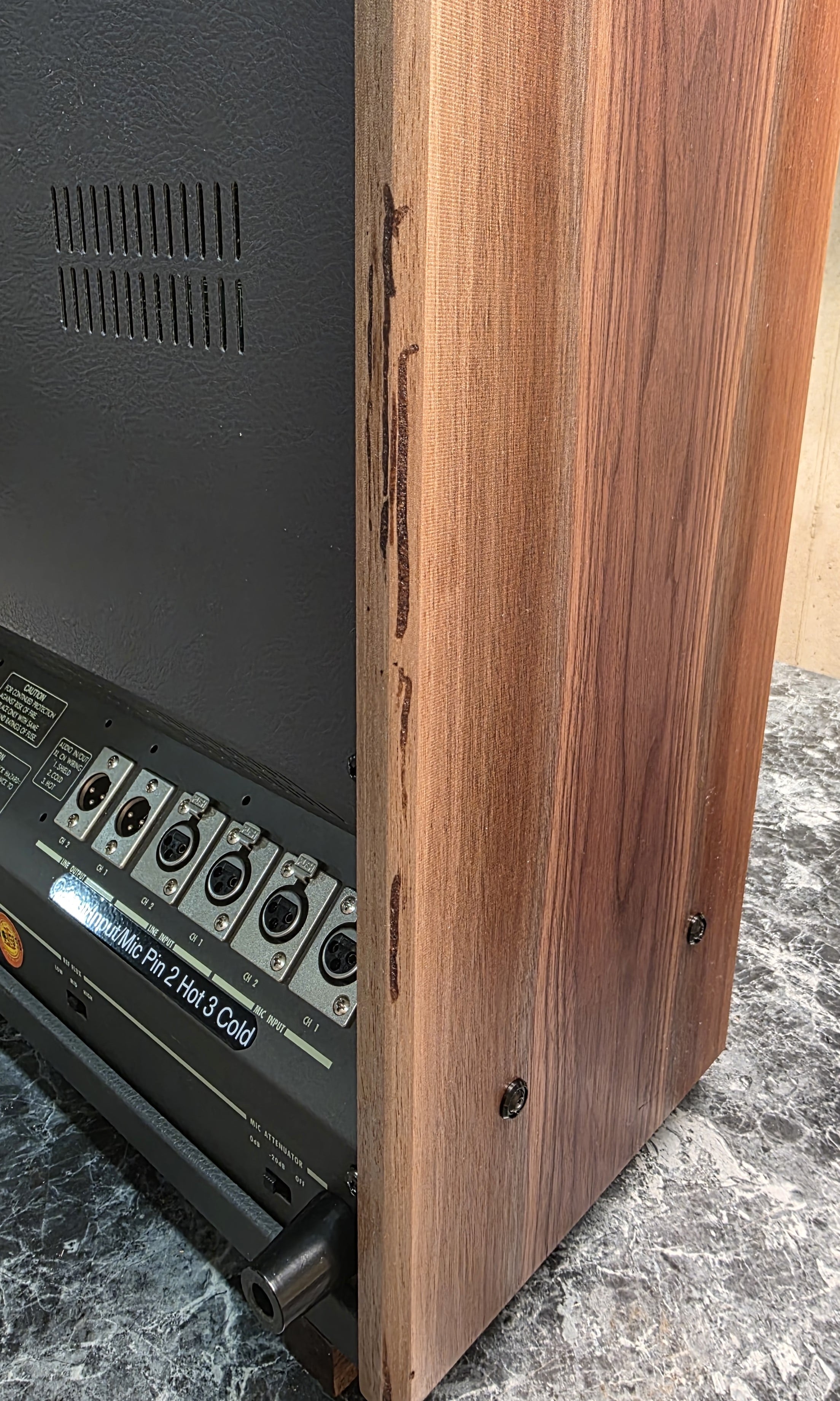

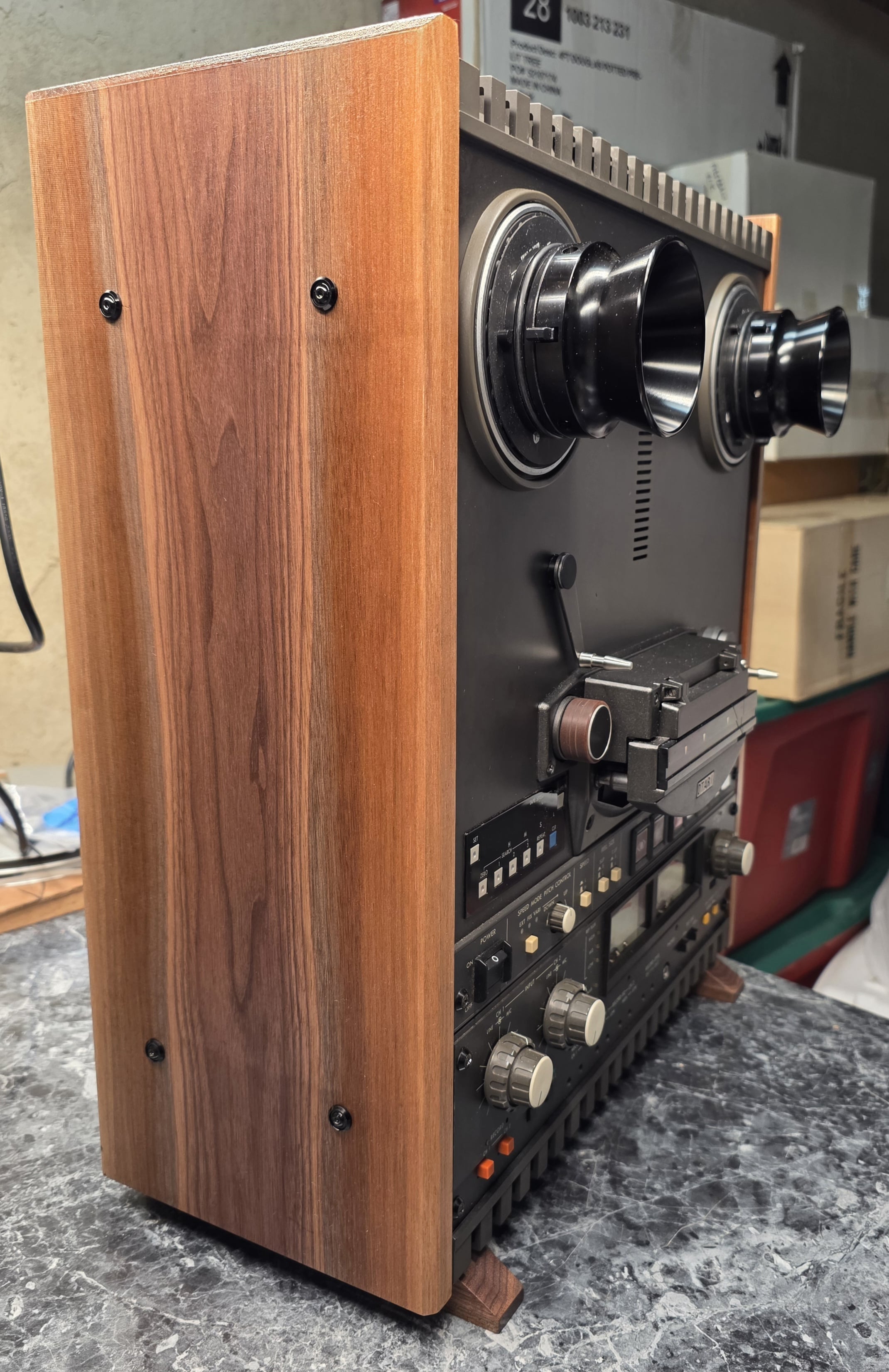

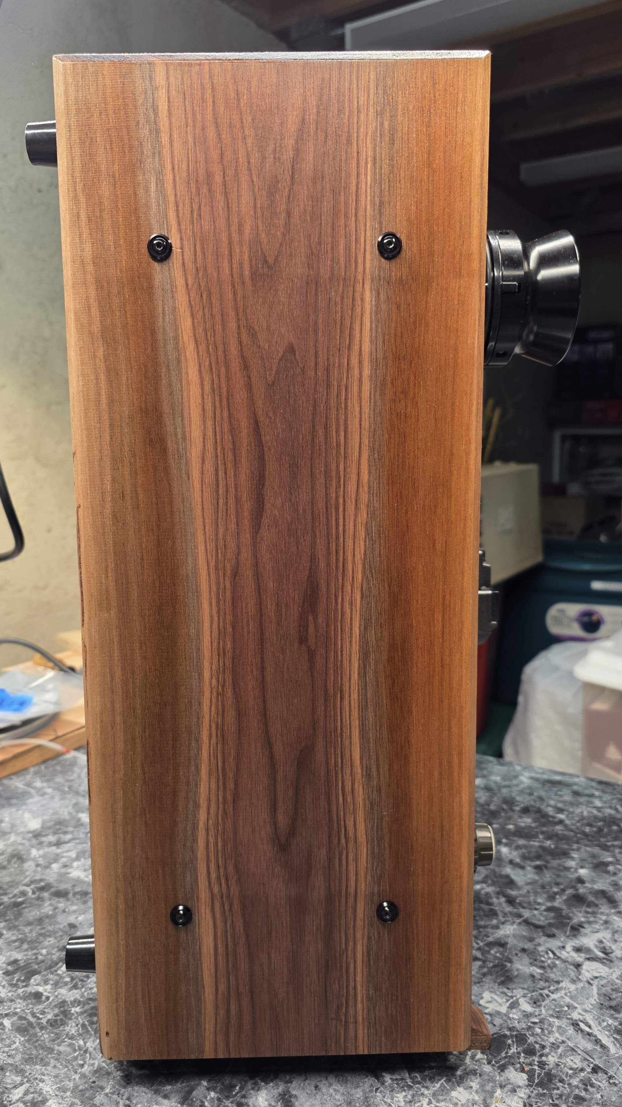

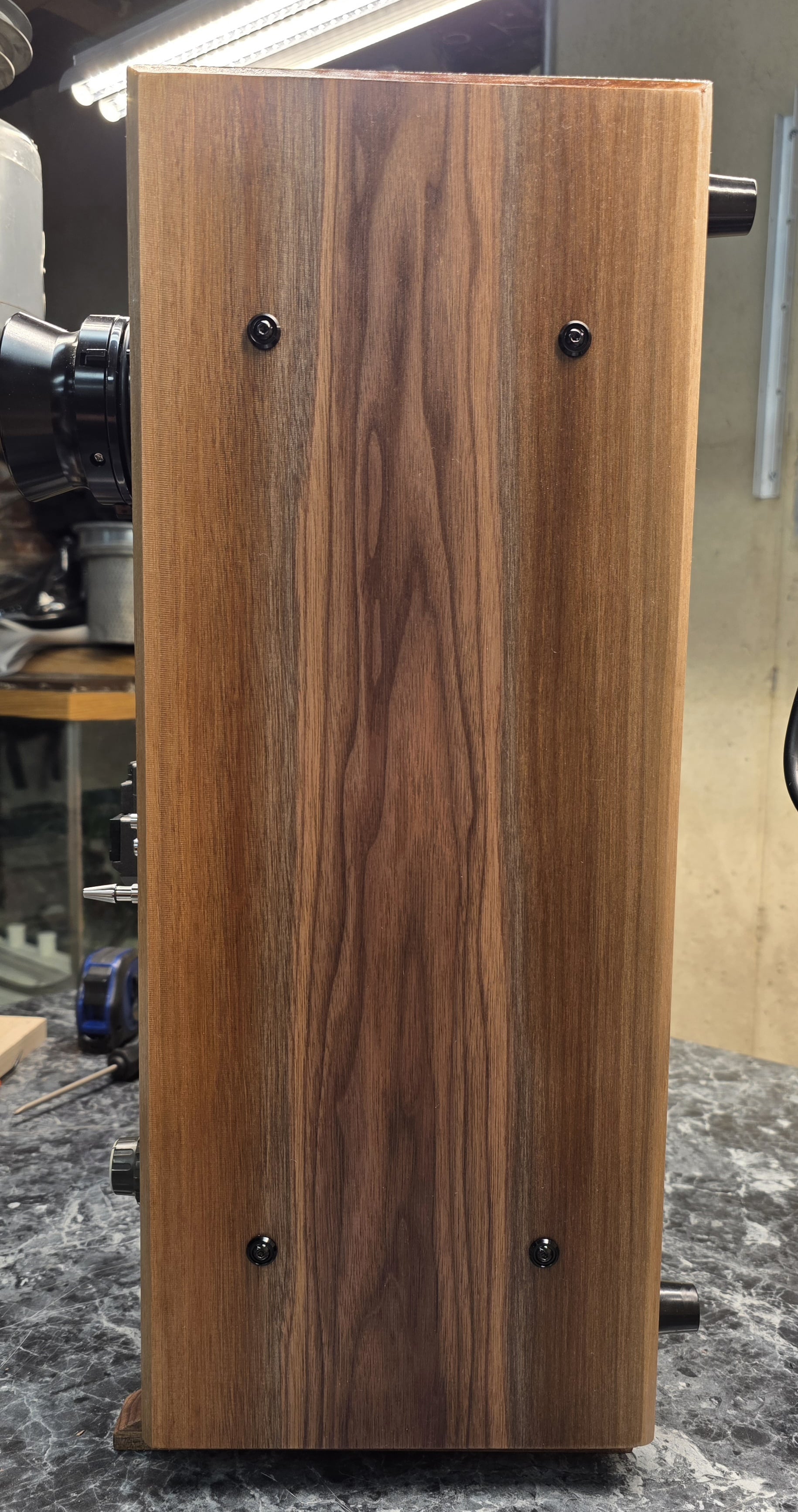

    The bevel edge Walnut sides done. IMO these tick the straight, wave and mountain grain boxes along with some nice coloring. That Aaron @ALL212 sure has an eye for picking wood in the rough.
    Had some worm holes on one panel which I mounted to the left side rear. I decided to fill them with dark Walnut sawdust to celebrate the memory of the traces that worm left behind.
