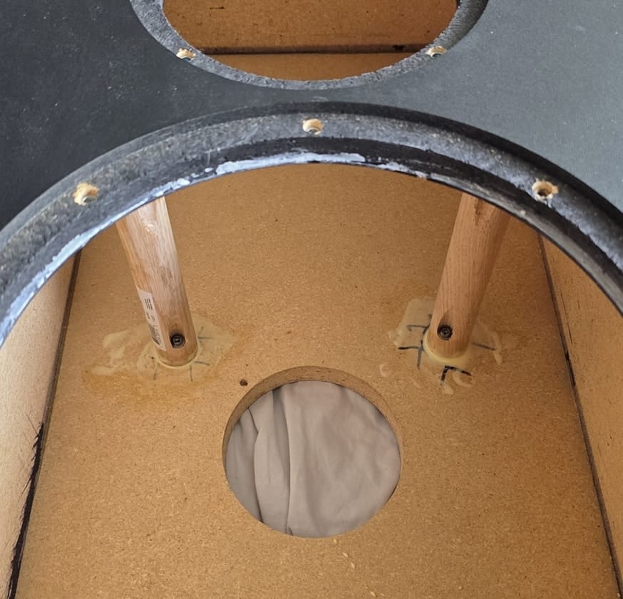

    For the bracing, would you recommend wood or threaded rod and just one brace between MW and PR? I am looking into getting some hurricane nuts as well. Is parts-express the easiest place to source them?

    It can be challenging to get control over null spots with bass in a small room and the large openings help to suck out the bass pressure/slam you want. I've had great luck with rolling up thick polyurethane foam and positioning it in the corners between ceiling and walls. Not WAF or GAF friendly but it really worked great.
    Everybody gets their hurricane nuts from Parts Express afaik.
    With the 7B you definitely want two braces but with the 5B you may be able to just do a single one (@xschop ?). I would probably use a 1 in. round hardwood dowel if I did one but I would probably do 2 (maybe slightly smaller dia. if you go with 2 would be OK) because overkill always works 🤣

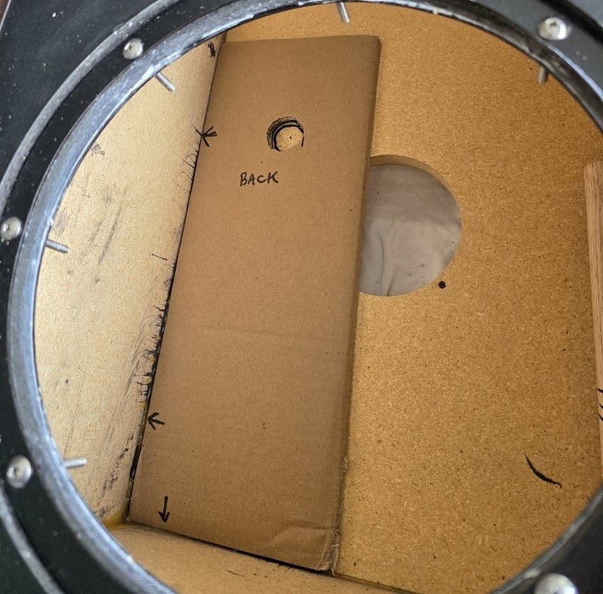

    SCompRacer Posts: 9,399
    edited October 15
    I used two 1" wood dowels in 7c's. Possibly 3/4" could be sufficient in the smaller cabinet? I used a Kreg pocket hole jig to drill holes on each end for glued and screwed joints. Screws are optional.
    They were cut to exact length of ID and had to be rolled into place through the PR hole. I wouldn't call it a press fit but they were snug.
    I used a piece of cardboard as a template to mark both ends for placement. You have to flip template around for opposite sides/ends. Once in place, roll to side and apply glue to both sides, roll back into place. Use your finger to apply a fillet of glue around joints. Wear a surgical glove if you don't like wood glue on your finger.
