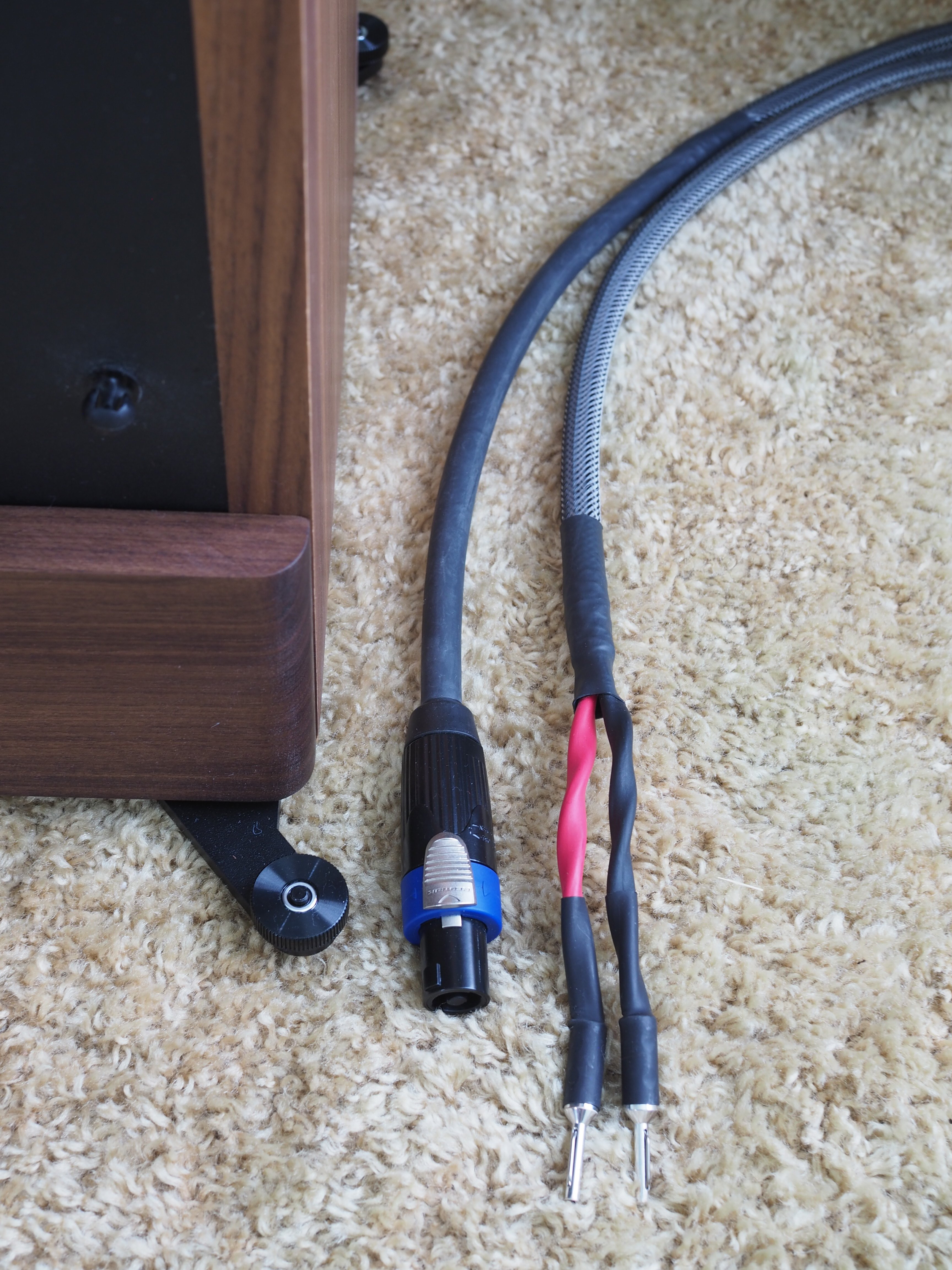

    Cables are Canare 4S11G!

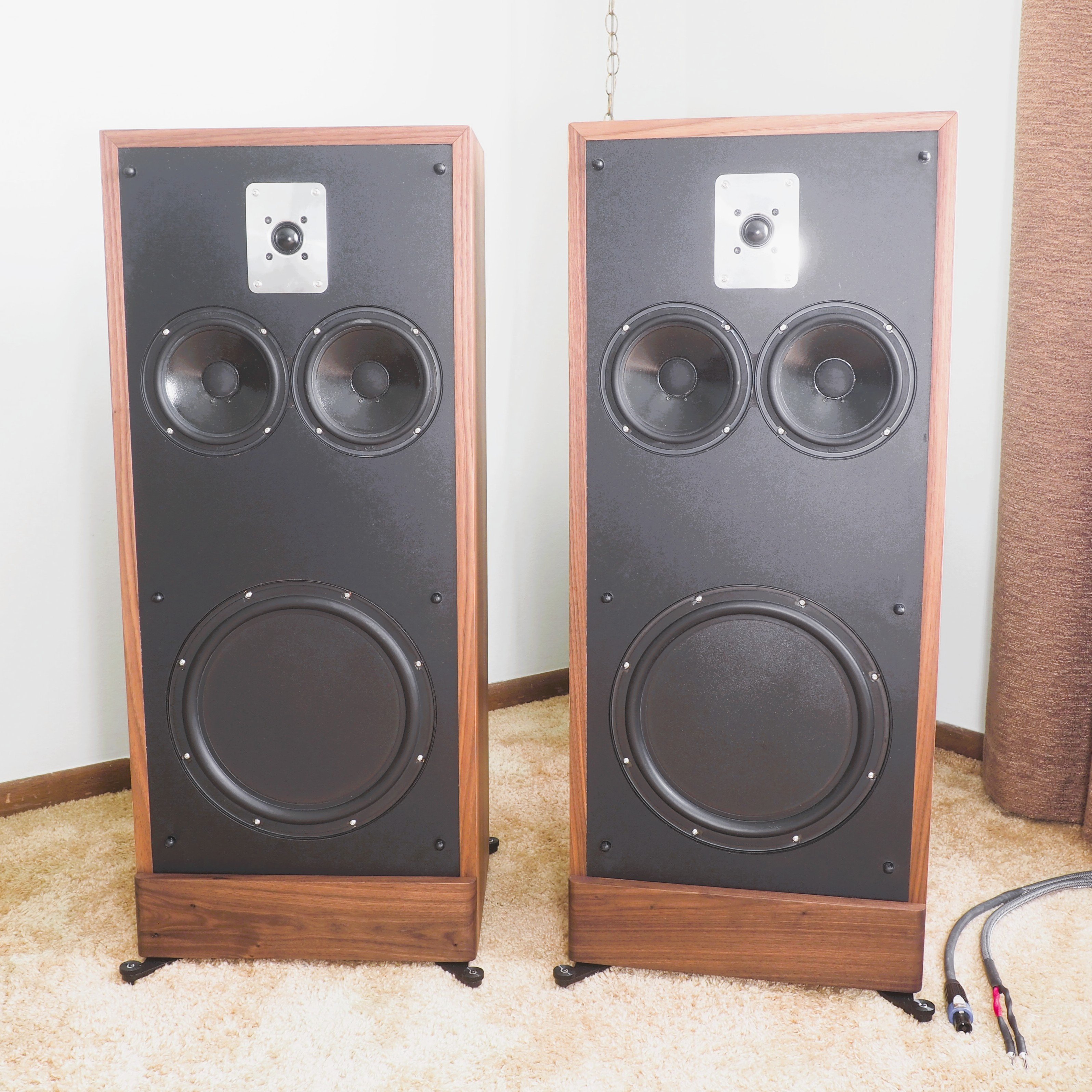

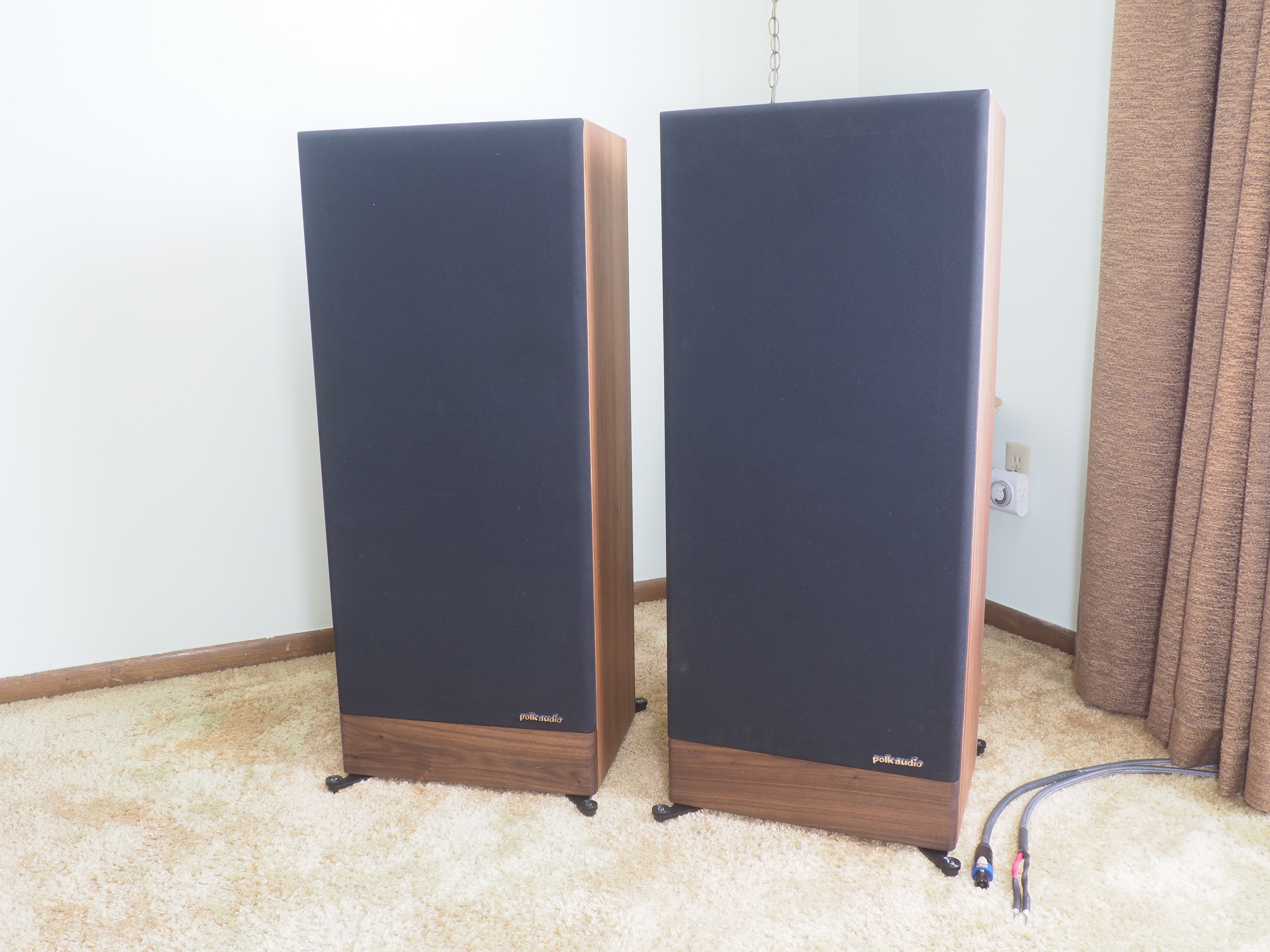

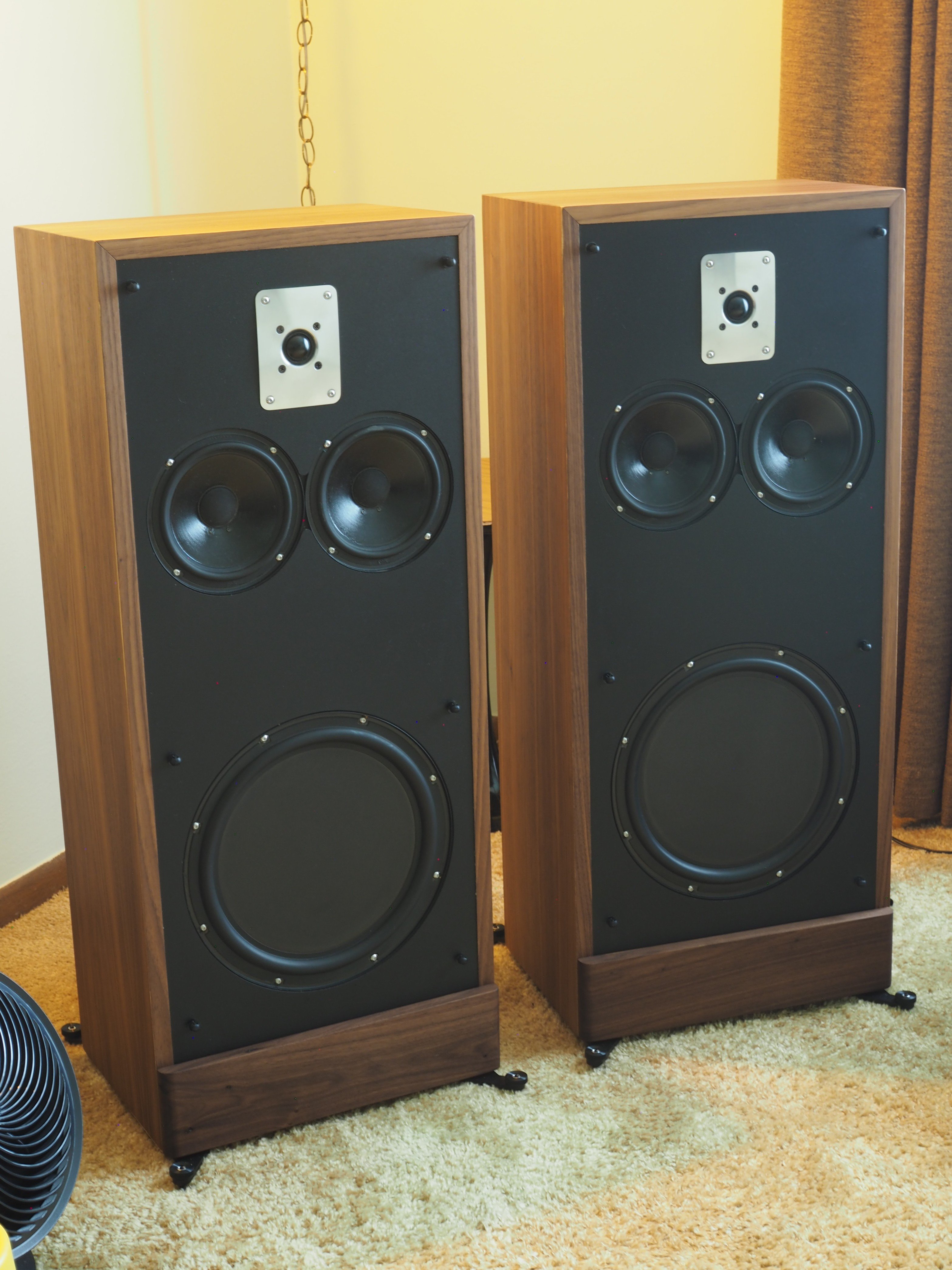

    A couple photos I took!
  • drop1
    drop1 Posts: 90
    edited September 23

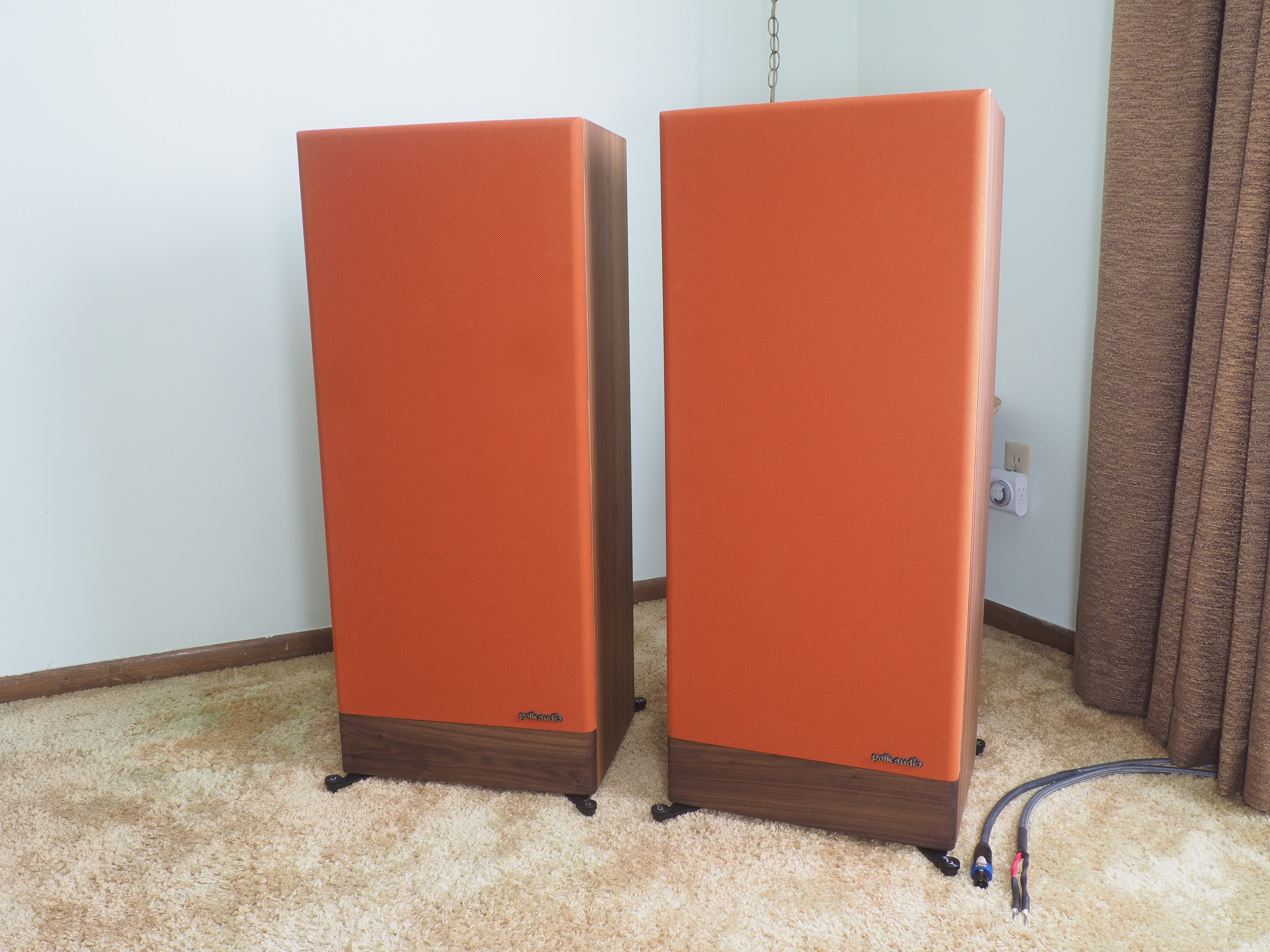

    I have two options for grilles. What do you think?
  • drop1
    drop1 Posts: 90
    The black grilles are original (and still a bit dusty in the pic). I sourced a second set of grilles from eBay. Pretty cheap. Burnt-orange color grille fabric comes from a company called Huntley Audio. Upholstery came out pretty good.
    The walnut veneer + burnt orange combination is just too handsome. Looks pretty good on the Polks too IMHO B)

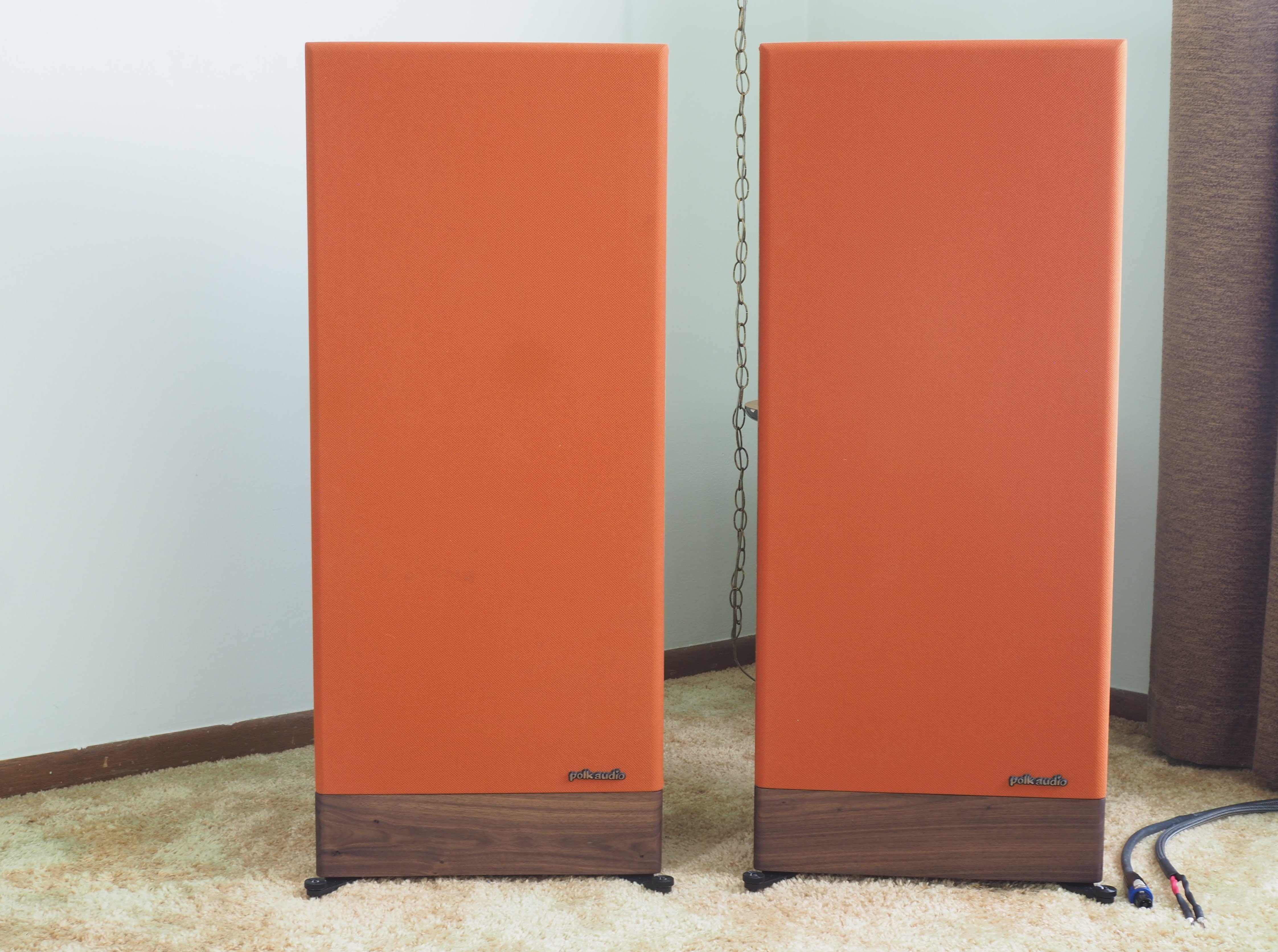

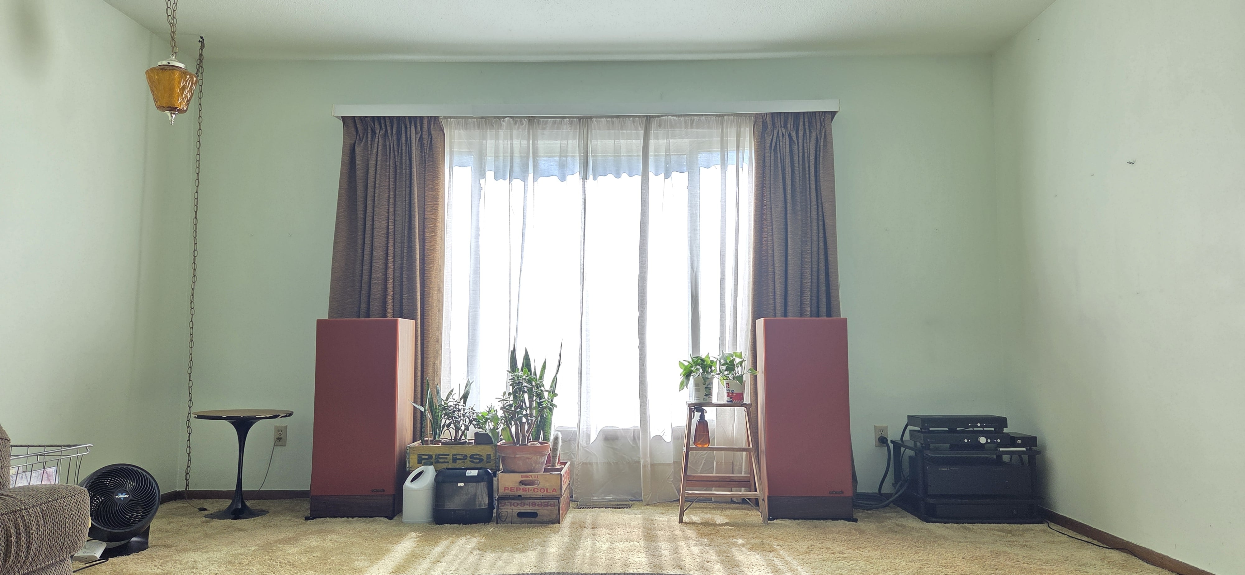

    Room is about 18' x 14.5'. Ceilings are 8'. Here's the set-up against a south-facing window. I have them placed with 8" against the back-wall and 36" from each side-wall (outer edge to wall). This gives me about 6' in-between. I'm lacking room decor because a remodel is forthcoming. Either way, I like the way it looks currently with the Polk speakers. My stereo components are exceeding rack capacity. I tried a Salamandar Synergy but wasn't satisfied with the looks. I plan to build a new rack with threaded rod at some point. Possibly an extended width rack/shelf to sit along the right-side wall.
    pitdogg2 Posts: 27,881
    Bass will be better if they are closer (4"-6") to the back wall. Those heavy drapes may negate that however. In my experience SDA's work better along the longer wall.
    Looking good.

    VR3 Posts: 29,731
    Looks great now you just need diffraction control for that wide baffle
    billbillw Posts: 8,195
    VR3 wrote: »
    Wink wink...
    I think I do too. My 2B have pretty much every recommended upgrade except your pads.
    VR3 Posts: 29,731
    The models where the tweeter is all alone up top especially is about night and day
  • drop1
    drop1 Posts: 90
    Order placed. That will round-out the FULL suite of my intended upgrades.
