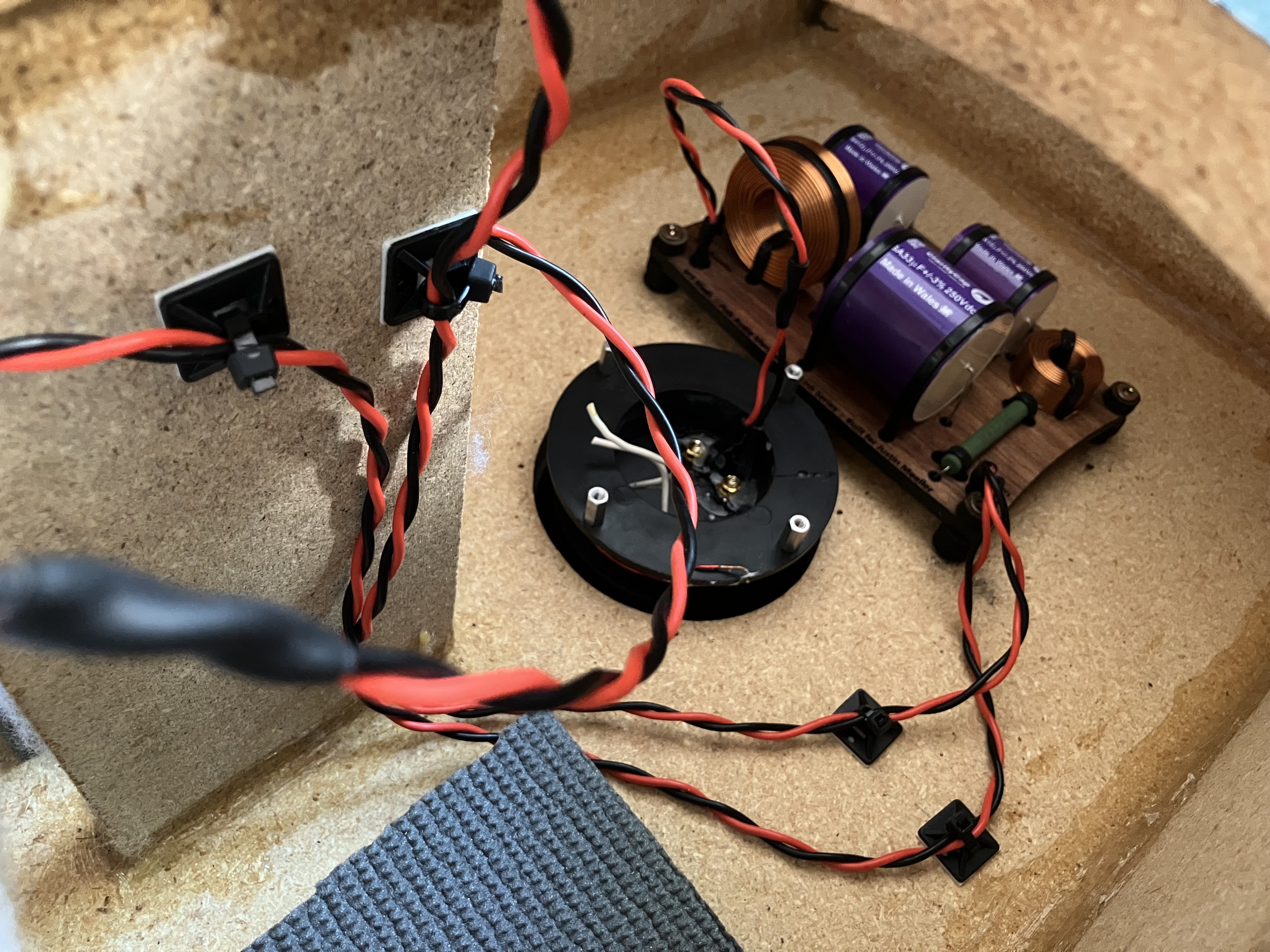

    Bunch of pictures from the SRS2 build, we are getting them finished this week.
    I think we managed to repair the MW155, the plan used was a bunch of the recommended craft glue and a very long/thin curved neck bottle normally used to dispense oil/vinegar/whatever at hibachi cooktops.
    That allowed us to reach the entire perimeter of the foam cone and re-glue it to the surround, it was left on a quad stack of towels to leave pressure on the whole stack with about 2 lb on top of the washer bolt via a socket to distribute the load evenly.
    I forgot to take a picture of that step but end result is passable, the compliance of the overall PR isn't perfect/it doesn't move quite as freely as the other one but I don't really have another option right now.
    Every driver had dynamatt added, magnets were glued, all the normal mods etc etc...

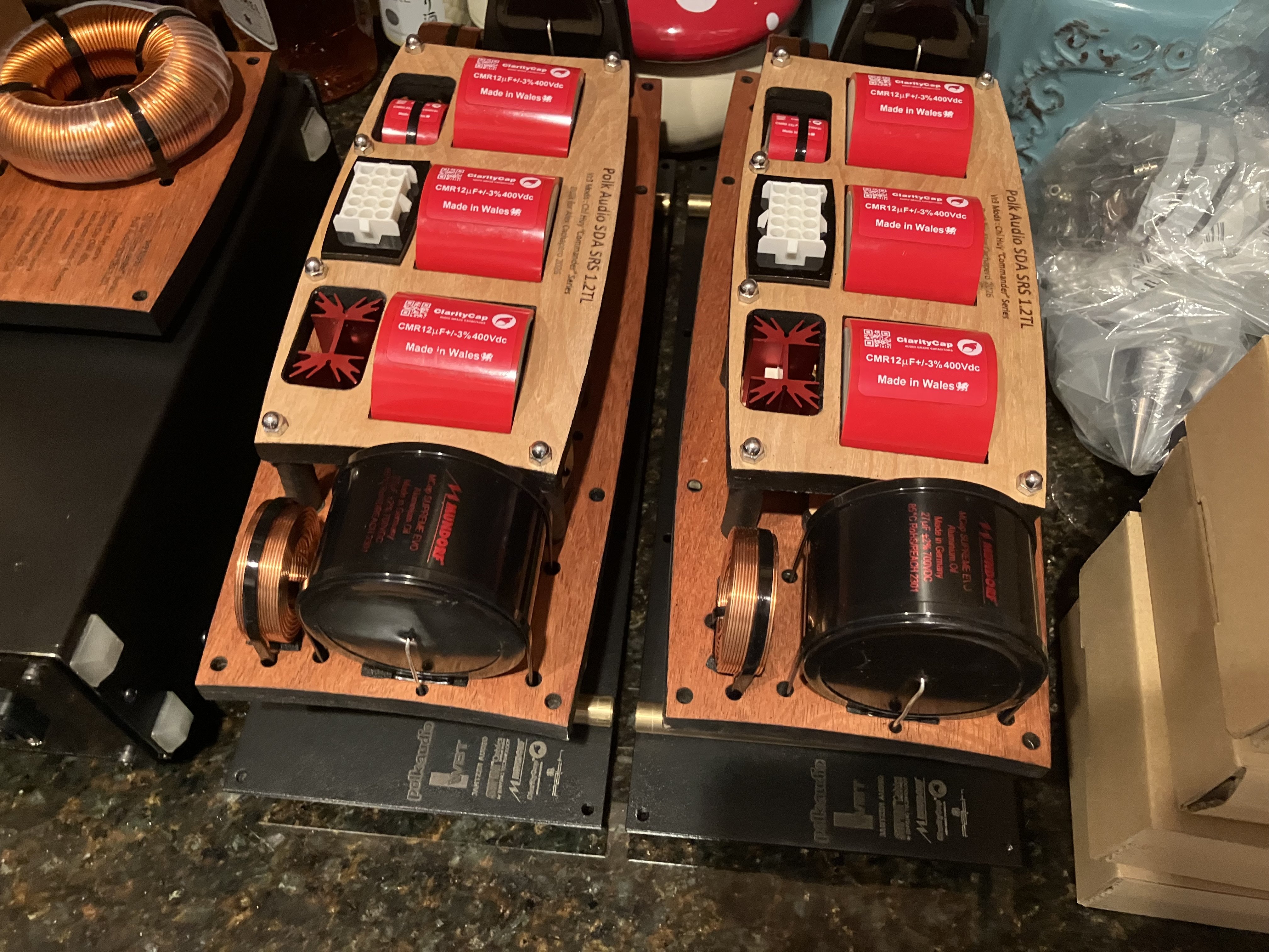

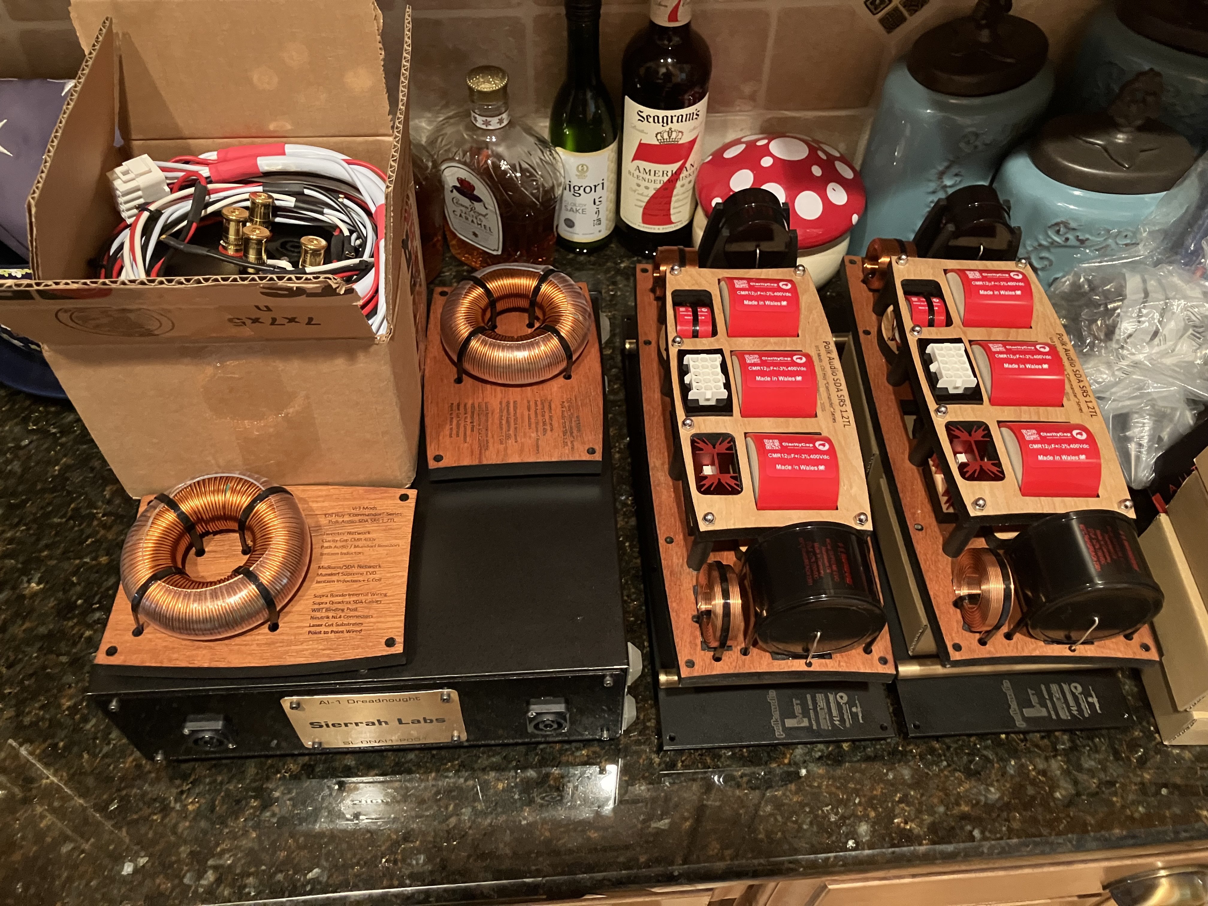

    Got the upgrade hardware for the 1.2s in, I'll be starting a thread for them/the build out. Also finally got my friends M10s upgrade finished

    VR3 Posts: 29,701
    Looking fresh!
  • Striker2237
    Striker2237 Posts: 128
    VR3 wrote: »
    Looking fresh!
    You would know haha!

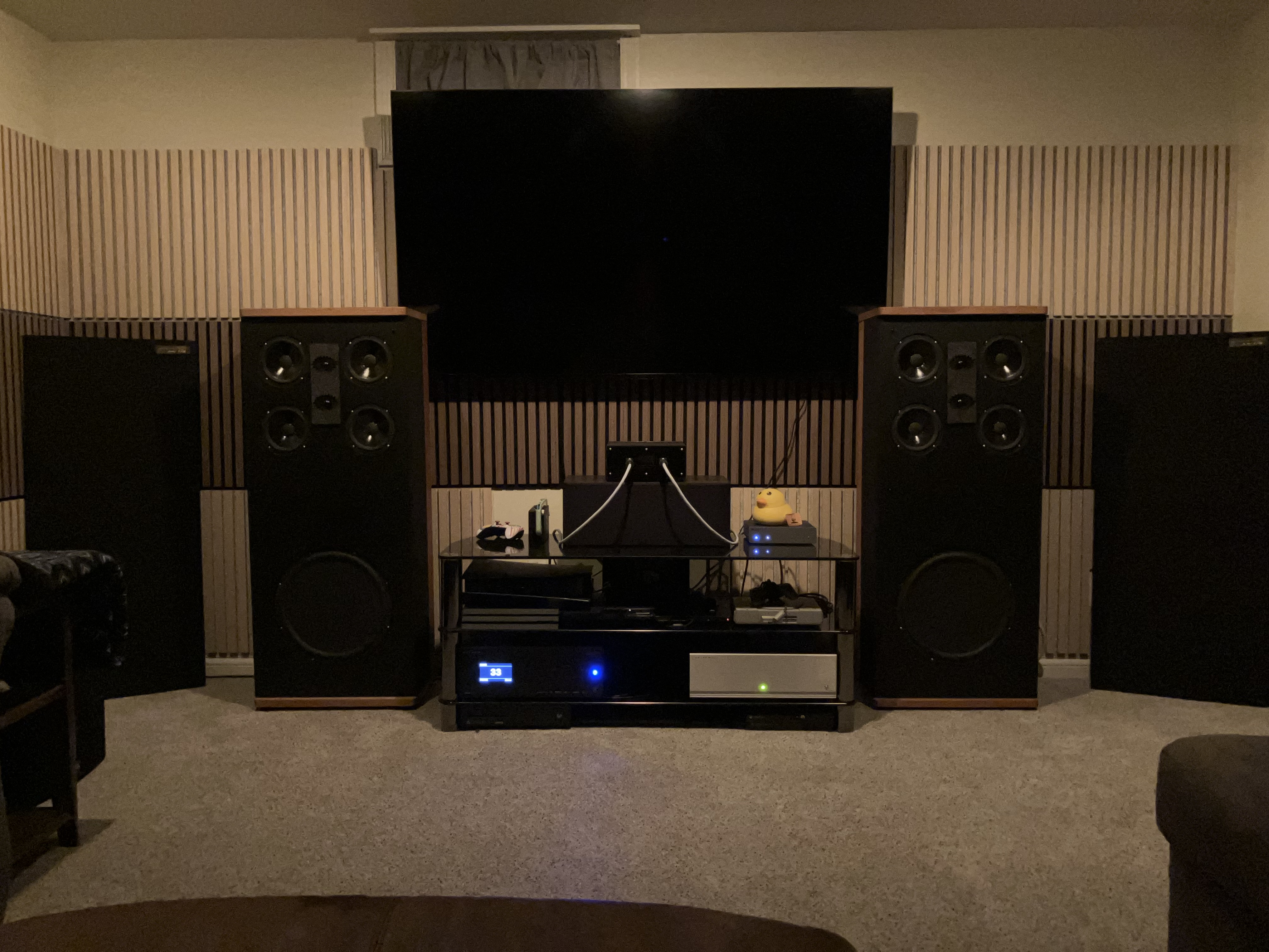

    I'm running the SRS2s in 1 hour btw, hopefully they sound good!

  • Striker2237
    Night and day step up over my Sonicap/mills 1Cs!
