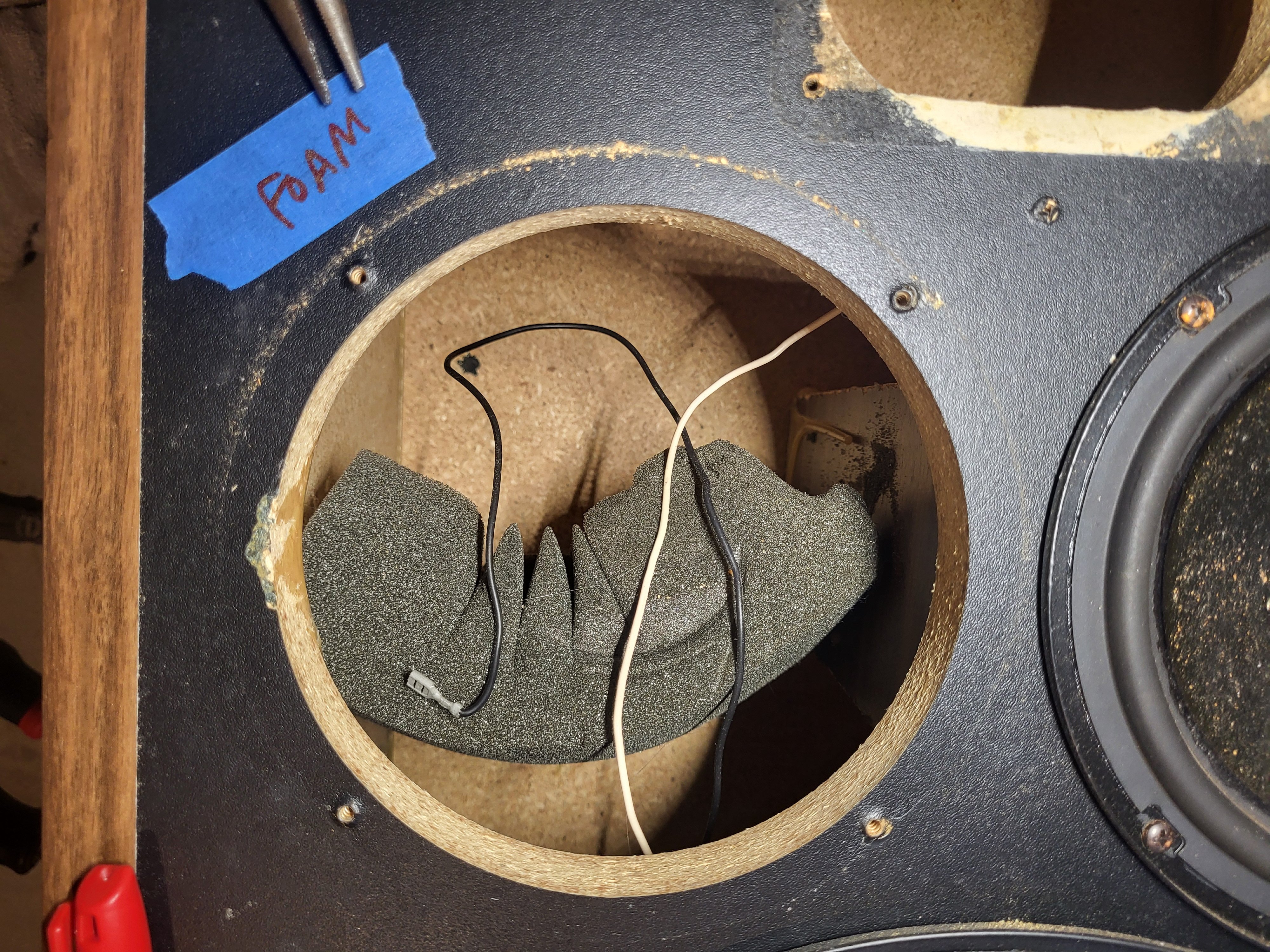

    You have somewhat rare speakers. Tell us some of your impressions, even though they haven't been modded yet? Do they have internal bracing and what does it look like? Is your foam under the midrange driver still intact? How well do they stereo image?
    Short answer is that I've never heard them, so I can't comment on the sound. When I purchased them (~4yrs ago), they had mismatched aftermarket tweeters, and I never bothered to try and play the speakers. Ref. my earlier post:
    https://forum.polkaudio.com/discussion/195969/monitor-11-needs-help?utm_source=community-search&utm_medium=organic-search&utm_term=monitor+11
    I'm finally getting around to working on them, and thus the reason for this current post about the MW markings.
    And, yes, they have a front-to-rear brace located between the MW's, and the original (disintegrating) foam was still attached below the inboard drivers. Here's a pic. As you can see, there's a big indentation from the MW magnet. So the foam is really more BEHIND the driver than UNDER it. Not sure if that is intention or just shoddy quality.
