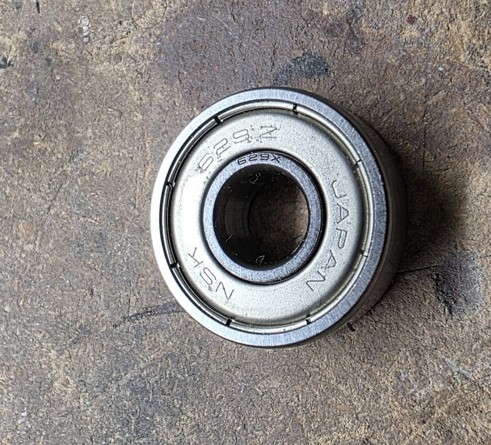

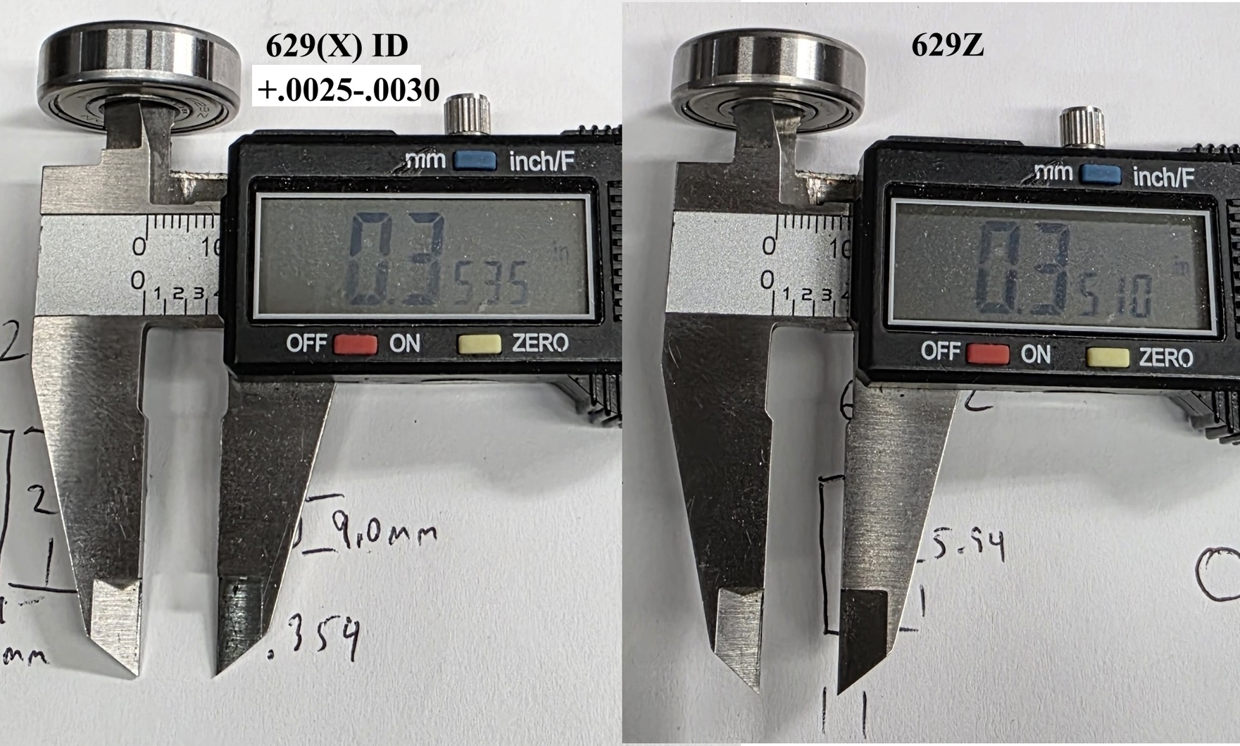

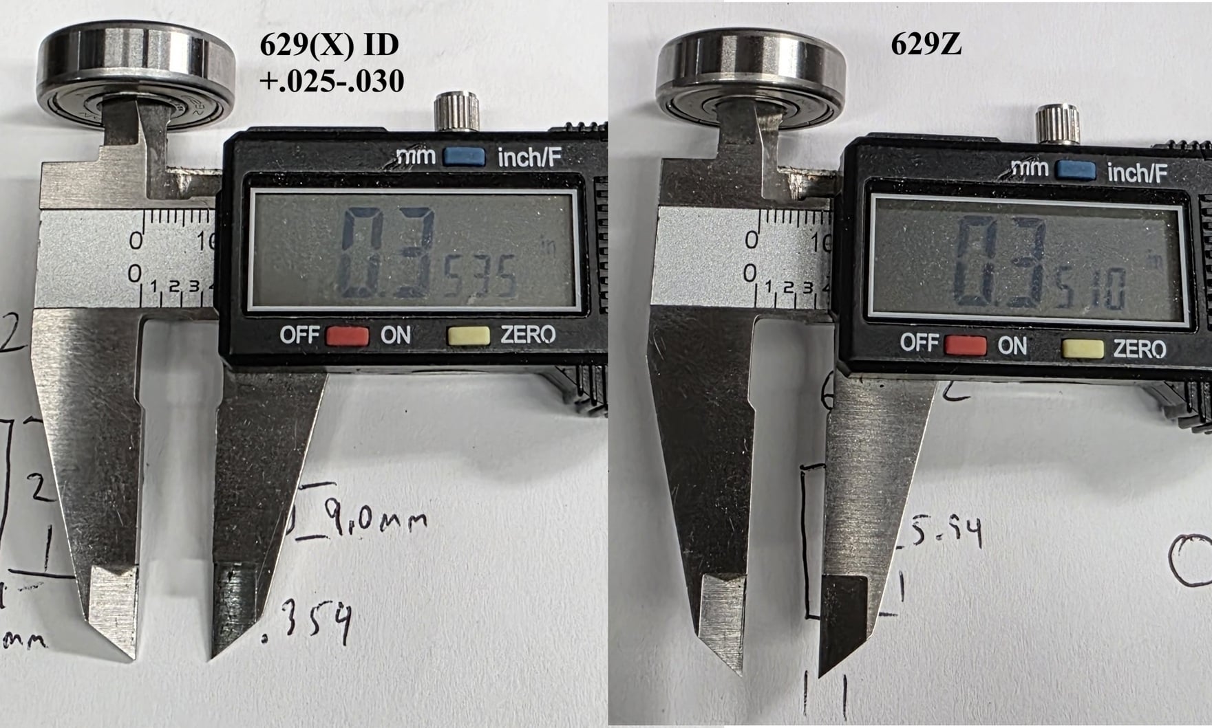

    Trouble in paradise. It seems I didn't research enough or look harder. The MR-1L motor in the BIII has the 629(X) custom bore bearings as the 1H motor. I'm guessing they enlarge the race ID before hardening and assembly. It would be risky to grind or machine down the motor shaft for standard bearings. Only a machinist could say if it's possible. The armature has magnets on front and back.
    629(X) marked in the inner race means custom bore.
    I sold all my micrometers and dial bore gauges to a buddy so all I have are these inexpensive dial calipers. It gets you close but I wouldn't call it take it to the bank exact. The difference between a 629(X) and 629Z, the 629(X) inner race ID is .025-.030" larger. The motor shaft is 9.00mm/.354." The design and assembly of the motor require slip fit bearings. IIRC 15ips is 923RPM and 7.5 is 460RPM.

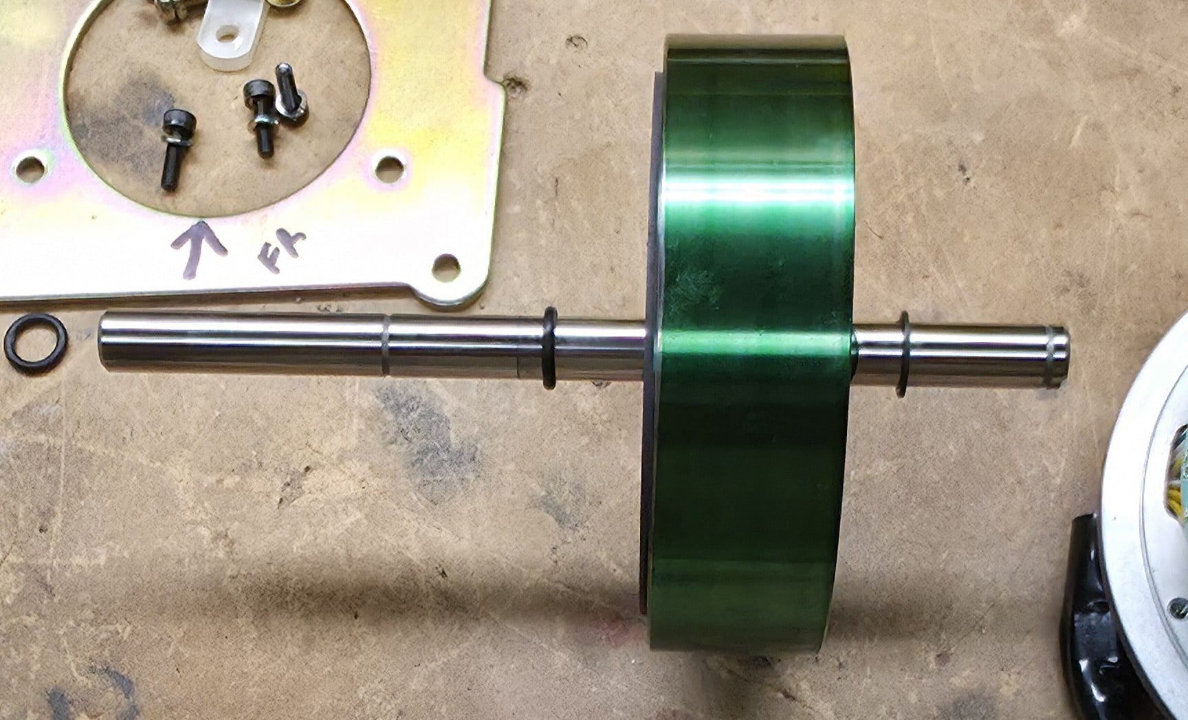

    The armature. One pic looked like a sleeve on ball bearing end of shaft but it was just lighting.

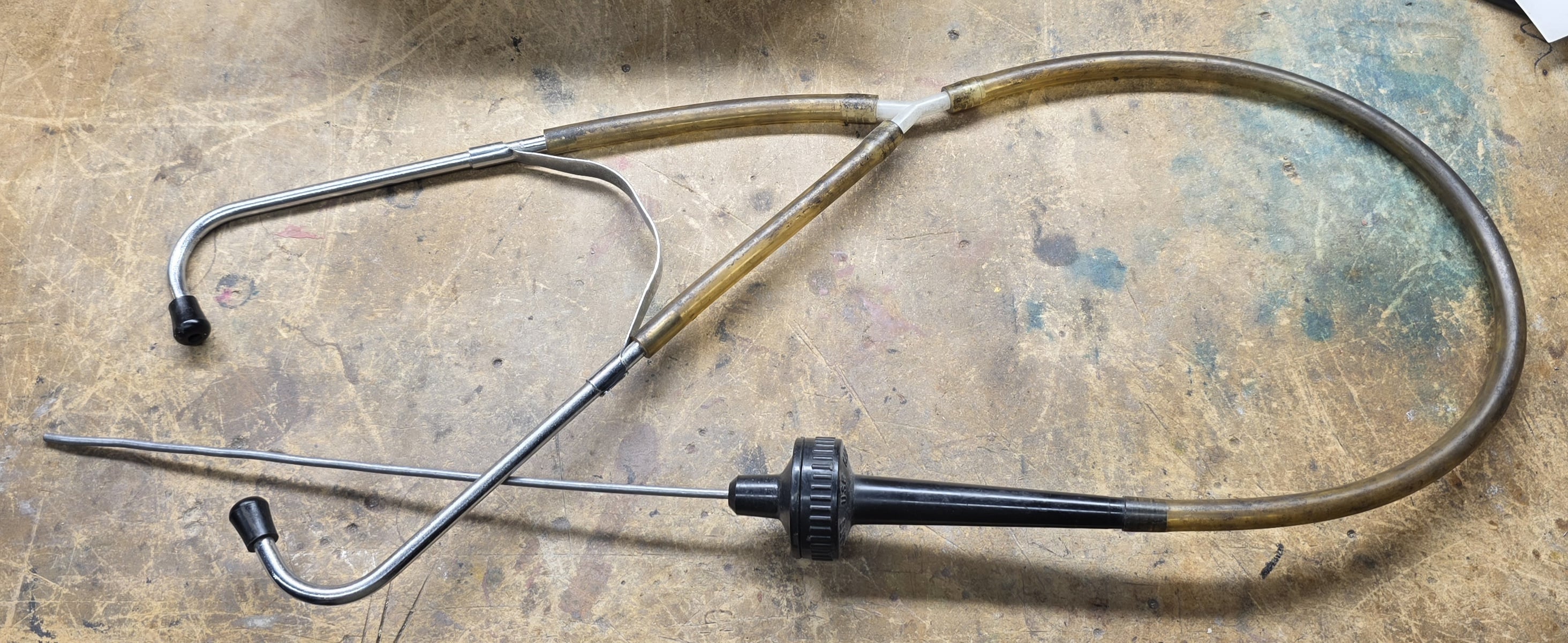

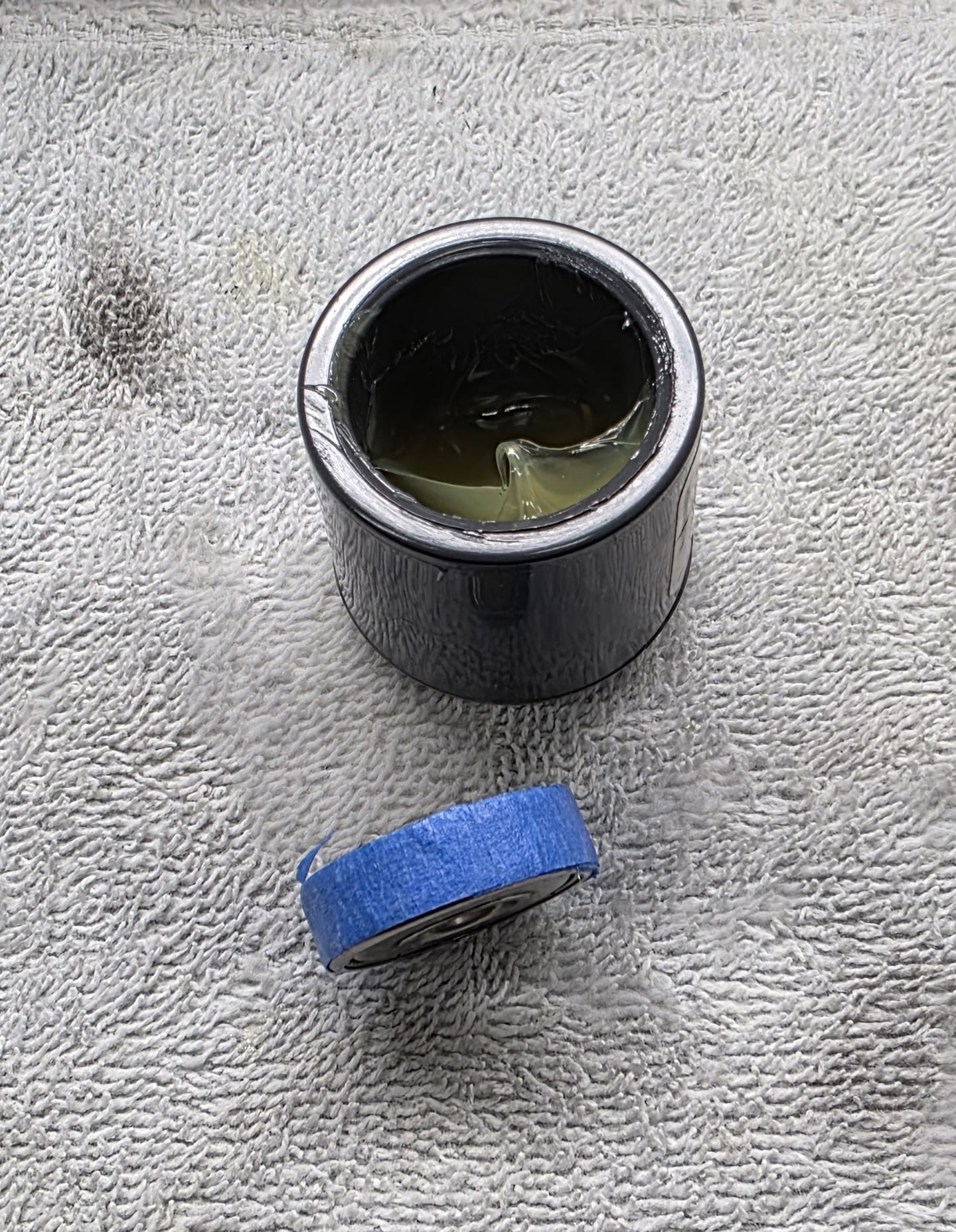

    The old bearing stethoscope picked up what I call a dry bearing sound. After 31 years the grease could harden. The outer races spun really easy, almost freewheel, no slight resistance. I figure I'll try greasing them first.
    Grease has to be baby bear right. Too thick and the slip fit races will spin on the shaft. Too thin and it could run out.

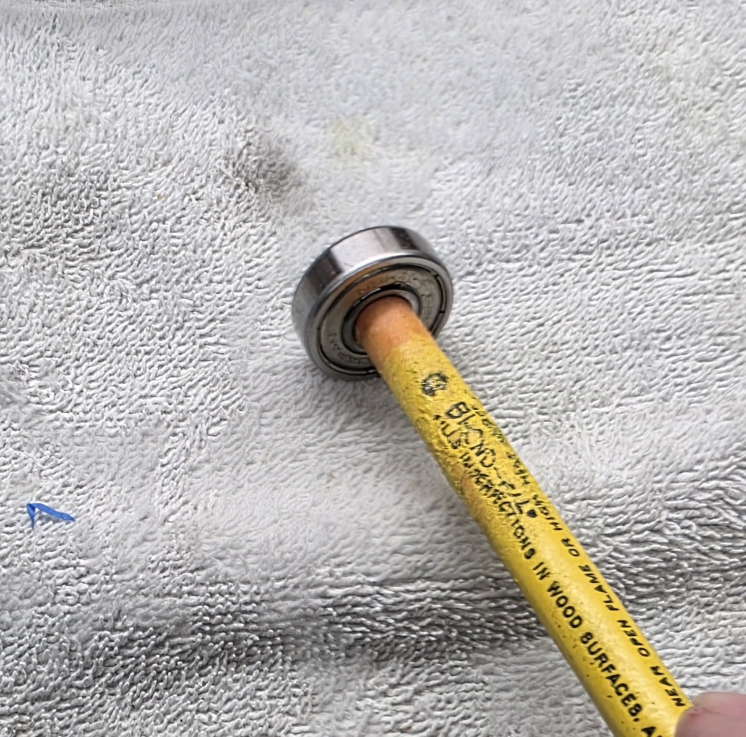

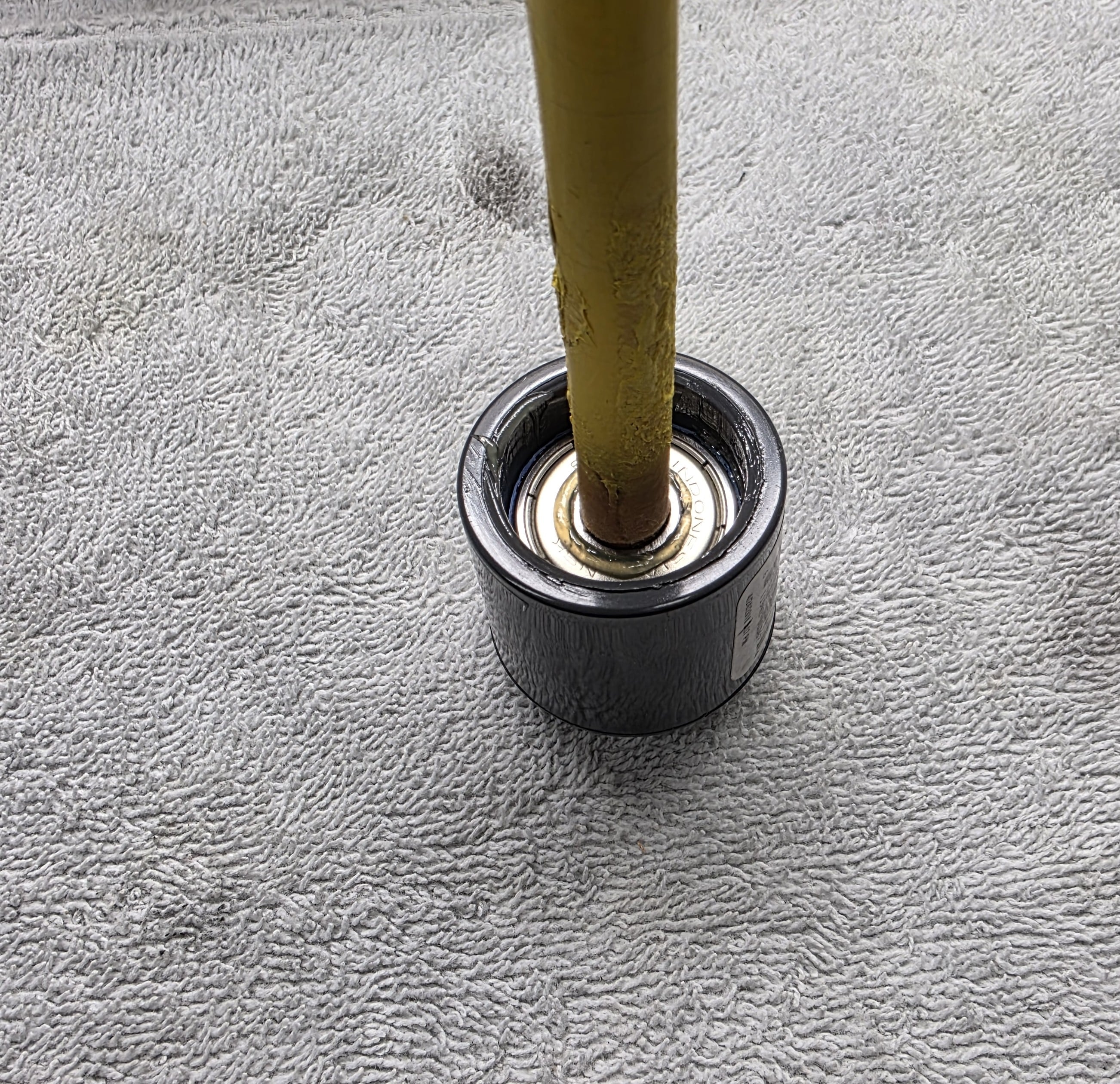

    There is the old blob of grease on a piece of baggie, taped tightly around bearing and plug race and push down trick. I took the bearing to the hardware store and found a 3/4" PVC pipe cap was very close. Just wrap some tape around bearing for a snug fit. Much easier than trying to tape a small piece of a baggie with grease blob to the small bearing.
    I don't have the Otari spec for grease, so I went with what most small sealed bearings are shipped with, NLGI 2. Viscosity is like a creamy peanut butter. NLGI 1 is like tomato paste. A grease pencil with tapered tip was perfect for plugging ID. A 3/8" wood dowel tapered at end is another possibility. It allows plugging the hole and turning the inner race while pushing down into grease.
    Bearing manufacturers tell us that you don't want a 100% fill as it results in grease churning, adding resistance and heat. So I ran the bearing back and forth on a towel to run some excess out. The metal dust covers are pressed in so not much chance of getting them out without destroying them.

    .0025-.0030".
