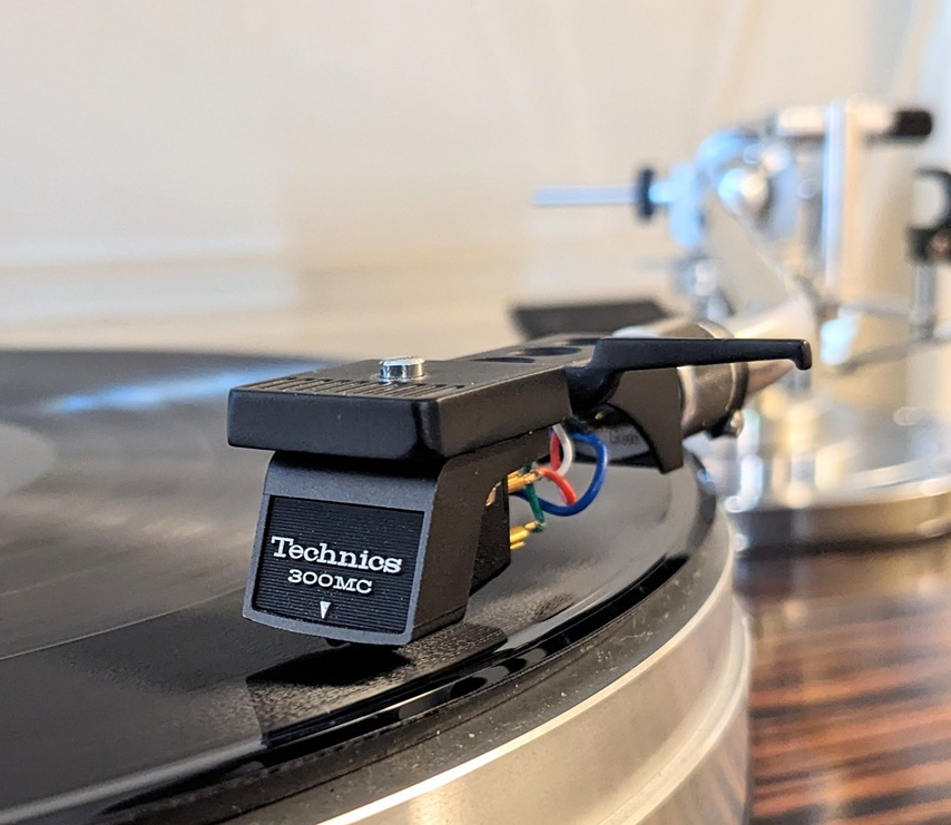

    New (to me) acquisitions:
    Technics 300MC - Titanium Nitride (TiN) cantilever with nude elliptical stylus

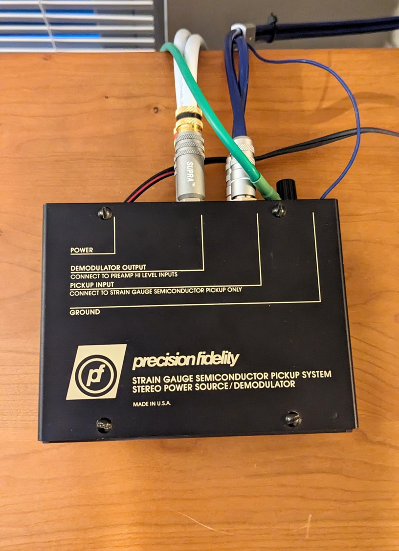

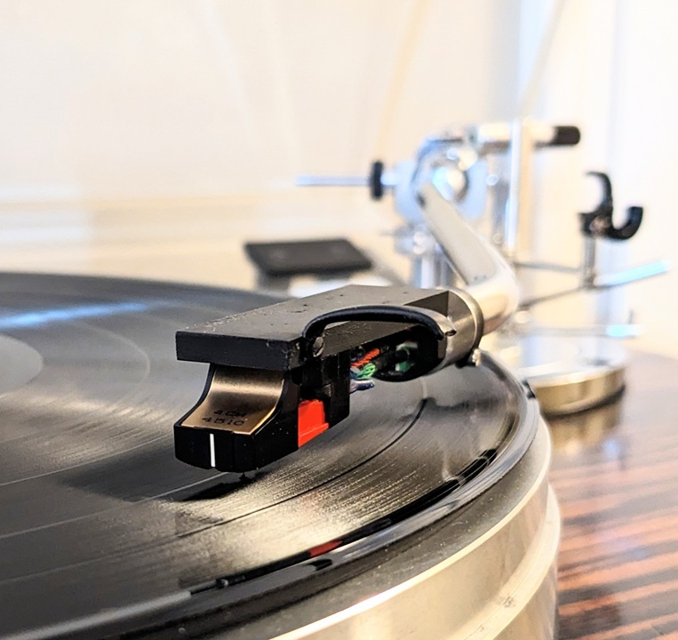

    Panasonic 451C Strain Gauge - has a bonded Shibata (CD-4) stylus
    with Precision Fidelity SG Demodulator
    I believe it is well-documented that these Strain Gauge systems have a frequency response curve that is different, which I can confirm. There's a bump in the low-end, a defeat in the mids, and then a bigger bump in the highs, that doesn't roll-off until out of our listenable hearing range. For me, it's not a game changer, but more of an adaptation.
