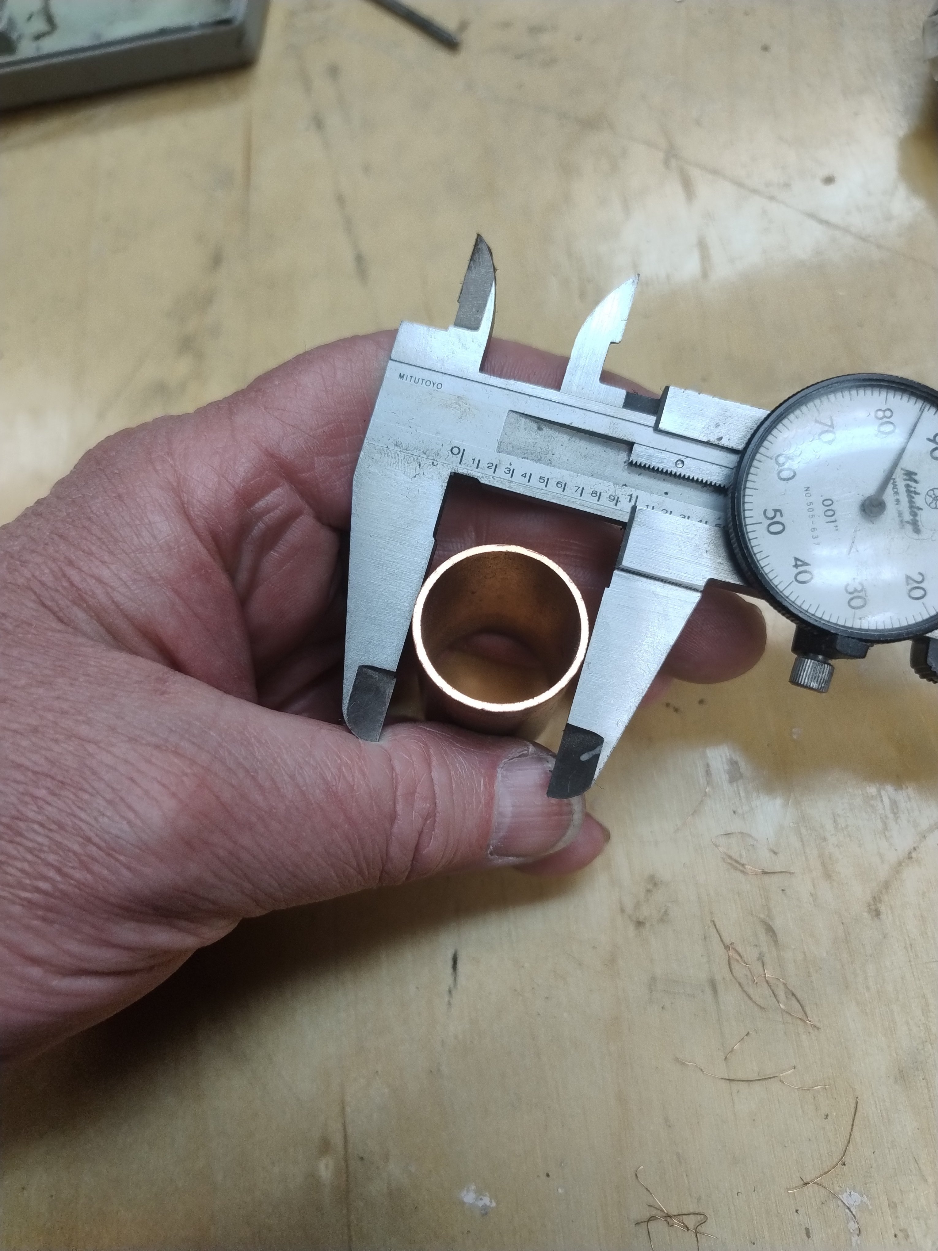

    The game plan is to machine the pole-pieces to 0.885". (The ID of a 3/4" copper coupler) and slip-fit. It just happens to have an OD of 0.985" (factory PP is 0.990")...which will give the sloppy 6510/6511 suspensions a touch more clearance to boot....

    How much will that increase the gap, which will decrease BxL?

    Only 0.005" gap increase, unless we include copper thickness, which is avg. 0.045".
