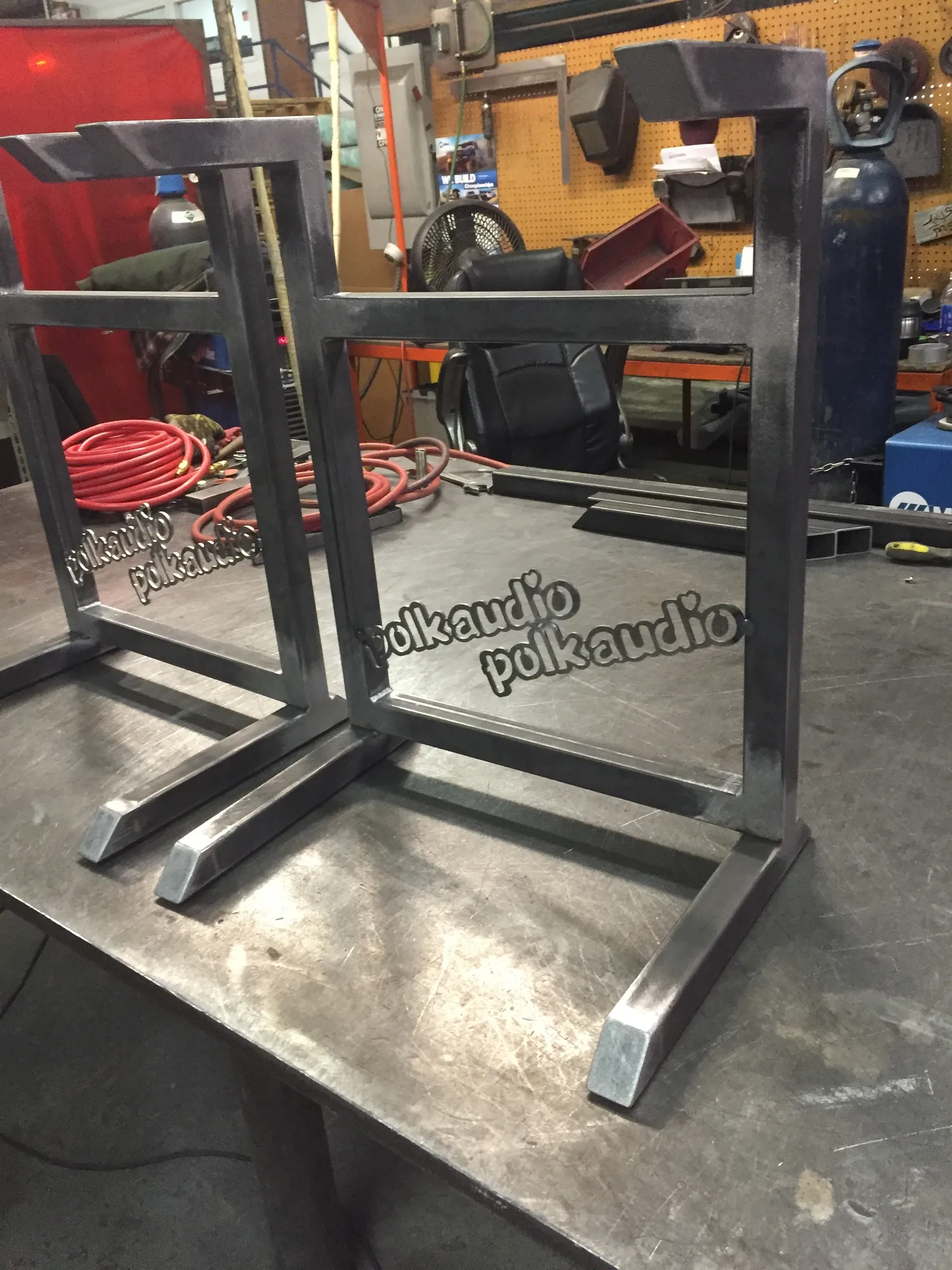

    If you're going to make your own, make better looking ones, and make them the full width of the speaker..

    Yes that is the plan. What height should they be? Length of bottom foot? Appears to be 1" tube to me. Should I go with a thicker or thinner gauge of steel? I assume thicker would be better.

    If you're going to weld up a set, make sure to leave some holes to fill them up with dampening material like sand, aquarium gravel, etc. You could probably drill holes after and plug them up with a panel hole plug.

    To answer your question. the original stands are 25" tall. 14.5 wide. Just measured mine. Depth on top is 7" bottom is 13". Not that you need that if you are building your own I do not guess...

    Thank you @VSAT88. I am going to build my own and appreciate you taking the time to get the measurements. I'm sure I'll make them the full width of the cabinets like @Toolfan66 suggested, but the height and depth is what I wanted to know. This will allow me to make sure that they are stable. Thanks again.
    F1nut Posts: 52,375
    You should make the stands tall enough to have the tweeters at ear height. I found them too short and added tall spikes to increase the height. Still shorter than I would have liked.
    Also, the speaker should be isolated from the stand by resting on rubber pads or the like.
    Toolfan66 Posts: 18,410
    This is exactly what I did.
