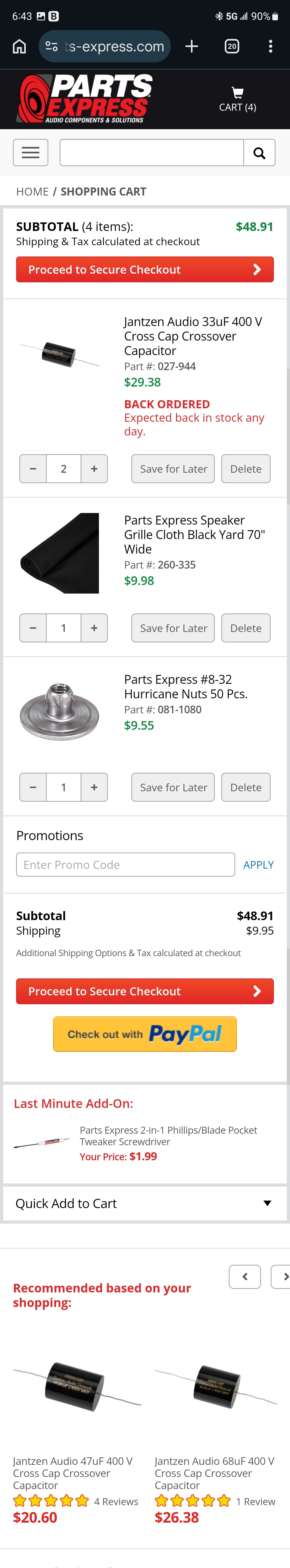

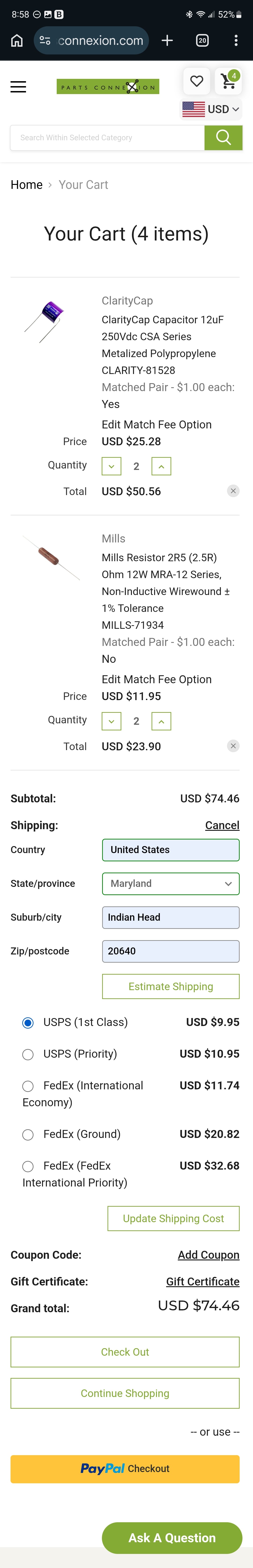

  • OK. Would this selection of capacitors and resistors be a better route to go?
    F1nut Posts: 51,999
    edited March 11
    I'd stick with all Clarity.
    Edit: I see that Parts Connexion doesn't carry the PX 33uF, so I guess the Solen will have to do unless you want to pony up for the CSA 33uF.
    billbillw Posts: 7,784
    edited March 11
    I'd go with Jantzen Crosscaps before I'd put any Solen in my crossover. (They are cheaper at Parts-express, but backordered right now 😕)
  • @billbillw so you are suggesting these?
    F1nut Posts: 51,999
    Do not get a Cross Cap for the 12uF.

    @Grabber70Mach
    Right, I was only suggesting it for the 33uf to be better than the entry level Solen at roughly the same price. There's no telling how long the back-order will take to fill with the current Denmark/Greenland drama. If you can be patient, I'd probably wait, but otherwise, the Solen are still miles better than the original electrolytic caps.

    So this is the way I'm thinking might be the best way for me to rebuild these.
    I'm looking at these components for rebuilding the crossovers. Also ordering some hurricane nuts and speaker cloth. Hopefully the one item will be in stock soon and I won't get impatient. 😆

    F1nut Posts: 51,999
    Just get all Clarity CSA caps and do it right.
