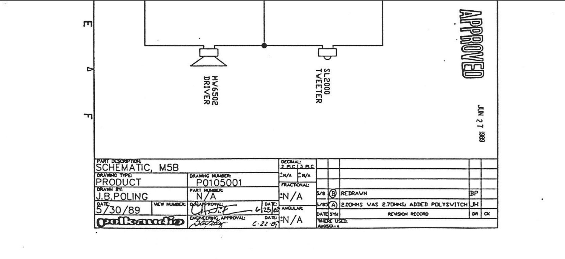

    I'm not going to argue with anyone who has had good results with the 0.5 Ohm (god forbid), but assuming that Polk knew what they were doing (pretty good assumption I'd say), it is indicated by the schematic itself that they took away a fuse that we know from datasheets was 190 mOhms resistance and added a polyswitch. when they did that they reduced the 2.7 Ohm tweeter resistor to 2.0 Ohms. So they basically removed 0.9 Ohms of resistance to compensate for the internal resistance of the polyswitch. The thing is, we don't have the early schematic that shows the fuse although we know they went from the fuse to the polyswitch. Did they also go from the SL1000 tweeter to the SL2000 at the same time they added the polyswitch? Anyways, carry on. People that omit their polyswitch when they upgrade the XO usually also omit the SL2000 and go to the RD0194-1. I would do what people here have been happy with which is the 0.5 Ohms, and yes you can just use a 2.5 Ohm resistor and 1 resistor is half the price of 2. Having said that, if you think there is even a slight chance you might want to do the TL mod for the RD0198-1 tweeter in the future, which I know people here have said is superior sounding to the RD0194-1, then do the 2 resistors (see schematic I uploaded from vintage speakers section).

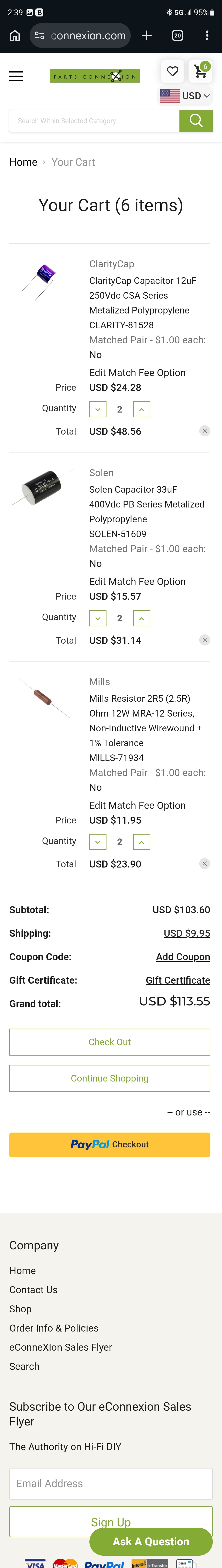

  • Grabber70Mach
    OK. Would this selection of capacitors and resistors be a better route to go?

  • Grabber70Mach
    @billbillw so you are suggesting these?

  • Grabber70Mach
    Grabber70Mach Posts: 73
    edited March 12
    So this is the way I'm thinking might be the best way for me to rebuild these.
    I'm looking at these components for rebuilding the crossovers. Also ordering some hurricane nuts and speaker cloth. Hopefully the one item will be in stock soon and I won't get impatient. 😆

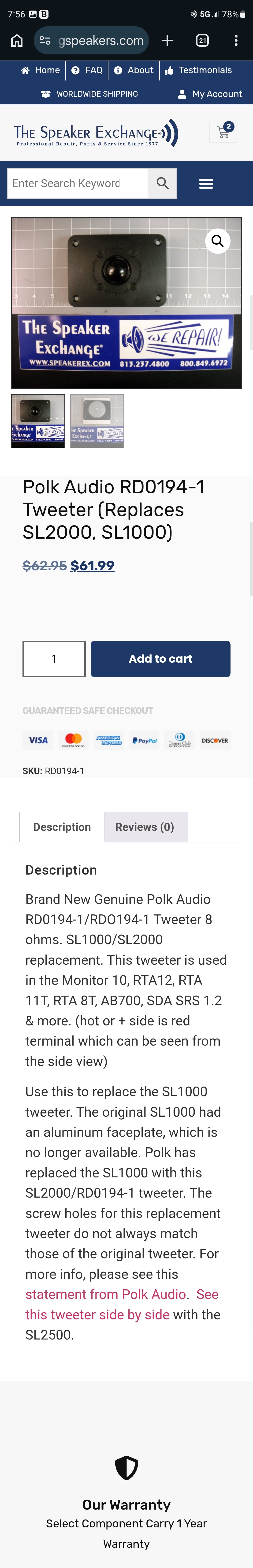

    I'm going to call Polk back on a price for the RD0194-1 tweeters. If they cannot do better I'll probably just order from the Speaker exchange for 61.99 each.
    Unless someone here has some they are looking to sale.
