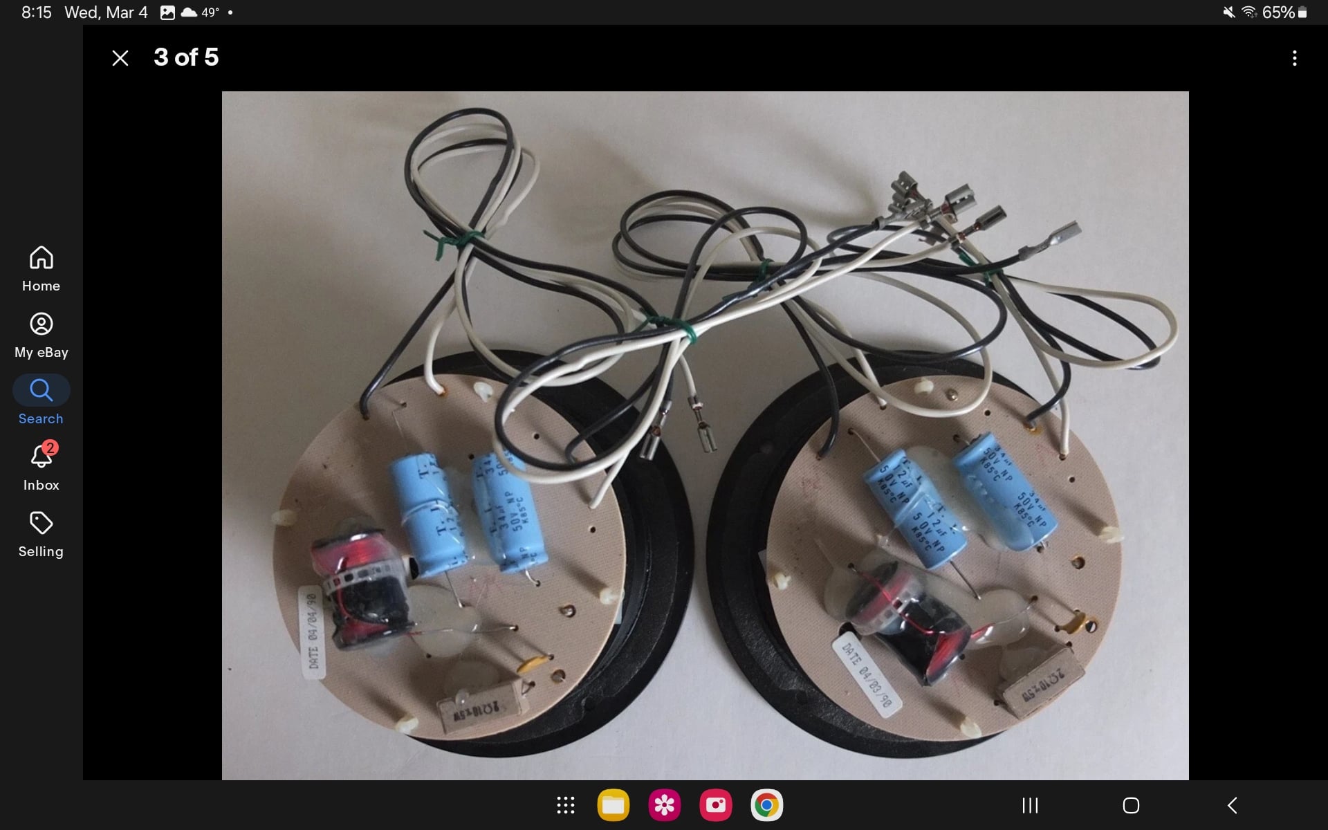

  • Thank you for the identification. I'm thinking about rebuilding the crossovers. Is it better to rebuild the original ones or would it be alright to purchase these and rebuild them then just swap them out?rnjt4upqxl5m.jpg
    pitdogg2 Posts: 27,310
    So does it make sense to buy another crossover to just rebuild with better caps? Seems like a waste of good dollars that could be better spent on quality caps and resistors.

    I purchased a spare pair of crossovers so I could take my time and still play my speakers. I prefer that 2nd configuration of PCB to the one you have. If you got that one I'd upgrade it instead of the one you currently have.

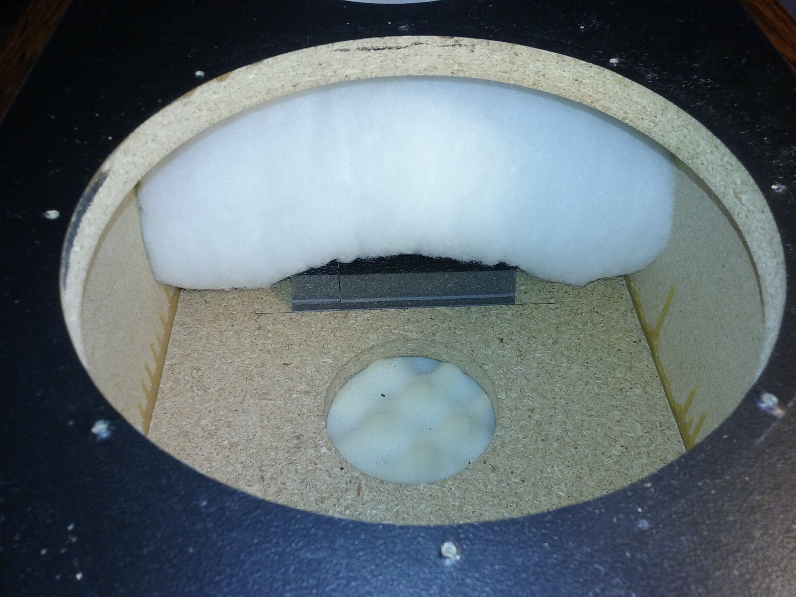

    We don't want to forget the backwave/standing wave absorption behind the midwoofer. I did a 6" x 6" square of Blackhole5 in my 7Bs. If I had to do it again I would try NoRez that doesn't have the floating layer of vinyl with layer of closed cell underneath. Reason being what if Danny Ritchie is correct that BH5 can mass load the cone. Also, I would orient it diagonally to the enclosure, although you'd have to notch out for the dowel mentioned above.

    I'm just saying that instead of the way I oriented it here, I would rotate it 45 deg, so that the points face up and down and right and left. Note mine is missing a corner not on purpose but because I was limited by the material a forum member donated to me. You will have to decide what you think works best for you in the M5. In the 7B I would've done two dowels because the baffle is wider and they would clear the corners of the BH5/No Rez just fine with the diagonal orientation. I don't know where the XO plate on the back is located in the M5.

    I received the crossovers that I plan on rebuilding yesterday.

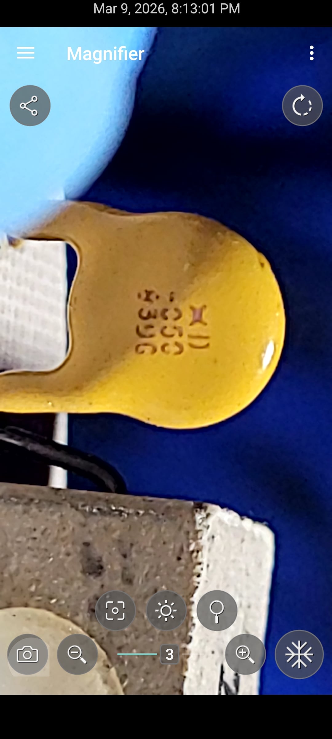

    I can make out the values on the resistor and two capacitors. But the small yellow device, maybe capacitor? I cannot really make out what its value is. m9dc98yruv06.jpg

    That's the "polyswitch" that you will want to replace with an appropriate sized resistor of the same quality as the other ones you may be replacing. Polk went with polyswitches instead of fuses at some point, to protect the tweeter. They get more and more troublesome the more times they have been tripped. Everyone does away with them when they upgrade XO but you have to adjust for their resistance. Different value reistors have been used by different people and I don't really know what the best value is. DarqueKnight did a thread on this.

    Initial trip resistance 0.5 to 0.77 Ohms. One hour post trip resistance 1.17 Ohms. Those are the specs. I think at some point Polk started pre-tripping them. Maybe you want 1 Ohms to replace it. Others will advise.

    The resistance of the polyswitch is a half ohm, we all used .5ohm 10 or 12 watt vishay-mills resistor in place of the polyswitch.

    If you're going with 194's, I'd just jumper the polyswitch until you get a good listening session on them.
    If you install billet RDO plates later on the 194's you may want to add the 0.5 ohms. JAT
